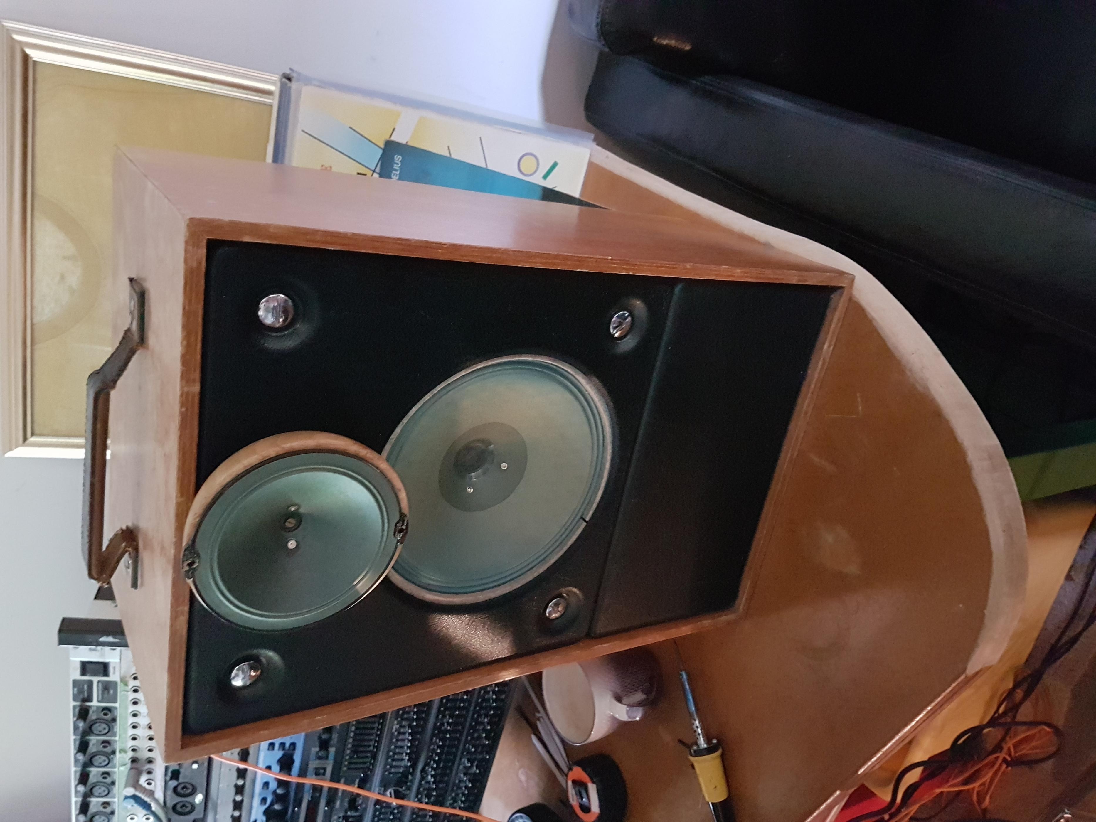

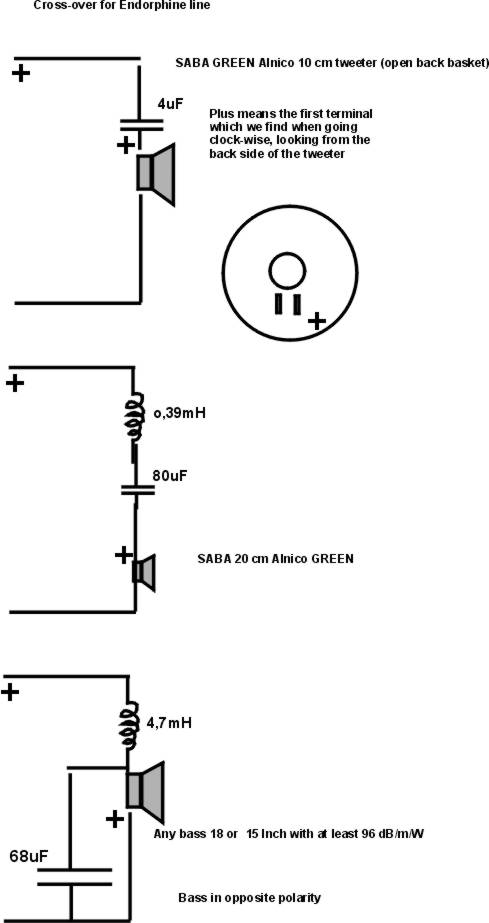

I'm trying my first speaker build as a variation of the lampizator Project 12. A variation based on my studio space and available materials.
The original OB design worries me as I have less than .5m space available behind the speakers, backing onto a big window (with a view that I'd like to keep!!)
I picked up a pair of Kef Ref 103 boxes with damaged tweeters for £25 and have mounted the the Saba tweeters and woofers neatly. (see pics) They have quite a wide baffle and will fit (just).
Also, I've repaired the B200's from the kefs and would like to upcycle these as subs, stacked as a three way.
I'd like to know if this set up is potentially problematic. Particularly the greencones in a cab like this.
And I would greatly appreciate any recommended crossover starting points. Taking in mind the original project specs from lampizator and the fact that I'm on a tight budget.
Many thanks.

OK good. So to achieve this, would you recommend starting with a software measurement app like Tolvan Data , or an actual acoustic measurement in the room with a "test" crossover set up (cheap components) until I get the right balance? Is there any free and simple to use software to help me measure the sound in the room? Ideally I want them fairly flat, but detailed. I know there is a mass of information out there, but much of it seems conflicting.
If you want a flat frequency response then you need to measure the individual drivers in the enclosure (frequency and impedance) and then use something like XSim to simulate a crossover.
Doing it the Lampizator way with random components will give you sound but you'd have about as much chance of winning the lottery as you would getting a flat response and good phase tracking. Some music will sound great, other stuff will sound bad. To justify their efforts, most people blame the recordings.
This thread should give you a basic understanding of how to design a crossover - LINK
Troels Gravesen (well respected speaker designer) has measured the frequency response of the Lampizator speakers HERE

TBH, it would never occur to me to use some KEF Reference 103 cabs for a greencones project. Measure till you are blue in the face, it's still a terrible idea.
Troels Gravesen tells me everything I need to know about greencones: Greencones
Your project bears no resemblance whatsoever to the Lampizator Project 12, whatever its supposed virtues: opoen baffle alnico speakers project 12
Abandon this straight away! Any virtues of the Lampizator project come from the open baffle. And I saw enough in Troels' investigations to know that the crossover is seriously difficult for anything apart from a Kabuki speaker.

Before we go, we should chew the last bits off these old bones. 😀
This greencones crossover...
I think Troels tried a first order cap on the greencones tweeter in his investigations. It didn't do much except add a bit of cone tweeter tizz at the top end.
For all that, there is the germ of a good idea there. The late Siegfried Linkwitz and our own John Kreskovsky find some merit in well implemented open baffles. Below, attached.

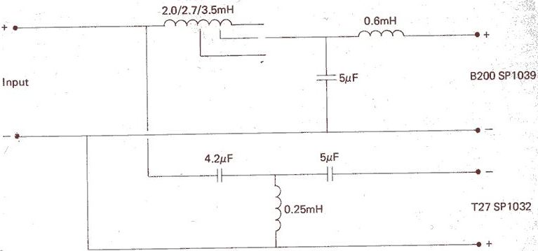

Here's a start to fixing the KEF 8" plus 1.5" original.
Whatever is that filter? My best guess below, though the reference 103 is obviously using bit of tweeter attenuation with the green resistor, because big 1.5" tweeters are loud. Shouldn't be hard to modify that for any tweeter you like. I could have a go with the cheapie but goodie Monacor HT22/8.

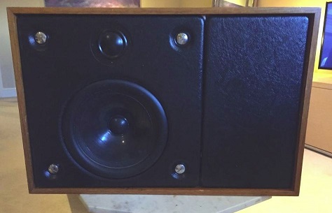

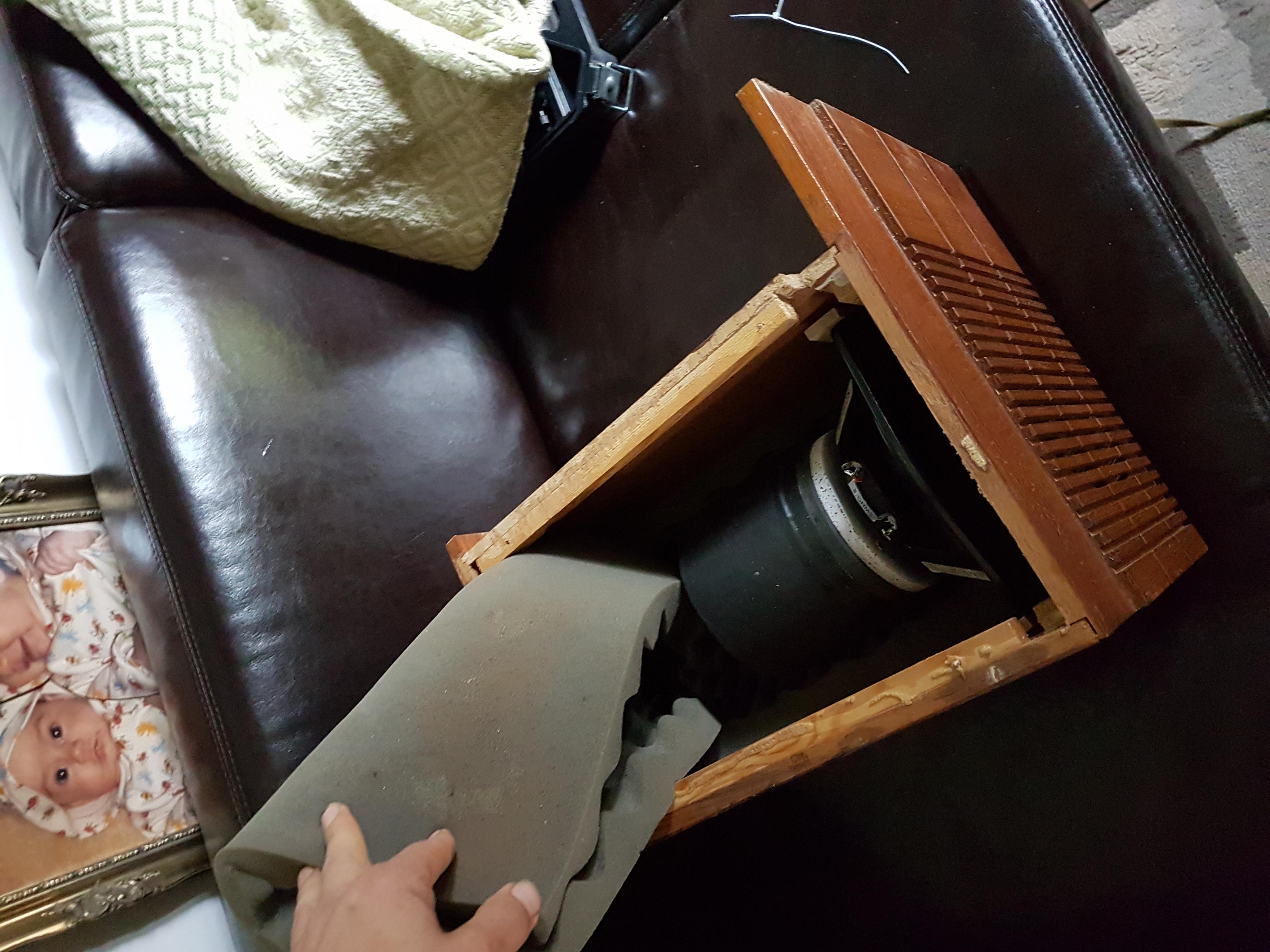

Yes, lots to be learned by getting these singing again.
The bass drivers have taken a hammering with a few holes in both cones (a child I suspect), which I've had repaired by a friend who used a bit of heat shrink plastic under the cone.
The tweeters have rips (yes both). BUT they still sound pretty good. A bit harsh in the upper freq maybe.
The tweeter is a T52 (SP1049). Can't find any info on a replacement. Neither on the crossover SP1050..?

What you have is a take on the updated Graham Audio LS5/9:

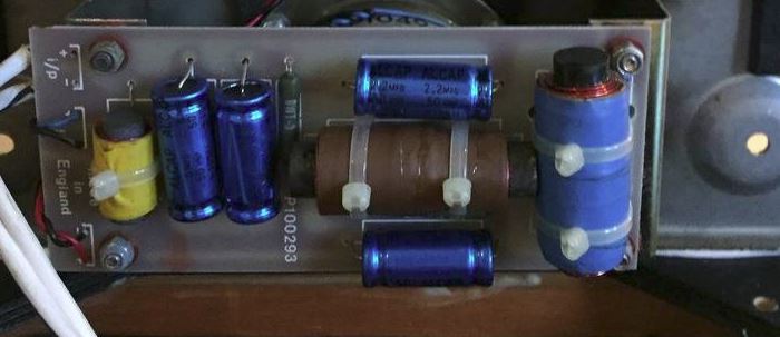

It's up to you to look at the crossover. Some capacitor and resistor values would help if you can't measure coils.
I am supposing the filter is not wildly different from the KEF 104:
