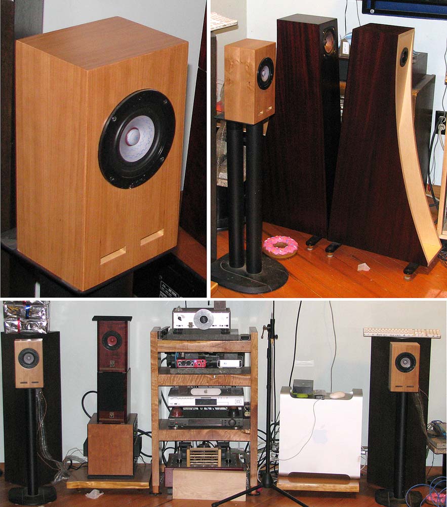

A lot of sand in these:
The sand does a good job of damping and makes the box a bit more immune to moving due to reactive forces.

I like those, care to share more about these speakers? Drivers, design, plans?A lot of sand in these:
dave
Old design for FE167. Given it is a big standpoint with sides that reach the floor, any standmount could be morphed into similar.
This one has a helper woofer instead of sand.
dave
