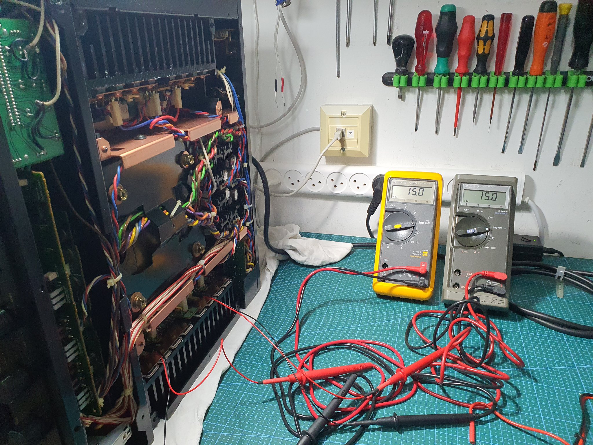

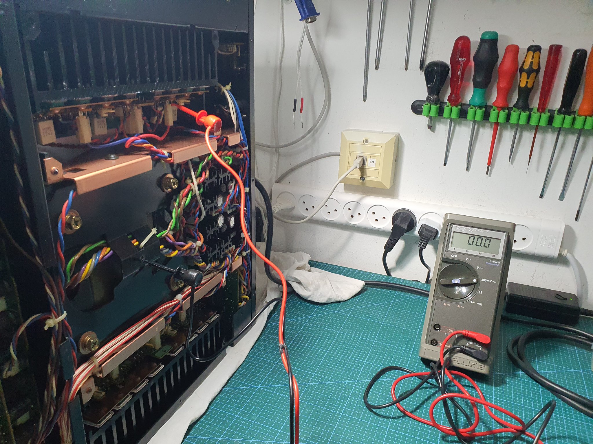

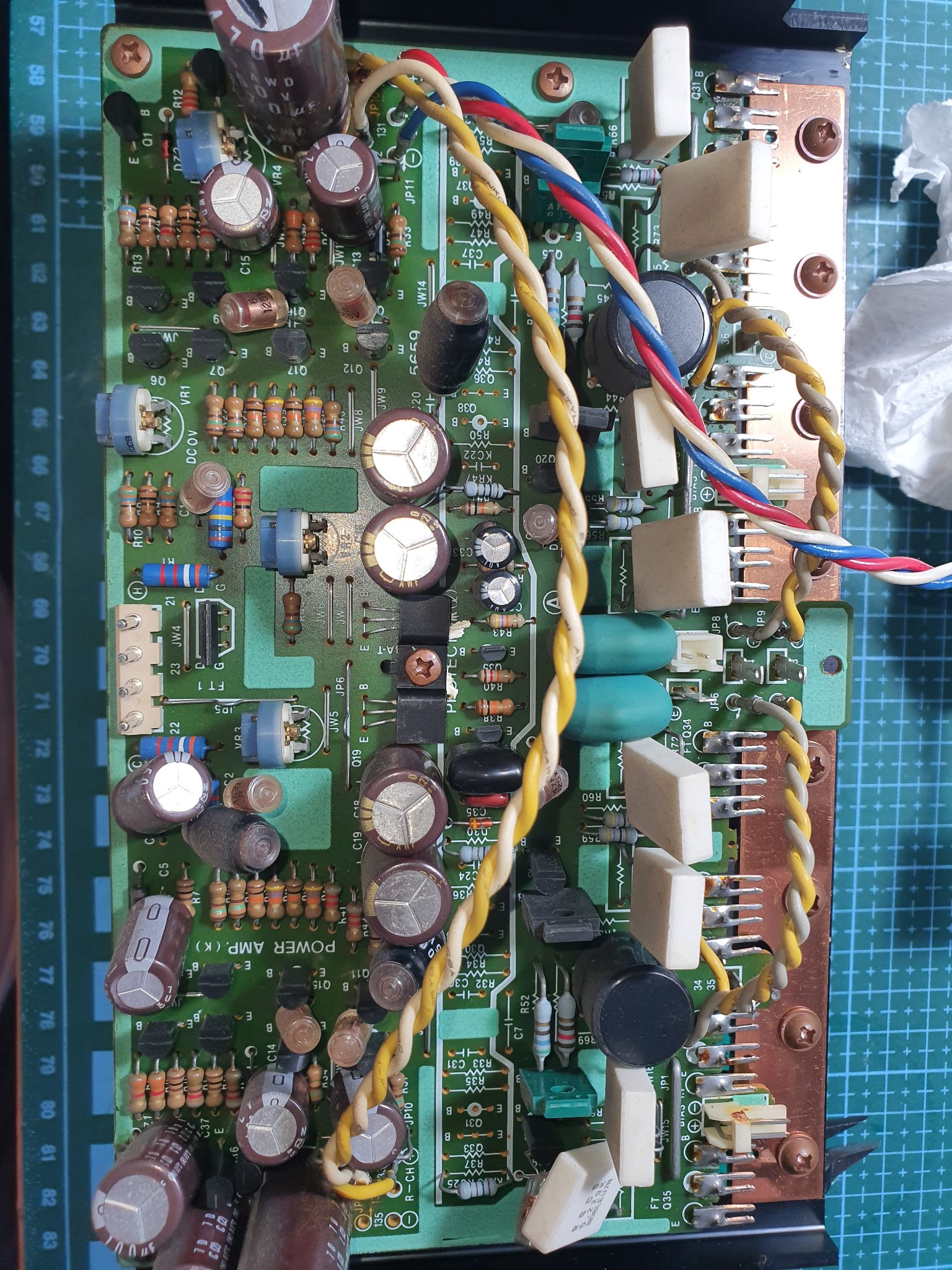

Hello, I have Sansui Alpha AU-907i MOS Limited that sometimes lose the right channel at low volume, when I increase the volume the right channel becomes alive also after 1 or 2 hours the problem disappeared. I changed all the electronics capacitors to good ones Nichicon MUSE KZ Series (the original was Nippon) I adjust bias to 15mV and set the DC 0V to 0V on both channels and the problem presist as before. The same problem as before. The only thing that I did on changing the capacitors is putting the 47uf 100V instead of 50V also the radiator of rights channel is much hotter than the left. Please help. Thank you.

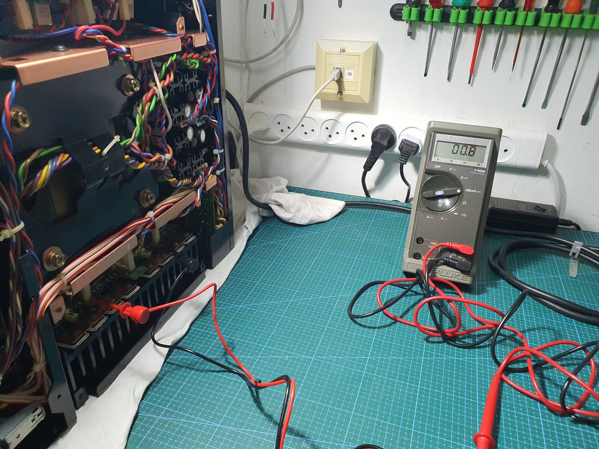

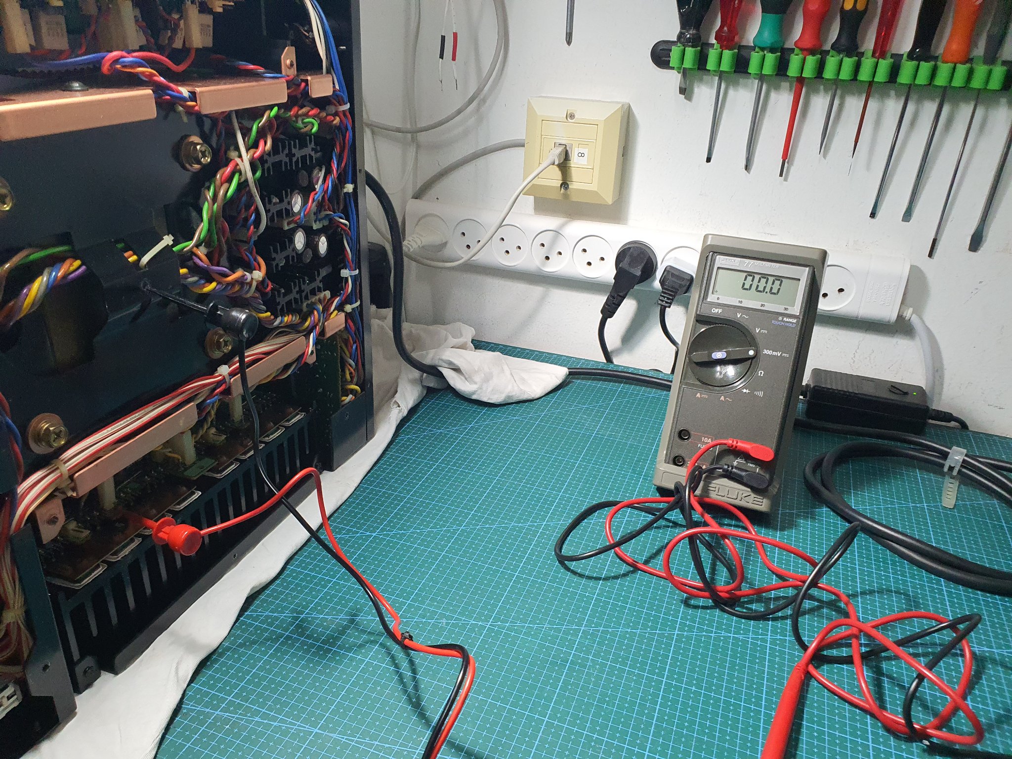

Yes of course all the transistors are mounted on the heatsink with mica between them and thermal compound. How much voltage should be there? Because I've already adjusted the bias voltage to 15mV (should be 8.8mV I increased it to that level) hot and cold on both channels.
Yes. Those Alpha series amps have hot and cold. I don't have the service manual to know the values. All the small transistor doesn't came with heatsink except the two ones in the middle. Any idea how can I test it to see if it's the amp section or the preamp? There's direct input that the tone and balance control doesn't effect. I think it's direct input without the preamp.

Just wanted to note that both comments in #10 can be correct/appropriate--- an intermittent channel could still have an independent bias defect.
Wild guesses: are there Zobel networks? Are their components functional? Are the Zobel resistors hot? I suggest a 'scope to check for possible oscillation.

Hi, thank you very much. I will check the relay and the voltage across the bias resistor. What should be the voltage across the resistors? and should I put the two leads of the meter across the two resistor legs or one lead on one resistor leg and the other refer to the ground? What is Zobel network or resistors? For the bias settings on the service manual that mbz (#11) shared (Thank you for that) the bias should be 26mV. The manual is in Japanese (thanks God that the numbers are international 🙂) Maybe I should start from there and see what happens. Thanks for all the comments.
Across the resistor legs. First after turning on the amp, a second time after 1 hour or when it is warmed up.
