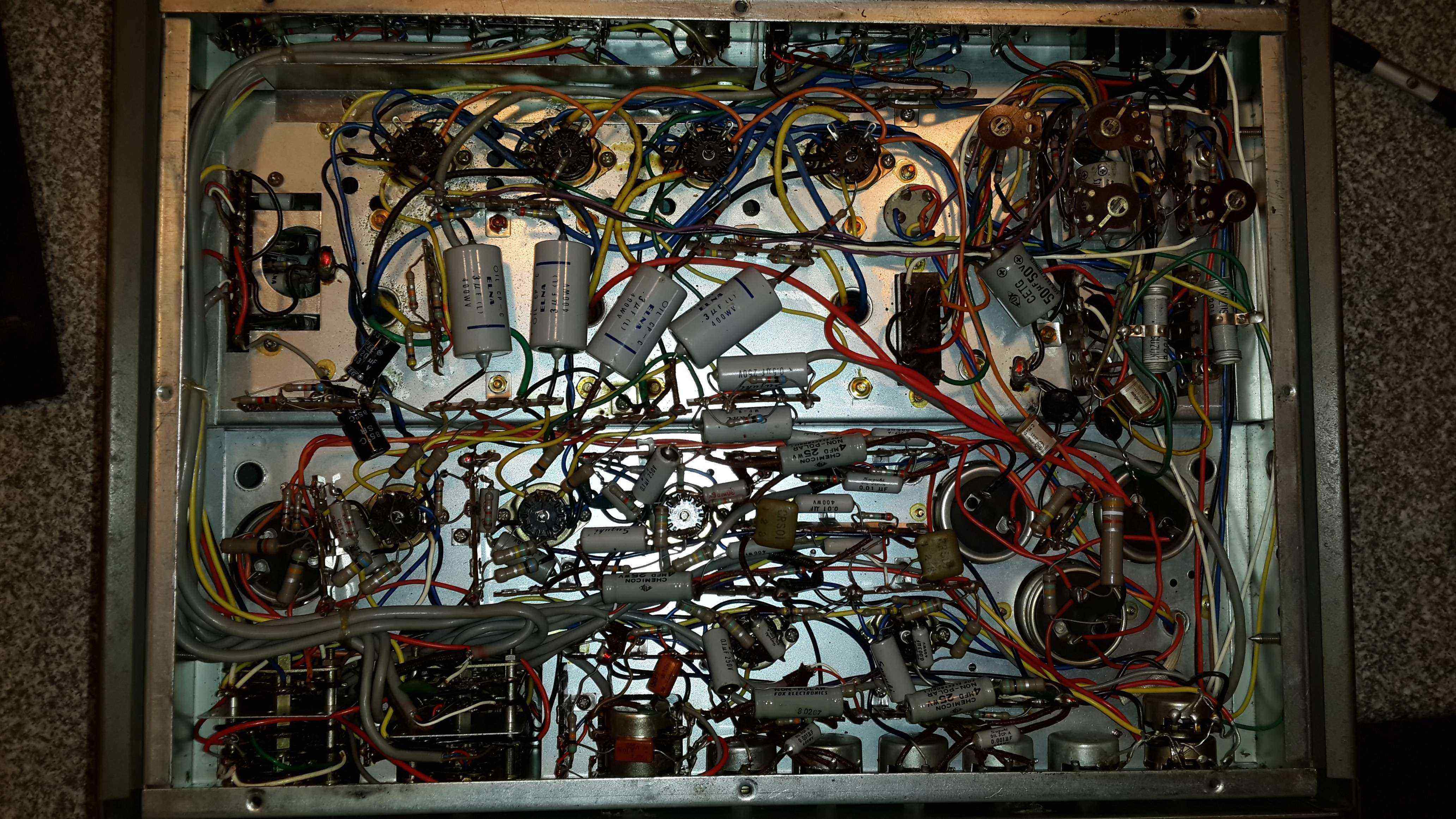

Hi Guys
Thanks for all the replies. I agree with everyone that everything will have to be checked and replaced. The problem is i can't find any professionals where I live (Cape Town, South Africa). I am new to "recapping" and this will be my first attempt. I had a look inside, and it looks like there might have been some work done.
Maybe one of you guys can have a look and tell me.
Thanks! 🙂
Thanks! 🙂
