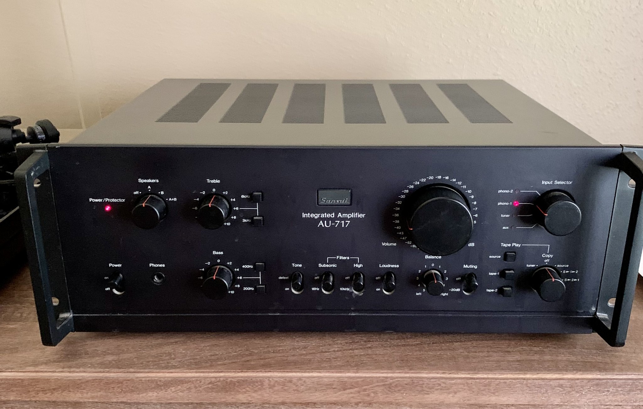

I have a Sansui AU-717 integrated that I bought new with paper route money in the mid-70’s (I’m 63 now). It’s in excellent condition and I still have the owners manual…wish I’d saved the box. The amp works perfectly but I suspect is overdue for caps/bias adjustment, cleaning, etc. The cover has never been off.
I do not have the knowledge or skill to attempt it myself. Looking for quality service recommendations ideally in the Atlanta area. I prefer not to ship it if possible. Appreciate any guidance.

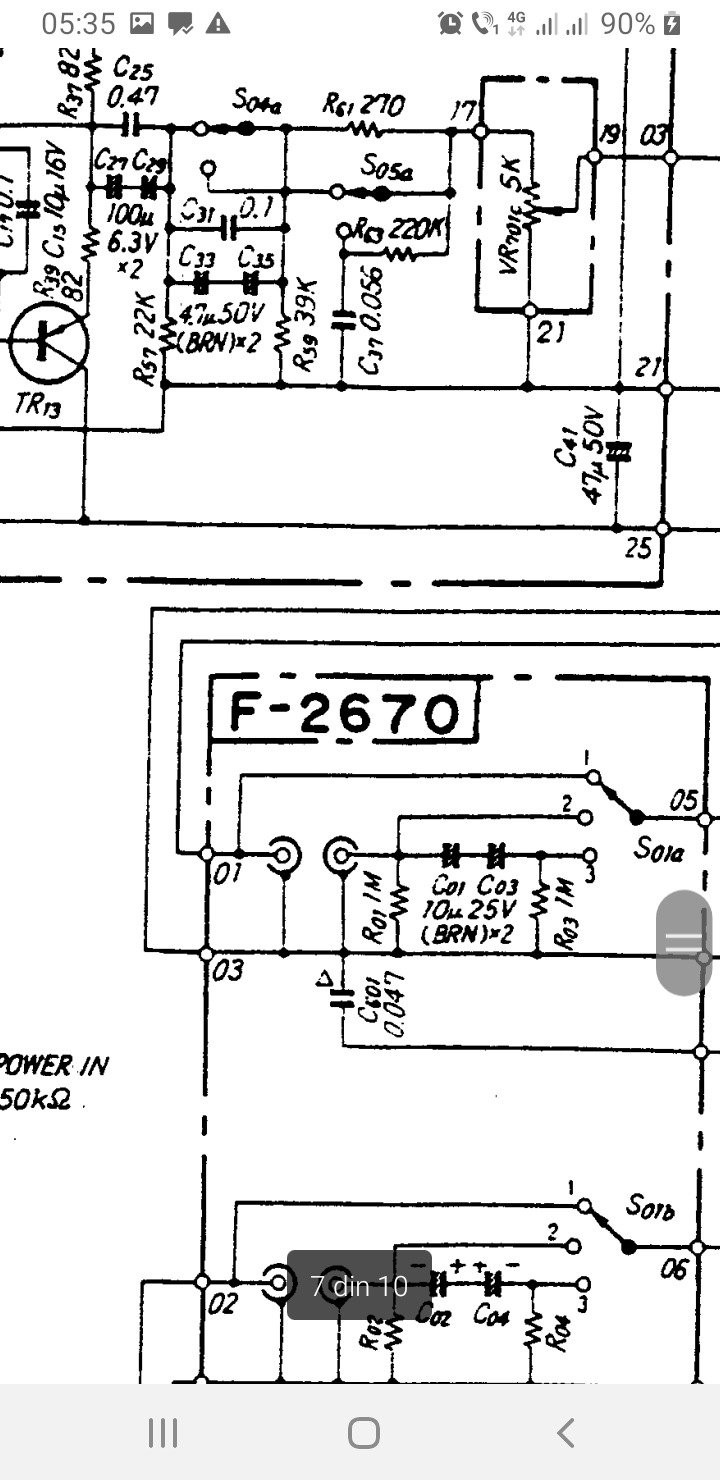

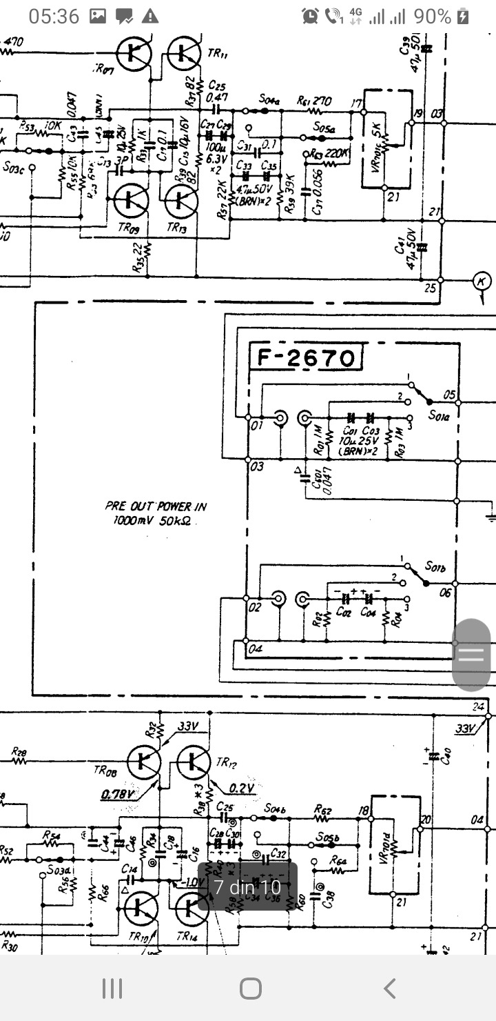

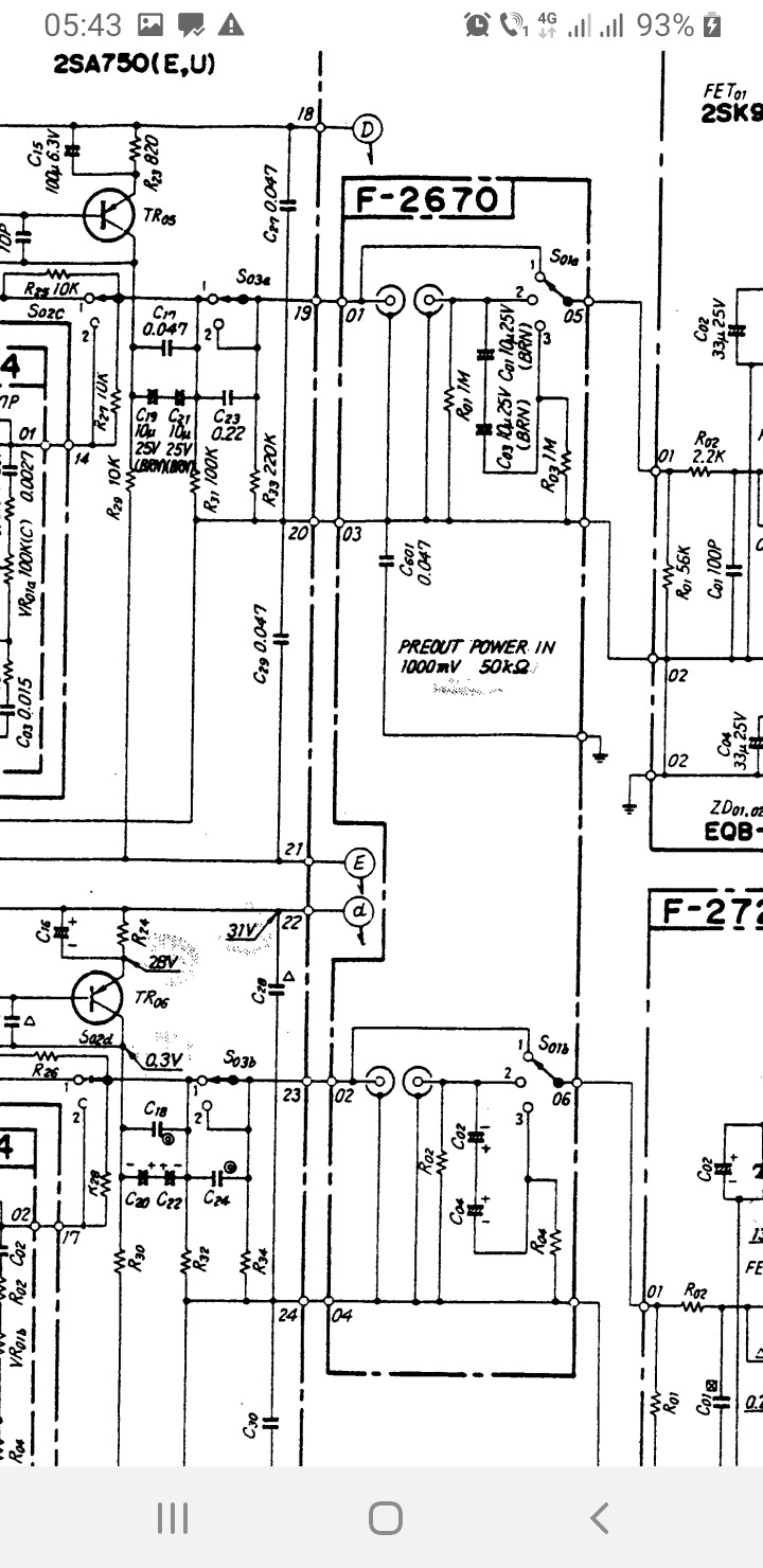

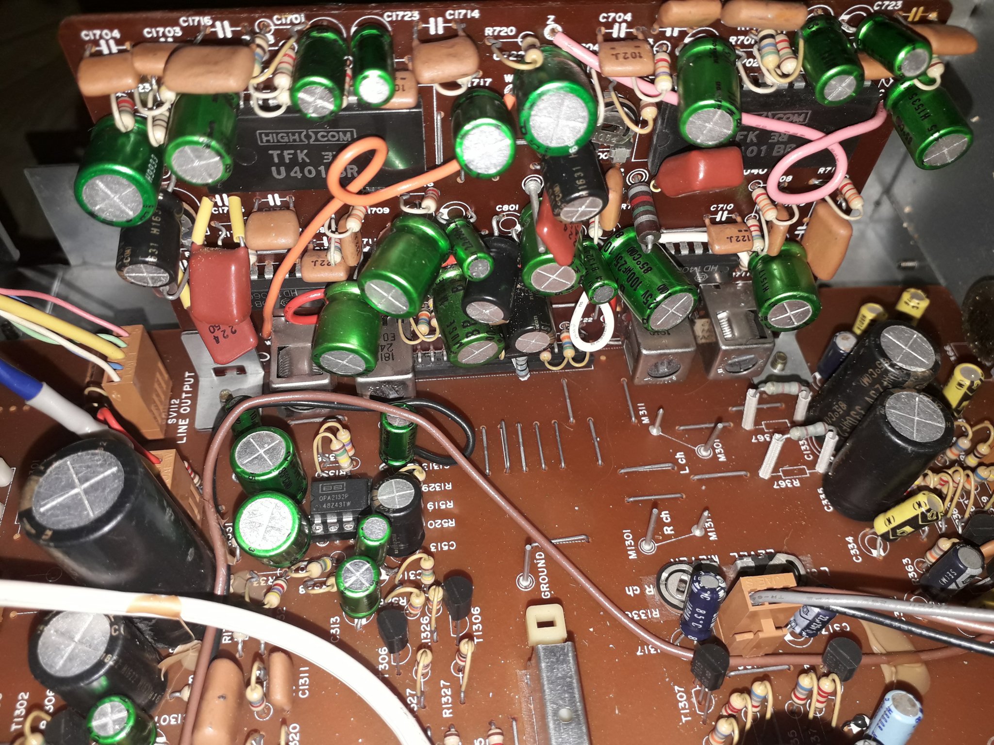

Assuming all the supply filtering and decoupling caps are ok as they do beneffit more of some formating current , you could consider changing the series coupling caps found in the signal path with the equivalent bipolar value from Nichicon muse(the metallic green ones) .For example, for two caps of 100uF/6.3v in series you'll use one bipolar capacitor of 47uF/16 or 25v... For two capacitors of 47uF/25V in series, you'd be using a single bipolar nichicon muse of 22uF/50V, for two csps of 10uF/25v you'll use one single bipolar capacitor of 4.7uF/50V and so on...half the value of each capacitor, double the voltage.Start with replacing only the electrolitic capacitors found in the signal path. Being two in series there's a great chance there's barely any dc current circulating through them, thus a greater chance of loosing their properties over time.They look like those in the picture attached:
