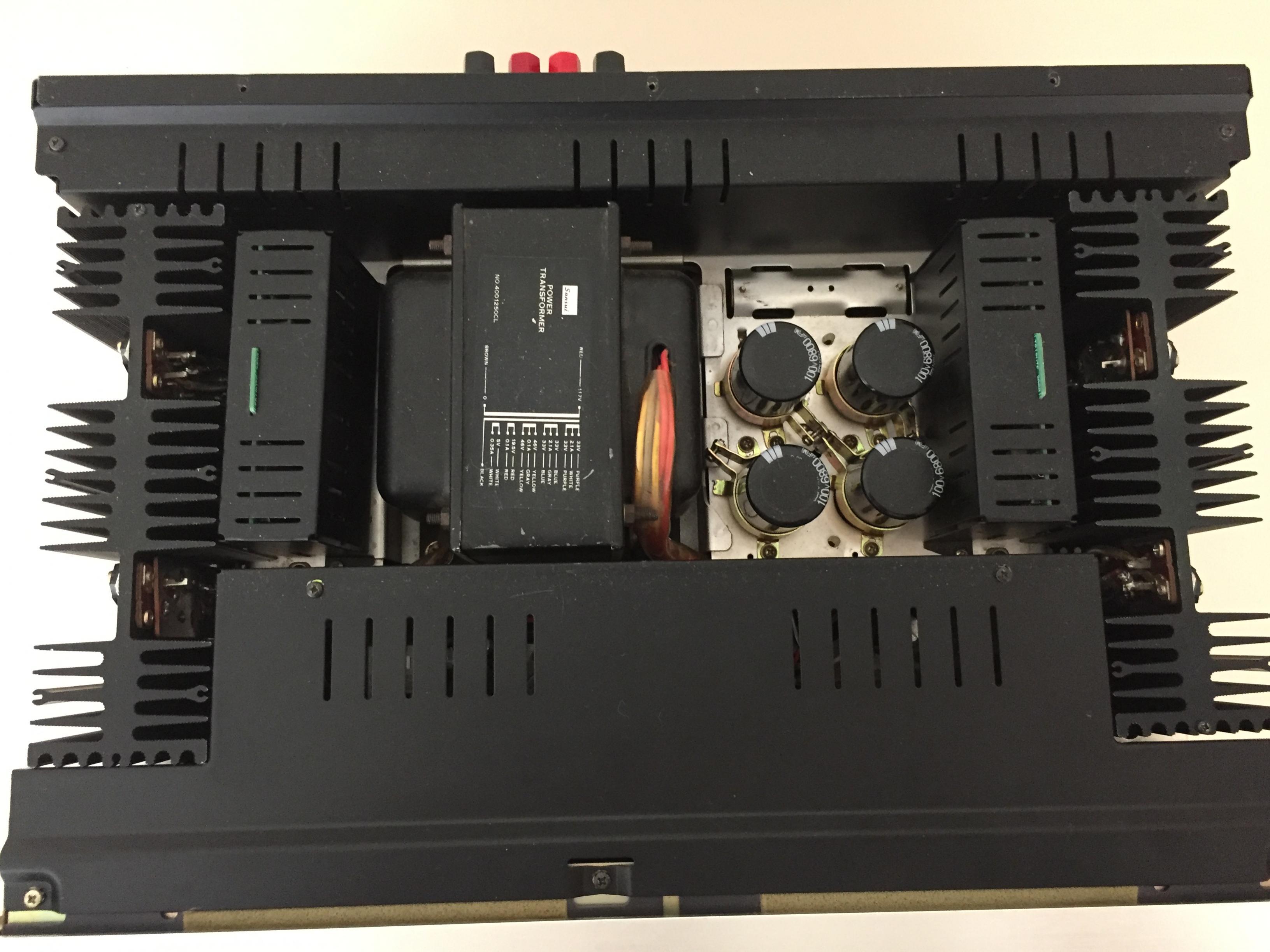

1/ Replaced all the electrolytic capacitors with modern equivalents. The only exception being
the electrolytic caps in the signal path. These have been replaced with film types.
2/ Replaced power supply filter capacitors.
3/ Replaced 5B4 rectifiers with modern 6A bridge rectifiers.

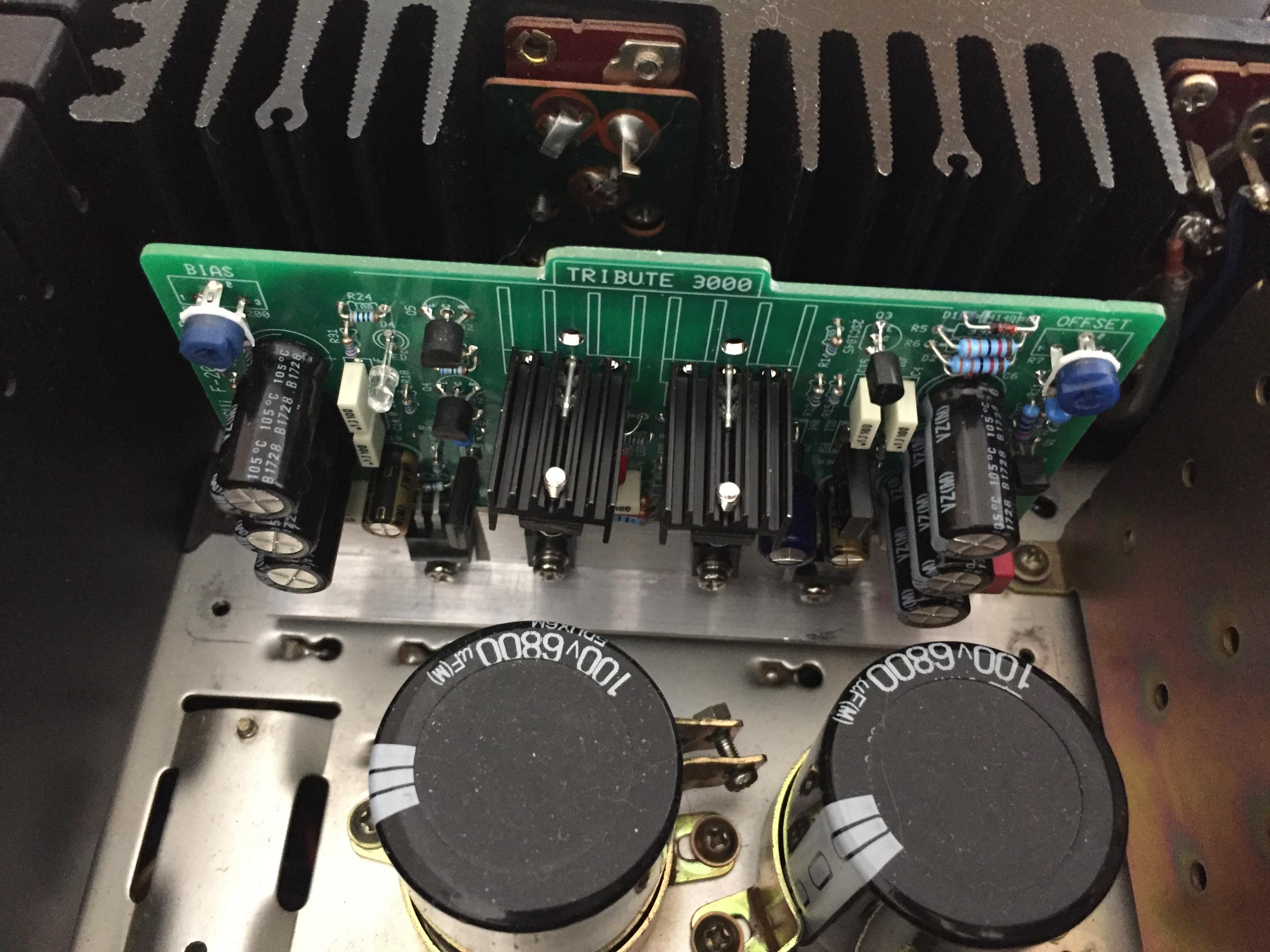

The amp worked well and sounded good. Then Valery posted a Driver board and OPS of a Sansui BA-3000 he had modified to achieve lower distortion and promote soft clipping. Article here Revisiting some "old" ideas from 1970's - IPS, OPS

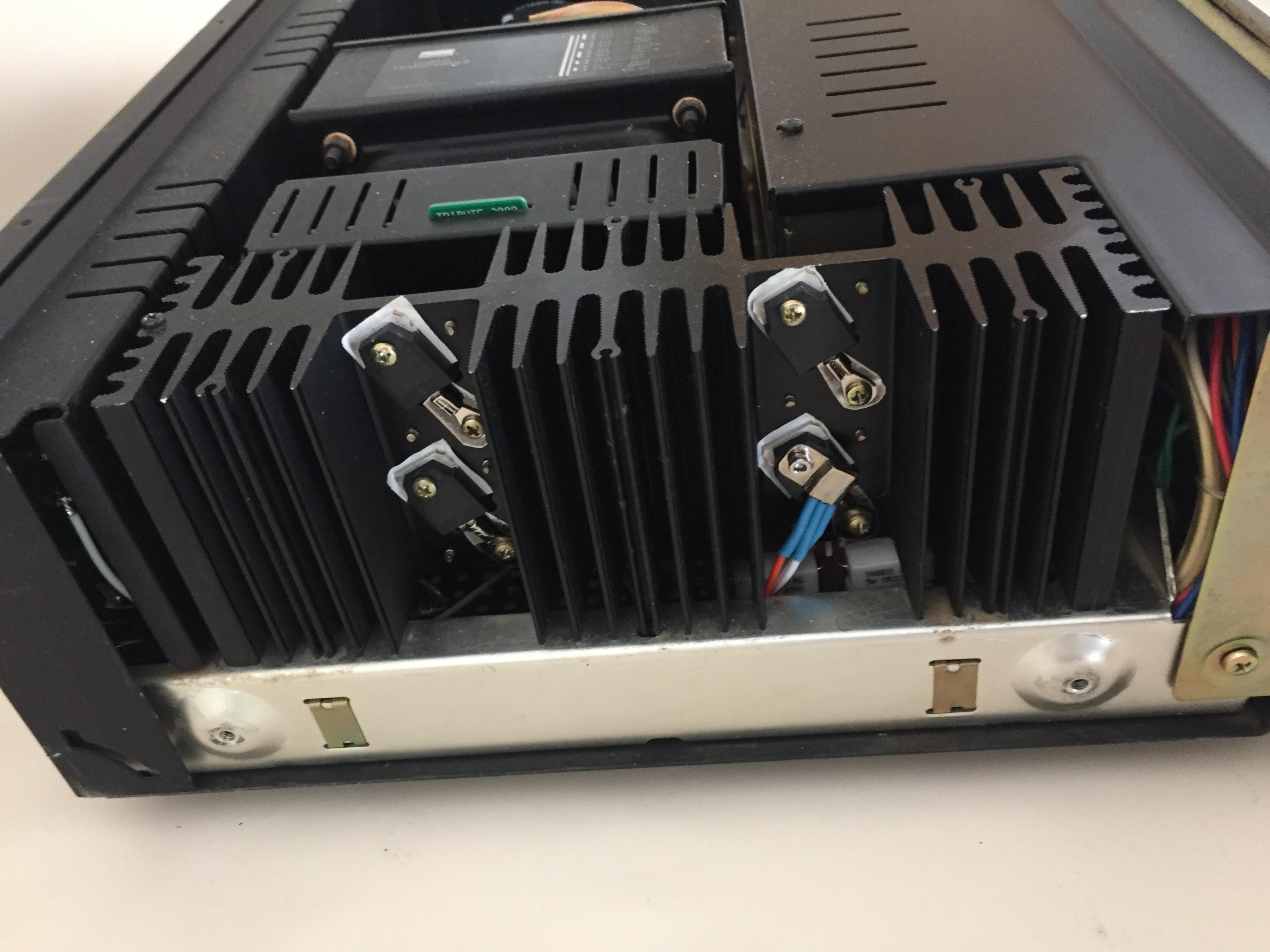

I put the driver board onto the 9500 Sansui “plug in” board and installed output transistors as in his design except 2 pairs instead of 3. Output power increased by 20W to 108W per channel. A few more changes were made but basically I was able to duplicate Valery’s circuit in the 9500. No major surgery in case I had to put it back, but no need, it sounds great. More modern but still with that Sansui character, what ever that is. Maybe it comes form the looks.🙂
