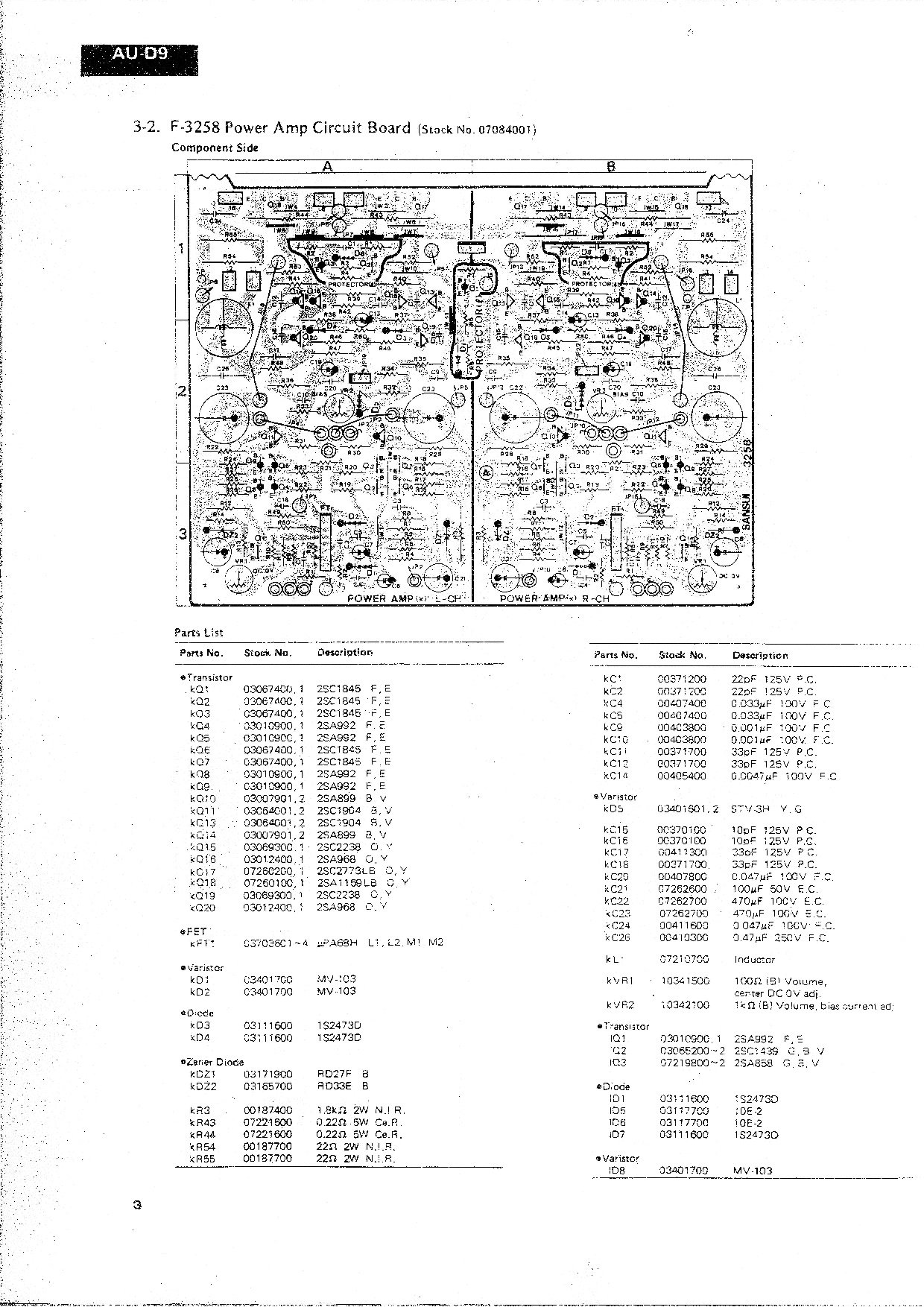

Is my attachment your amp?

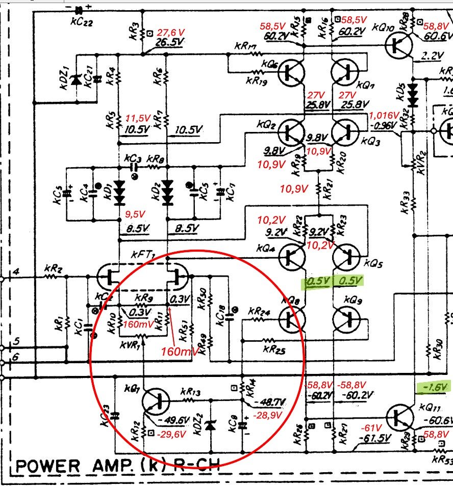

Why does your first post feature the jpg? Is there a problem in that area? Do the voltages in red correspond to your unit? I hope your amp presents with the voltages in black.

the jpg I attached refers to the measurements taken on the entire power board; the measurements in red are those that do not correspond, especially those inside the red circle;
the kDZ2 is a 33V zener diode, to have -49.6V that zener should be 11V, or am I doing something wrong?

I forgot to say, I don't have the 0.4V voltage at the emitter, and at the base of the finals I have 580mV rather than 600mV, all this by setting bias to 10mV and DC 0V
About 11V for the Zener seems about right. I'm trying to pick my way through the parts list, but can't find sensical results. Has that part been changed in earlier repair? Same situation in both channels?
Would you report all base and emitter voltages for the output transistors, as rayma suggested? (i.e. Q13 through Q20). It's hard to imagine how bias currents could be in accordance with SM, yet not pass sine wave signals.

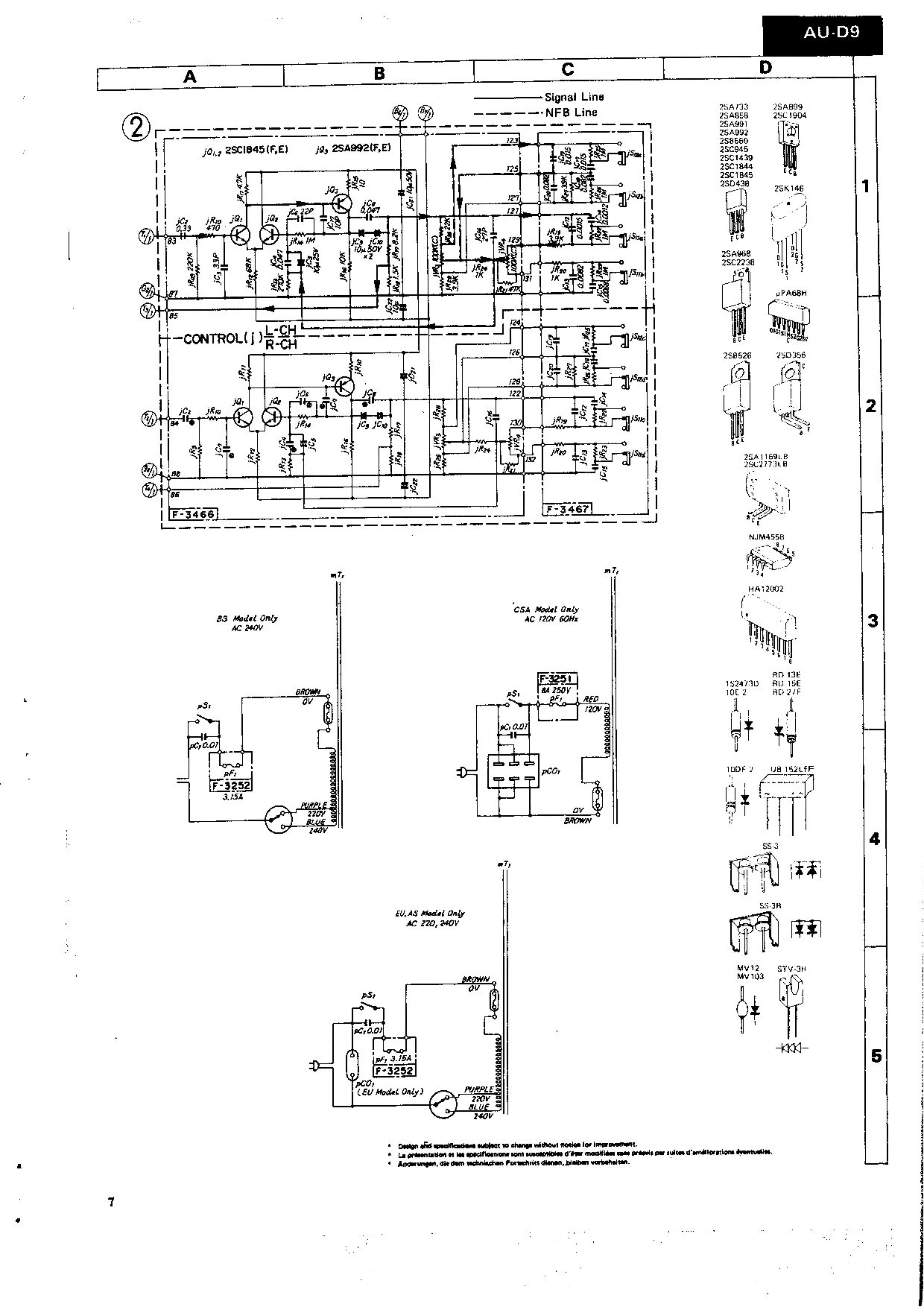

if you look at page 7 of the DM there are all the transistors and diodes used in the amplifier; as zener they are indicated 13-15-27V but not 33V as in reality; if you look at page 3 there is the list of materials used on the F3258 board and there the 33V zener is reported.

I sketched out the right channel output section and noted your noted measured voltages. (Left channel looked very similar.) All DC voltages looked reasonable, showing roughly 0.6V drop across each b-e junction.
I can't fathom how DC voltages can drop in reasonable fashion through the cascade of transistors (eg. Q13,Q15,Q17), and fail to simultaneously transfer the sine wave drive through each b-e junction.
I suggest using your scope to step through each stage, with scope set for DC coupling. Drive amp input with sine wave to deliver about 0.2V pk-pk at base of Q13. Your scope should show dropping DC voltage at each junction (base, then emitter) as you step in order from Q13, Q15, Q17 followed by emitter, then base of Q18, Q16, Q14. The sine wave should follow supper-imposed on the DC bias, with only minor drops in AC amplitude.
If you find anything at odds with this description, please describe. Please attach photos if helpful.

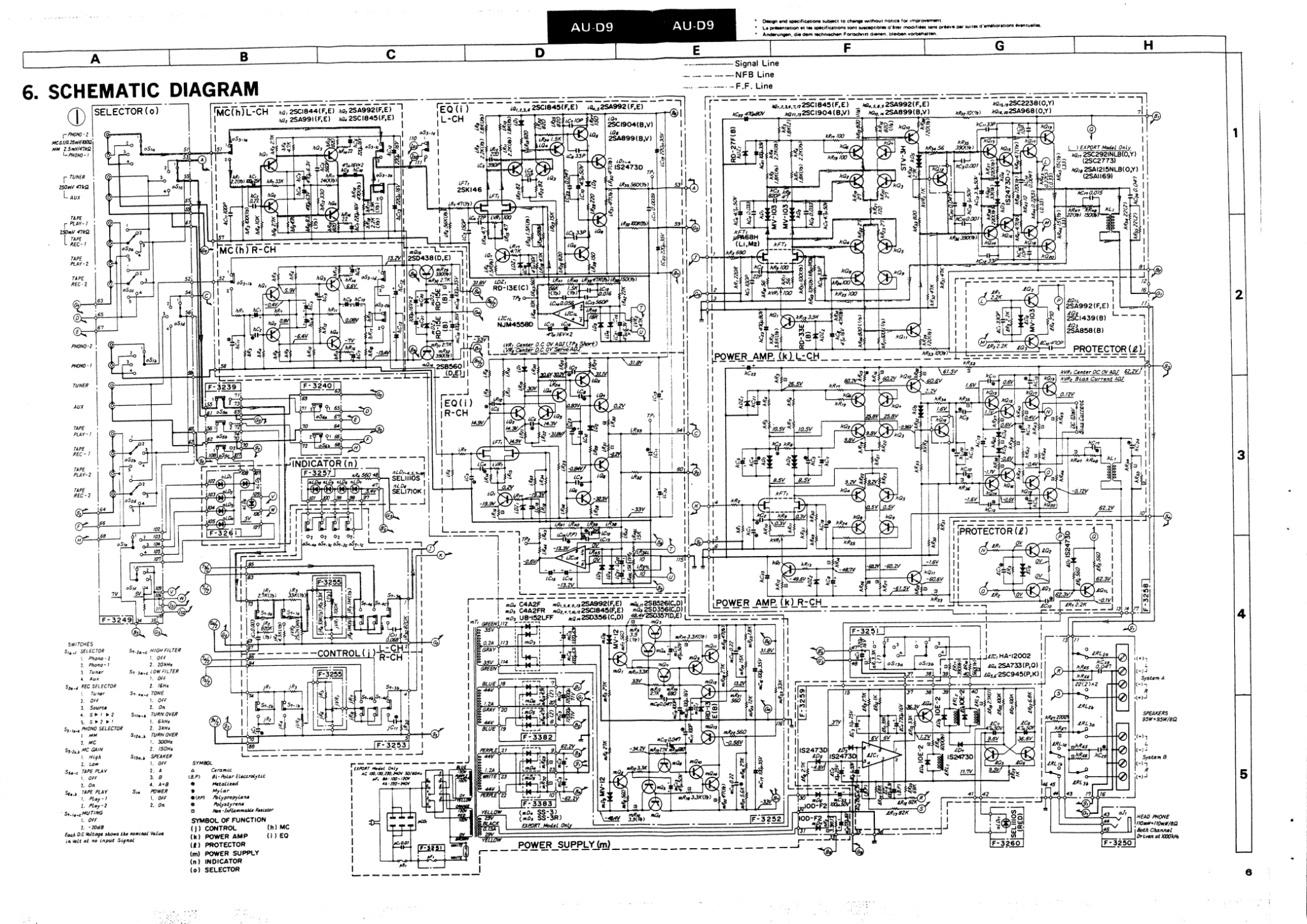

BTW, the SM that @rayma has contributed seems to show a 33V Zener, so perhaps that mystery is resolved.
