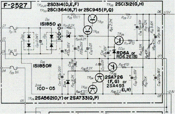

I am upgrading my Sansui TU 9900. There are two Sanyo D314E in the power section. I believe they are regulators or diodes. Anyone know a replacement? I can't seem to find info.
Also I want to replcace transistors C1312, A776 and C945. Any ideas?

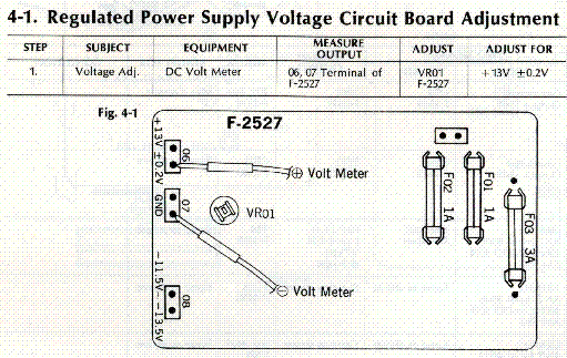

Thank you! The 07 to 06 posts reading was good and I adjusted it to 13V.
But the 07 to 08 posts only read .8V. It's supposed to be -11.5 to -13.V. I'm thinking the D314E is bad on that side but don't really know how to test it. I tried the diode reading on my multi meter and one way is "over limit" where as the good side one reads 1.26 V. Both read .566V the other way. Do you have suggestions for replacement if it's bad??

On the schematic, you find parts marked TR, D, R and C
TR stands for transistor so TR01,02 stands for Transistor 01 and 02, in this case both 2SD314E. You recognize the abbreviate code D314E.
Transistors usually have three pins, Emitter, Base and Collector.
--| is base, pin with arrow is emitter, pin without arrow is collector.
In most circuits we find Positive nPn and Negative pNp transistors.
You can recognize them with the arrow, when it points outwards, the transistor is positive.
D stands for Diode, R for resistor and C for Capacitor.
Diodes have two pins, Anode and Cathode. --| is Cathode.
Resistors have no polarity and some capacitors like electrolytes have + and – as seen on most of them in the schematic.
Every time we measure voltage in this particular circuit we’ll do that with respect to ground which is pin 07 so your meters negative should stay connected to that pin.
All parts above the ground line serve the positive (+13V) part, all parts below the line are there to produce and regulate the negative voltage.
According to this, you should start looking at parts TR02, TR04 and TR06.
Here are some important values:
TR02:
B: -22.4V
E: -23V
C: screw of transistor: -13.4V
TR04:
B: -14V
TR06:
B: -0.6V
C: -14V
D04:
C: -18.8V

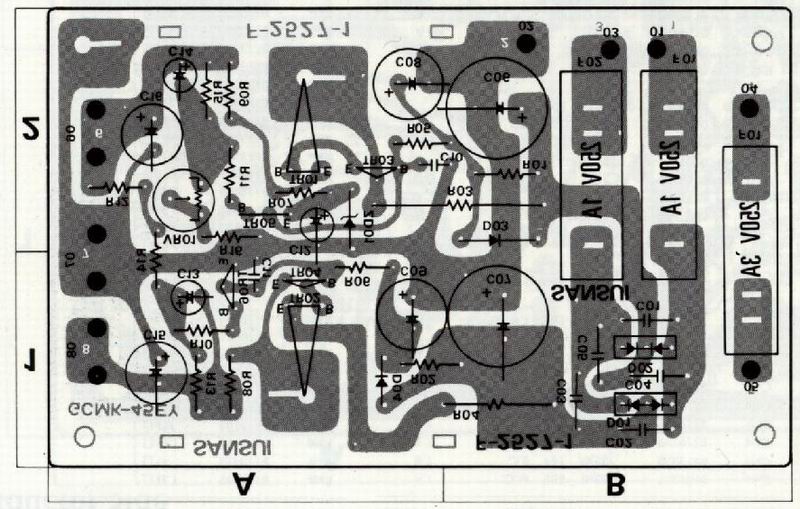

I’ve included the (flipped) layout for easy recognition of parts.
/Hugo
