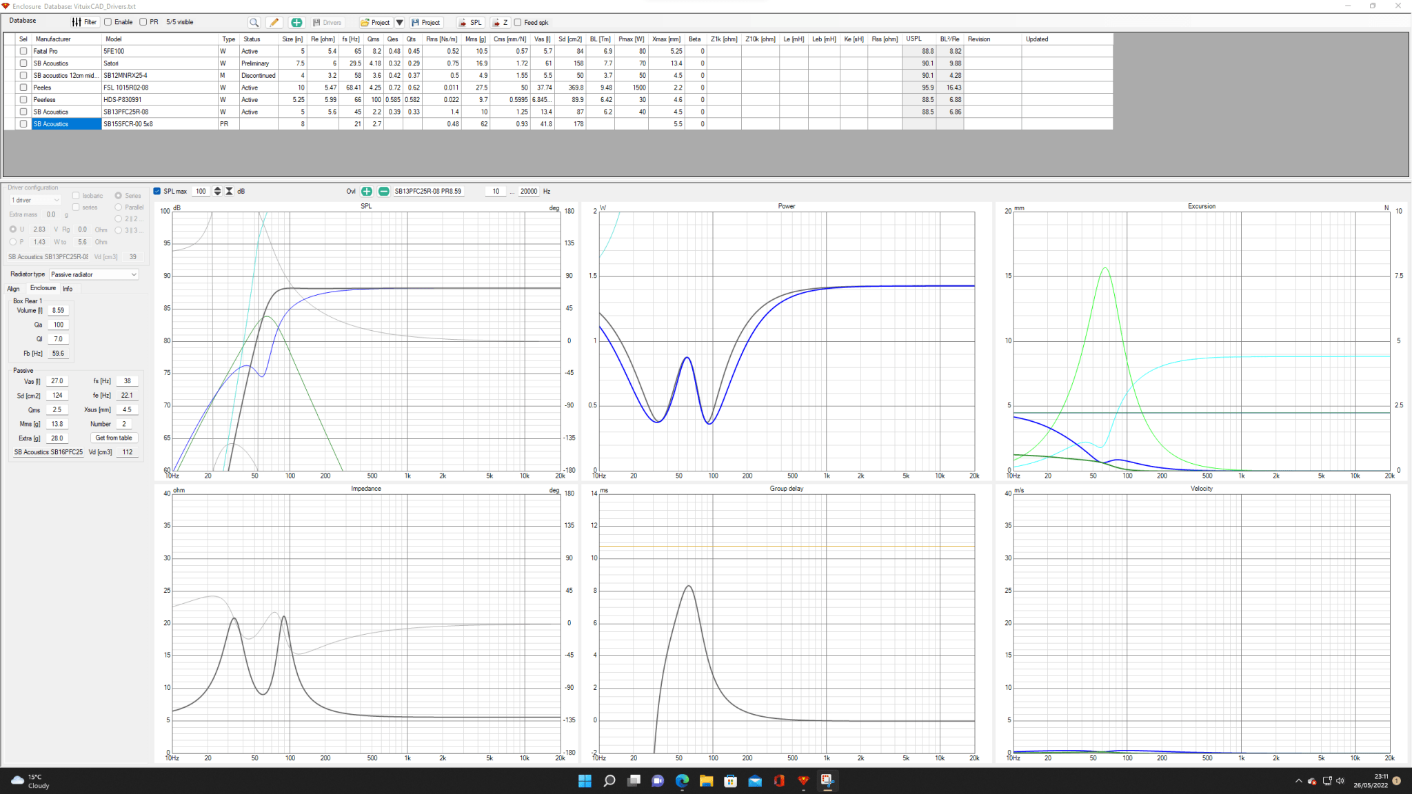

Vituixcad allows you to select a passive woofer, not sure it allows multiples.

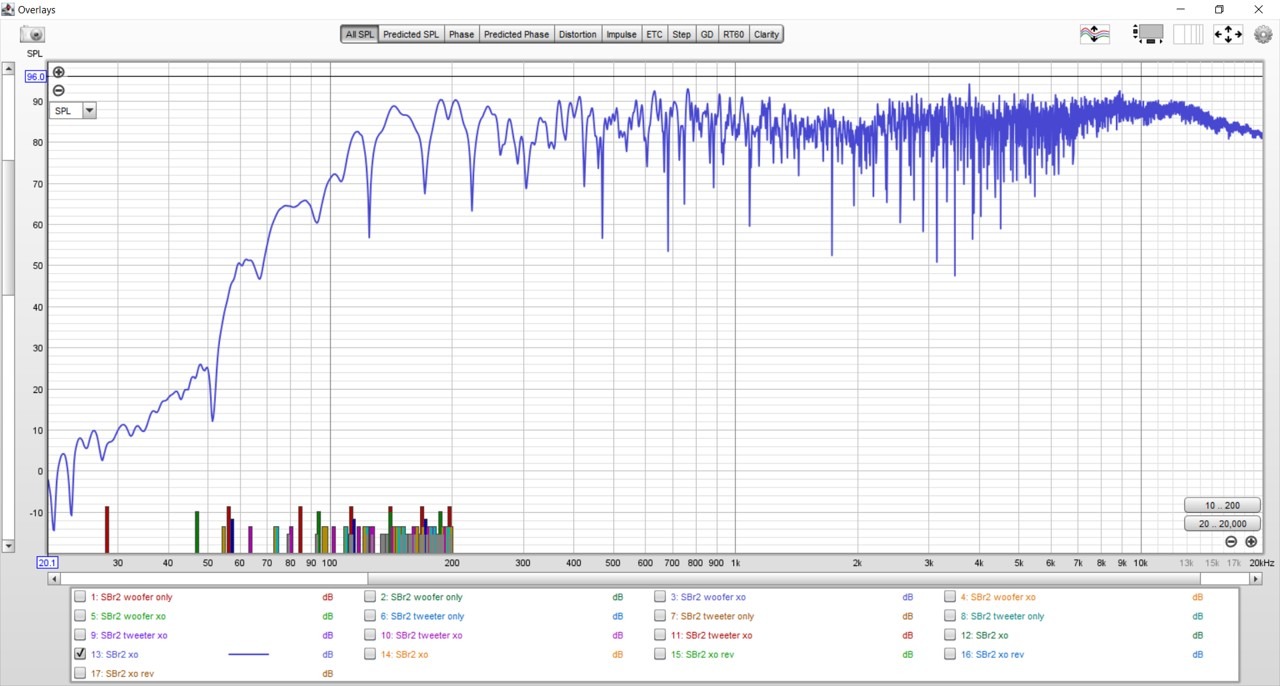

What does the unwindowed frequency response look like, could you also post that?

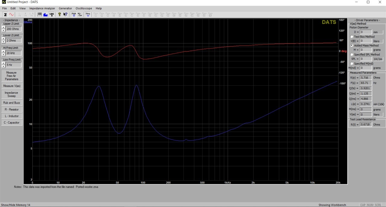

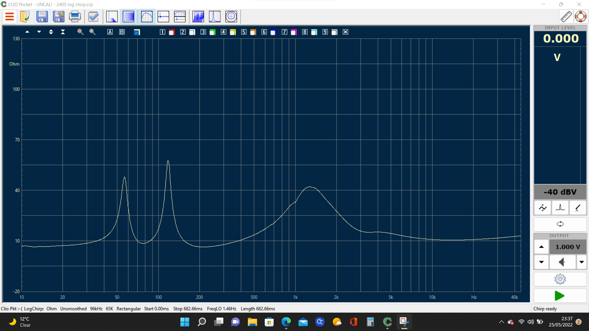

Hmm, the frequency response for the bass doesnt look like the you have passive radiators contributing a lot.
I am making assumptions here but maybe the midbass on its own reflex tuned may give more. bass?
Typically in a reflex you would expect a symmetrical U shape, with the bottom of the U showing where you you have good damping, indicating control over that frequency range. A wide bottomed U would be good damping and good power handling, in terms of limiting driver excursion in that range. Unfortunately I haven't a clue regarding how reflex and Passive radiator map against each other. I learn by experiments, and I haven't done this yet.
Looking at your frequency response and ignoring the bass end I would probably increase the inductor value at least 1 or two more steps and see if that doesn't help with the perception of bass. Naturally you may have to do the tweeter Xover to adjust to the new values and keep your null and aim for a gently downward shape.

I have attached a reflex impedance for another 5" driver as an example for a reflex tune that sound good to me.

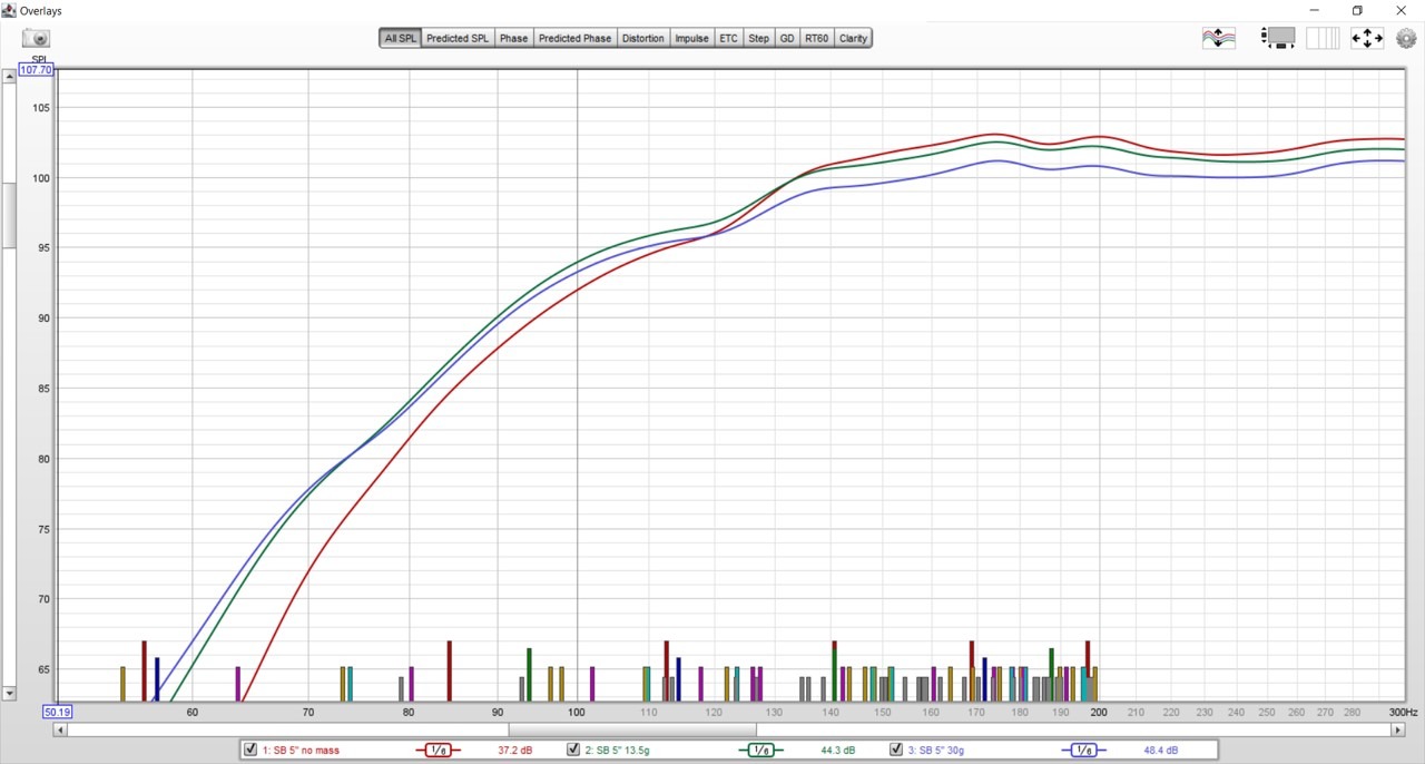

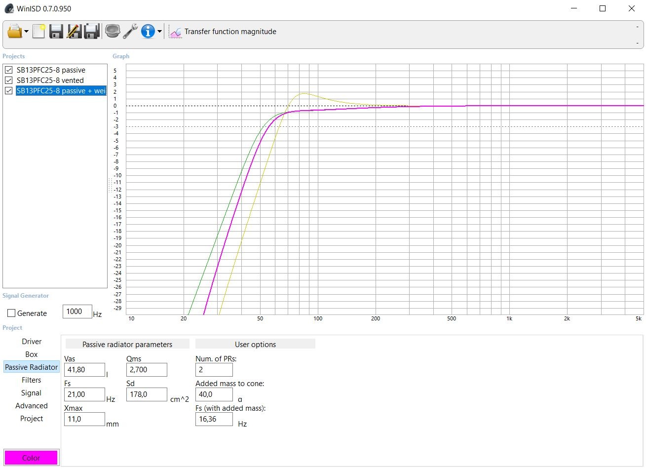

Firstly, have you used any extra weight for the passives?
See sim here, you'll get ca 10 Hz lover 3 db point if you add 40g to each passive radiator. Think this will help a bit.
Secondly I think as is also hinted by raymondj, your are running the tweeter too hot. This will give a light sound with less bass.
You should try aiming af a lightly sloping freq from 1 to 20 kHz by -3 to-6 db (normally described as a house curve).
Also maybe try to crossover a bit higher e.g. 2.5 kHz, for higher power handling and probably more even directivity (check directivity by measuring e.g. 30 and 60 dg angle)

WinISD; Magneta = passive + 40g, Green ported, Yellow, Passive without extra weight

If you want to, possibly try one subwoofer and tune with mass. You can mount penny/fender washers on the rear to tune and see if you can get more output. Hopefully this will work out to your satisfaction.

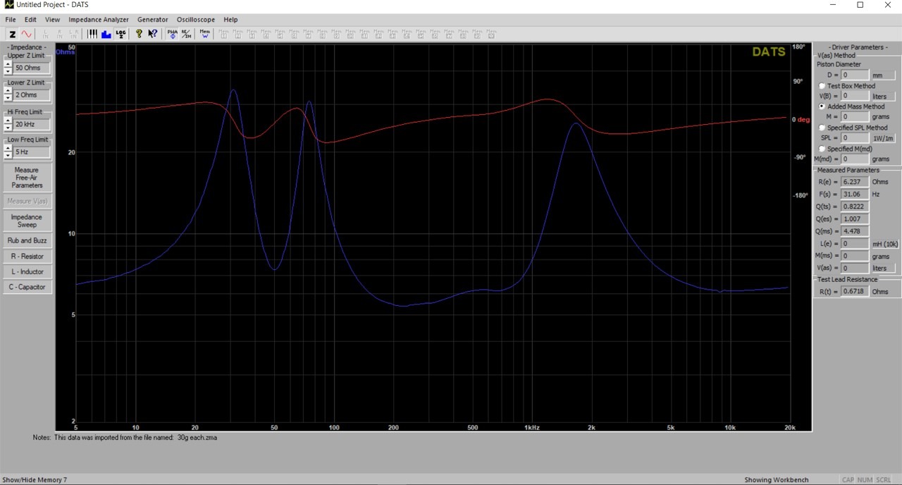

I did find something interesting about the measurements though. I have the Satori 9.5 WO24-8 in ported enclosures from a past build and hooked them up to fill in the bottom end. I did some measurements in the same room but the speakers were on the wall and the mic was closer to the listening position and the response curve still looked basically the same on the bottom end with the fall off at 100hz and hit a wall at 60hz. Even when I turned the outputs on the woofers up the curve looked the same even though the room was shaking.
So it's possible I'm not taking the best measurements. I'm using a UMIC 1.

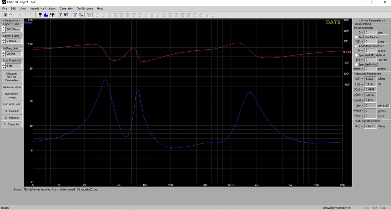

The impedance looks well balanced. So you have made a small improvement,
I wonder if a different box size would improve the width of the null and increase extension. I wonder if there are any rules of thumb for using passive radiators and a quick search highlighted this. Which may be worth a read.

There are some things that puzzle me, here they are in no particular order.
The FR of the tweeter doesn't look right, and I wonder if you have a calibrated mic.
It seems you are using a gated measure (good), but the gate is really short, and is difficult to estimate the SPL of the woofer vs the tweeter. The balance can be off.
The crossover point is really low, the dispersion characteristics of the woofer would suggest a crossover point between 2 and 2.5 KHz, easing the tweeter.
The woofer should give enough bass with a F6 point in the mid 40s, with a 9L bass reflex box tuned to 50Hz. Why do you choose passive radiators instead of the easier reflex?
How are you measuring the low frequencies (the last graph)?
Ralf

You are probably using gated measurements on low frequencies. That obviously doesn’t work. Bring the mic real close to the cone, about 1-2cm and don’t apply gates. Repeat that on the PR. Post those graphs if you like.

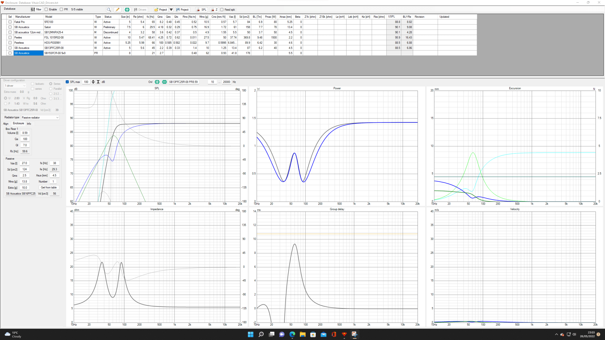

Vituix CAD allows you to model 2 Passives I have just tried it with what I think you are using the 5 x 8 Racetrack Passives.
The modelled response gets down to 50 Hz. It does drop off very quickly. I wonder if that is also part of the experience that there isn't much happening at 30Hz say. maybe leading to a particular quality of the bass????
The impedance plot doesn't look to far away from your own graphs.
Another observation is looking at the published response graph the lower frequencies start a gentle decline from 200Hz, its subtle but again possibly another factor in you search for more bass.
Hi flipsnshyt
It's not so easy to make correct low freq measurements.
https://audioxpress.com/article/measuring-loudspeaker-low-frequency-response
As markbakk pointed out use close mic on both woofer and passive and sum it up (you need to add 3 db for duoble passive).
You can check gating, by opening the impulse response view in REW and adjusting the "measurement window" to at least 500mS.
When measuring bass you'll have a lot of room affecting with high peaks and deep dips, caused by room modes.
But looking at your impedance response it all seems fine and very much in line with the simulations. You have a resonance freq at ca 50 Hz, and I think this is more or less what you can expect from this driver. ...... and I was almost going to say; what did you expect? 😉 ...
