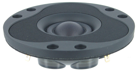

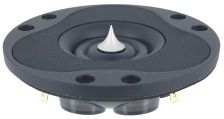

In the German magazine "HOBBY-HIFI" 1/2011, page 59 and 60 is to read about the datas and individual characters of both dome tweeters, one without phase plug and the other with phase plug.
Who have heard both tweeters at the same time in the same two way combination ?
What are the audible pros and cons of an phase plug in such dome tweeters in general ?

actually I use the D3004-660000 and I have never auditioned it in comparison to the ring radiator model. But there was no need to do so: The ring radiator has slightly higher distortion and, more important for my use model, the regular dome has a much wider dispersion. Just compare the 30° and 60° off axis responses. The ring radiator produces a pretty thin beam maybe 3KHz and up. Pretty high directivity. So check your design what you want/need.

Thanks for reply. This I know all. The omnidirectional beam behaviour off axis (horiz. and vert. directivity) is without the ring radiator design clearly better. On the other hand, the dynamic behaviour is better, if the ring radiator design is present, especially by the use of low crossover frequencies and or low crossover slope <18db/oct. This is cause better avoiding break up effects of the dome/diaphragm, if there are peaks with high slew rate in the music signal.
I ask more concerning the audible impressions, not the physical differences.
