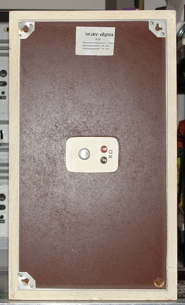

I recently have been looking for a different pair of speakers for my workshop and ran into what the label says is an A25 Scandyna product. However, when I took off the grille cloth, there were three speakers and no vent.
It appears that this is actually an M25 via the good folks of the interwebs and that is was built before the A25. That might explain why the sticker reads 4 Ohms and the speaker terminals say 8 Ohms. (Which is also what the impedance is-- DC resistance at 7 Ohms)

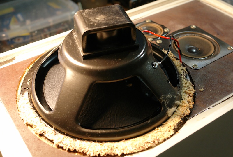

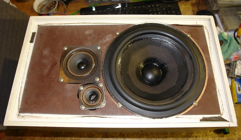

Basically, the cabinets are very cheap particle board and the front baffle is loose on one speaker. It appears the baffles are stapled in at an angle and one in the corner by the bass missed so the whole baffle can flex.
As the speakers sound much better than I expected, and they seem to be a nice match with my Dynaco Stereo 35, how would I go about repairing the cabinets? As the original glue pulled quite a bit of the wood around the woofer, I am thinking it might have to be reglued?
Would it make more sense to build new cabinets all together? (Including putting the drivers in a row, or does this not matter so much?)

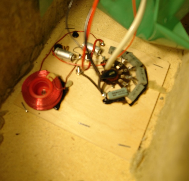

I wonder if someone reporposed the box. The XO definitly has the same look as an A25 one, just with an extra cap & coil.

The woofer looks very much like it is one that didn’t quite fill the hole — i have had to use screws in that many to solve the same issue.

... they look to be glued down with the same black stuff that was used on the woofer. I wonder if silicone could be used as a substitute here if I do try to reinstall the woofer?
That stuff is terrible. I would suggest new baffles at a minimum, and use closed cel neoprene door seal tape (darft exclusion tape) for gaskets.
An opportunity to at lease reconfigure the driver arrangement.
The woofer fits but doesn't have any screw holes
Another reason for doing it that way. There are proSound L-shaped clips that are better (and move the screws further out), that would be better, or at least bigger washers.
