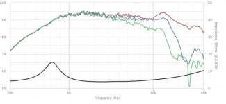

Hi All,
I am looking for replacement tweeters for my beloved Sonus Faber Grand Piano Home speakers.
I was quoted $800 for a pair from the North American distributor with a lead time of 90 days (provided that the manufacturer in Italy still has some on hand).
There is no way that is going to happen so I looked into alternatives.
I understand that Sonus Faber sourced the tweeters for that series from Vifa. Further investigation revealed that a Vifa DX25TG59-04 would be a drop-in replacement as would a Scanspeak d2604-830000. Both tweeters share the same physical dimensions but there are some differences in their electrical and mechanical properties according to their respective spec sheets. Please refer to the attachments.
Unfortunately I an not well versed in interpreting most of those parameters but I am led to believe that the Scanspeak tweeters are superior. Now its worth mentioning that I am not necessarily looking to improve upon the originals as I was completely satisfied with their performance. I chose that particular speaker because it strikes the perfect balance of smoothness and detail in the top end. I am quite intolerant of bright speakers.
If one of the alternate tweeters prove to be superior or more resolving than the original which I imagine may be likely as they are more than 20 years old now, so be it, but not at the expense of being bright.
That said, which of these two tweeters would be a better choice, and why?
I welcome and appreciate all comments.
Happy New Year 🙂

Those are quite similar tweeters in general, but if as you say you are very sensitive to high frequency a simple drop in into existing crossover may result in altered HF representation. Ideally, you want to measure and tweak the crossover. Is there are any chance you can get a spec sheet from the Sonos assuming how old is this model? That would help us to help you a lot. Have you considered searching second hand market?
If you find a tweeter with exactly the same impedance vs frequency and acoustic output vs frequency you will be fine. So I would be studying the back of the existing tweeter to see if you can figure out exactly what company made it and what model it is. When Stereophile reviewed it they said "¾" silk-domed, ferrofluid-cooled SEAS tweeter." So head over to https://www.madisoundspeakerstore.com/soft-dome-tweeters-seas/ and look for a 19 mm silk dome with ferro fluid. If not, you are looking at redesigning the crossover to work with a different tweeter or you could put in any tweeter that fits and then fix the response with a digital signal processor. Or scrap the passive crossover and make the whole thing a multi amp active speaker with digital crossover like a miniDSP.

DcibeL- Both the Vifa and Scanspeak are available locally and quite inexpensive considering what the SF speakers initially cost, $32 and $61 respectively. A far cry from $800...
PKI- A few guys over on Audiokarma had success with the Scanspeak tweeter. In both cases, that tweeter was installed in smaller pairs of 2 way, SF Concerto and Concertino models which employ the same tweeter as the 2.5 way Grand Piano. In both cases, the tweeters that were replaced were completely dead or close to it so they really didnt have any reference to the new tweeters, only that they are pleased with the results.
The SFGPH is stated as having a sensitivity of 90db. Its quite possible that sensitivity of the original is close to the replacements Im considering. Incidentally, the tweeter is high passed at 3khz in what appears to be a second order filter. I`ve attached a picture of the crossover.

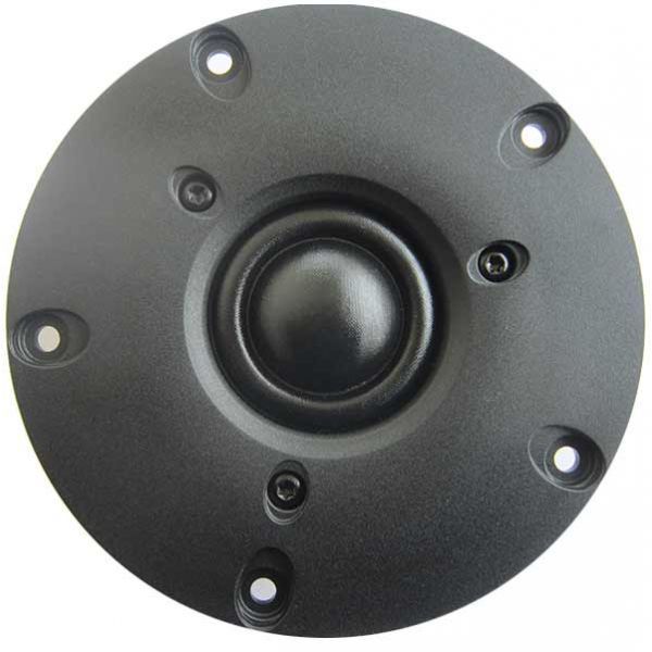

If your speaker is the one in this link: (Grand Piano Home) then I'm not sure that either of the proposed tweeters are good candidates for a drop in replacement. At least the faceplate is very different.I am looking for replacement tweeters for my beloved Sonus Faber Grand Piano Home speakers.
For sure the Grand Piano Home is not the speaker reviewed by Stereophile (Stereophile review) which appears to have a standard SS 3/4" tweeter.
The first link has a photo of the specs, showing that the Grand Piano Home uses a 1" tweeter, but there aren't any suggestion on who is the real mfg of this tweeter.
What I'd do: remove the tweeter, and remove the faceplace from it (unscrew the 3 inner screws where there is the grille), and post photos. If the tweeter is Vifa it should be pretty evident. However the dome and motor of the DX25TG59 can't be an exact replacement in your case as this tweeter is newer than yours and is a mod of the older DX25TG09 tweeter with a slightly different SPL (IIRC the new one is slightly more sensitive). A trace of the existing crossover can offer a clue of what is needed in the case of a tweeter swap, maybe a simple different padding resistor.

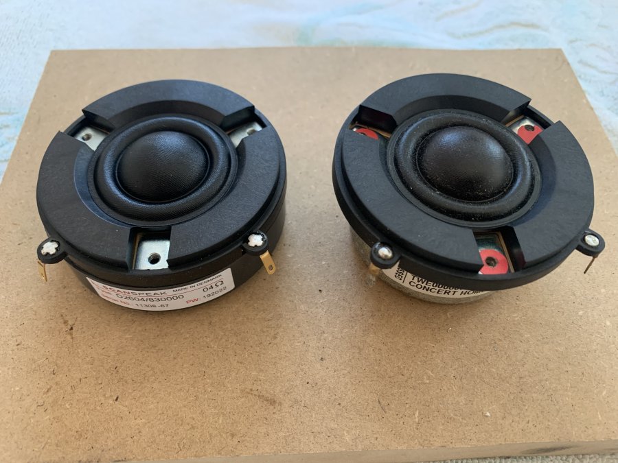

Have a look at the attachment where a Scanspeak is pictured beside an oem SF. All that is required is that the original SF faceplate is transfered over to the new diaphragm/motor assembly.If your speaker is the one in this link: (Grand Piano Home) then I'm not sure that either of the proposed tweeters are good candidates for a drop in replacement. At least the faceplate is very different.

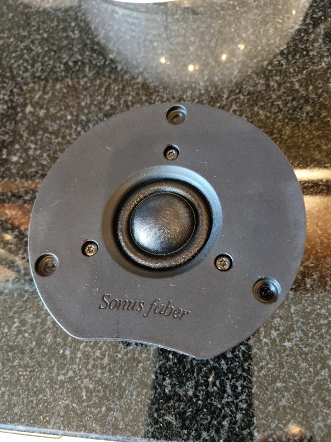

Frankly, you should dismantle one from the loudspeaker and drop a photograph here. Maybe just by measuring the dimension you will know if a Vifa Peereless or the SS ! And also you will will se how it lokks without the face plate that looks to be made indeed to tame off a beaming or because it is a hard dome... Open the box to see how is looking the cat !
There is no question, the original is a Vifa as documented in several reviews. I`ve attached pictures of the Scanspeak and the original. The Vifa is identical to the Scanspeak.Frankly, you should dismantle one from the loudspeaker and drop a photograph here. Maybe just by measuring the dimension you will know if a Vifa Peereless or the SS ! And also you will will se how it lokks without the face plate that looks to be made indeed to tame off a beaming or because it is a hard dome... Open the box to see how is looking the cat !
Why do you want to replace the original tweeters? And you could probably swap the VCA, be it the ferrofluid should be topped up too.
Photo of the back please, maybe also without the faceplace. The drivers in the photo posted before doesn't look quite equal, the Vifa (edit: the SS) one has a bigger magnet.
Having said this, for the cost involved, if your original drivers are blown, buy a couple of new DX25 and swap the faceplate, and see or better hear what happens. If the problem is thickened ferrofluid then remove the old and replenish with new.
Ralf

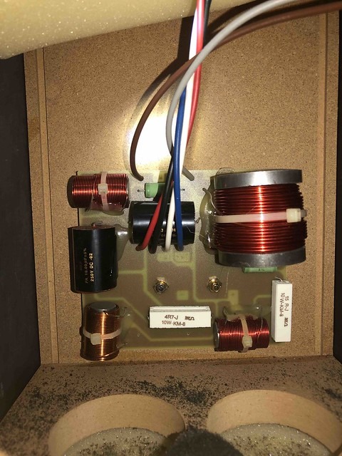

Make sure the owner has not changed capacitors or resistors as well... it also voice the speakers a lot...

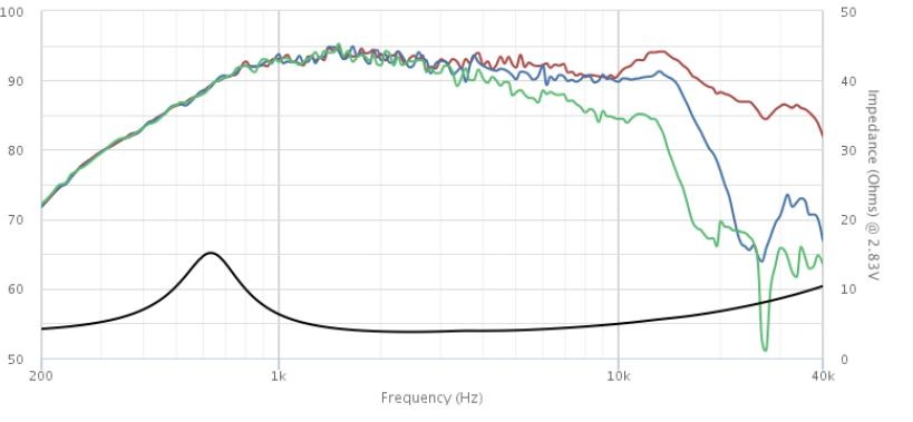

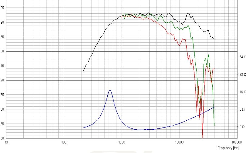

Thanks again to all that have chimed in.
It seems that valid arguments can be made for either tweeter that I am considering, there are not any day and night differences between them in terms of specifications. The biggest difference is in the prices where the Scanspeak is about twice that of the Vifa, but still a quite reasonable $60.
Judging by the frequency response graphs of both units, they appear to to be very closely matched but the Vifa appears to be a little smoother in the 3-kHz region. Both have a peak in the kHz region but the Vifa is broader.
Both tweeters seem to be well established drivers and equally well regarded, it would be hard to go wrong with either me thinks.
I think the logical thing to do would be to get one of each and measure them, as well as the original which would serve as a reference.
They appear identical - the only reason to get the Scanspeak is if you think you might get better manufacturing consistency (hence matching) between 2 samples.
Then again, if the Vifas are half the cost, you could get 4 of them, measure them, and keep the two that are closest matched 🤣
