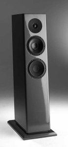

ScanSpeak Reference Plus speaker (from audiocomponent.nl site)... how is it?
It is a three way design using ScanSpeak 18W8545,18W8546 and D2905/9900. I found several european speaker DIY site which has this speaker in it.
It seems to be a good design. Just the fact that it's three way using all scanspeak drivers.... Anyone tried it?
For those who are familiar with this design... its baffle is tilted 18.25 degrees from vertical. i.e., all the drivers are slightly looking upward. What's the reason behind this? if I make the cabinet with same internal volume but with a straight vertical baffle, will I get a "wrong" sound?

The reason that the cabnet is slanted back is to align the acoustic centers of the drivers. The acoustic center of a woofer is not at the open end of the, but a little behind that. Adding a crossover to the drivers (a necessity, of cource) can change the centers relative to the other drivers. A sound coming from one speaker might lead the sound coming from another speaker by 90 degrees. Another phrase for this is "group delay." If all three drivers were out of phase with the others by 90 degrees, then putting them in a slanted baffle would align them.
