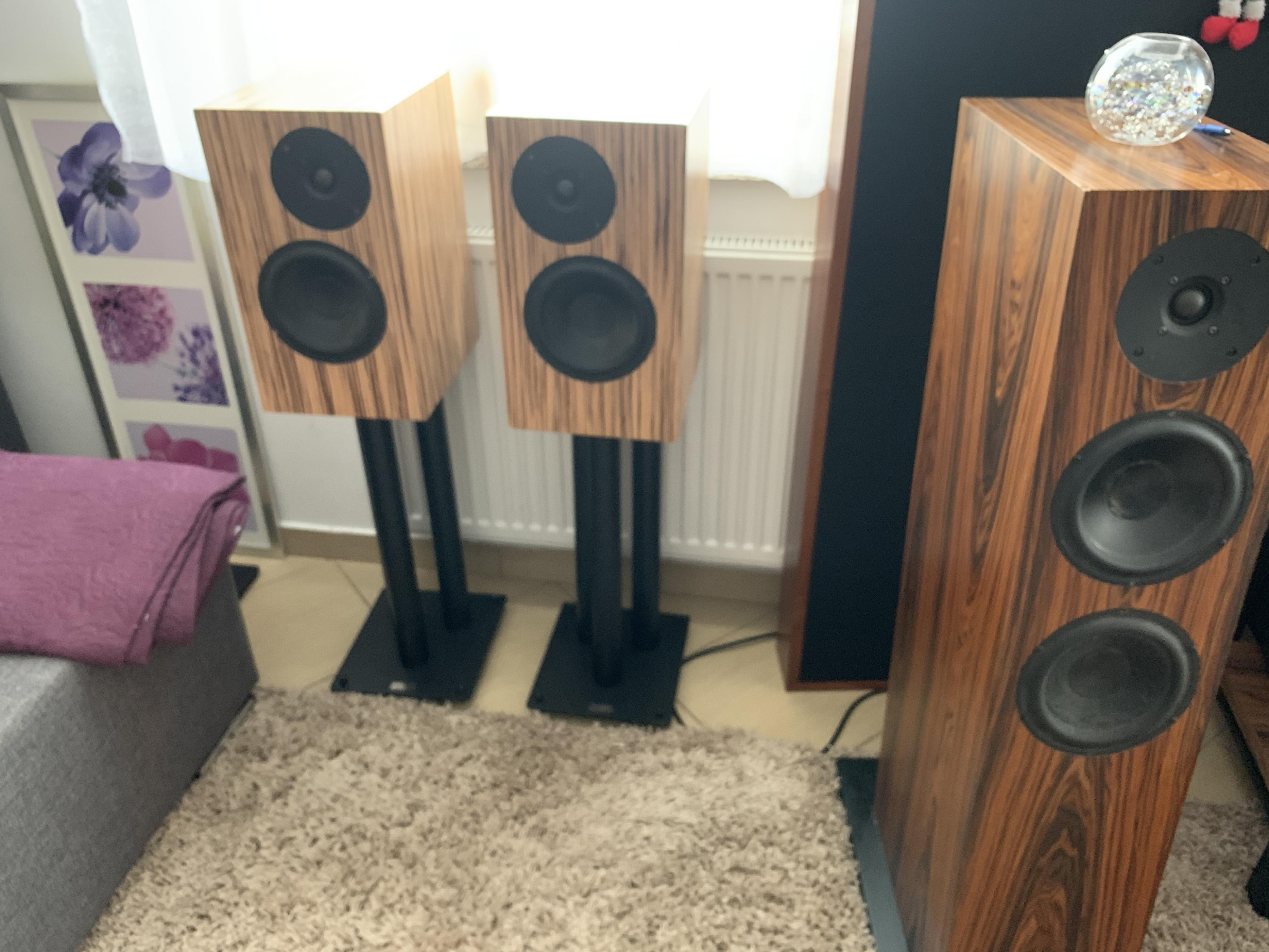

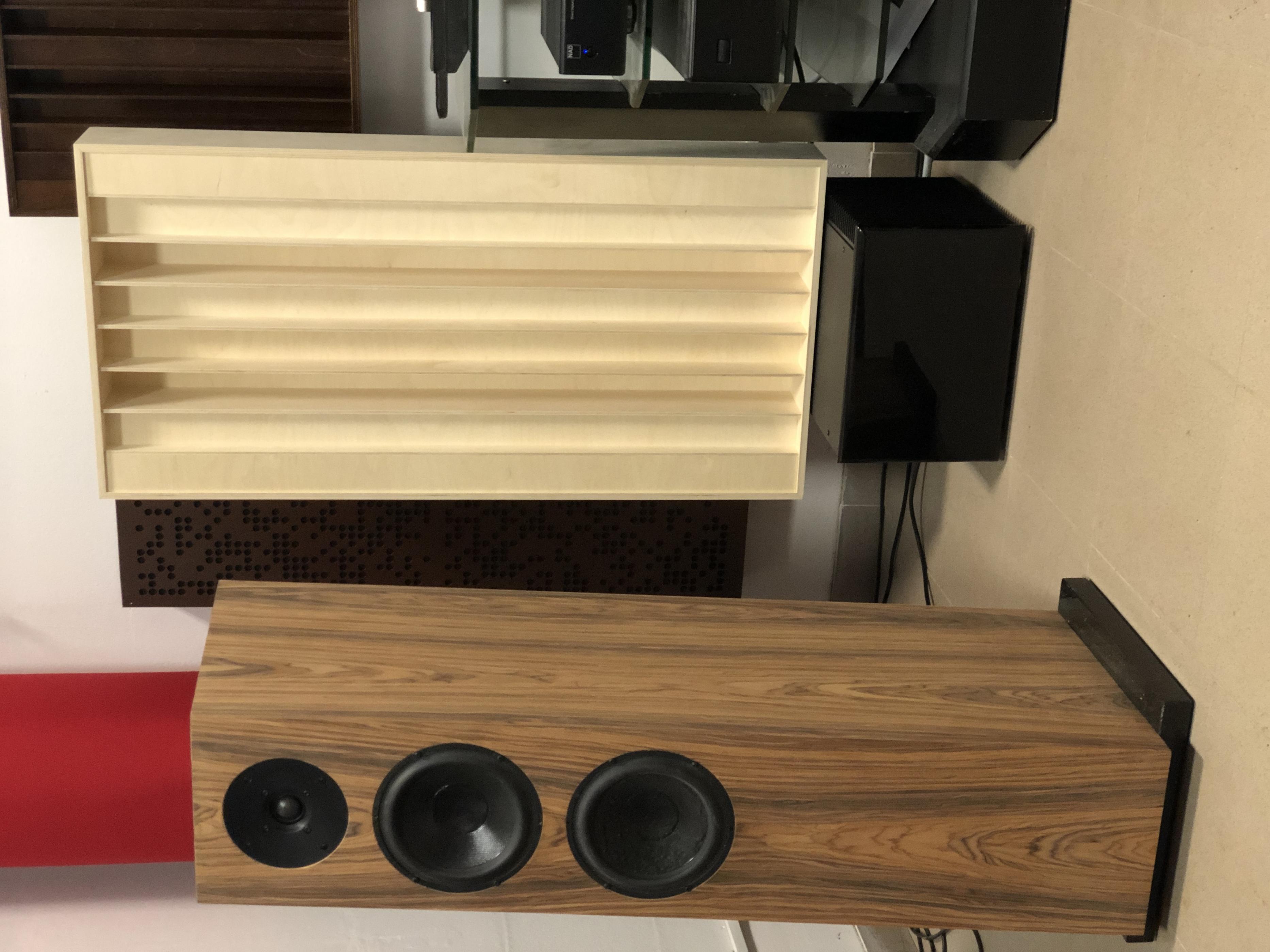

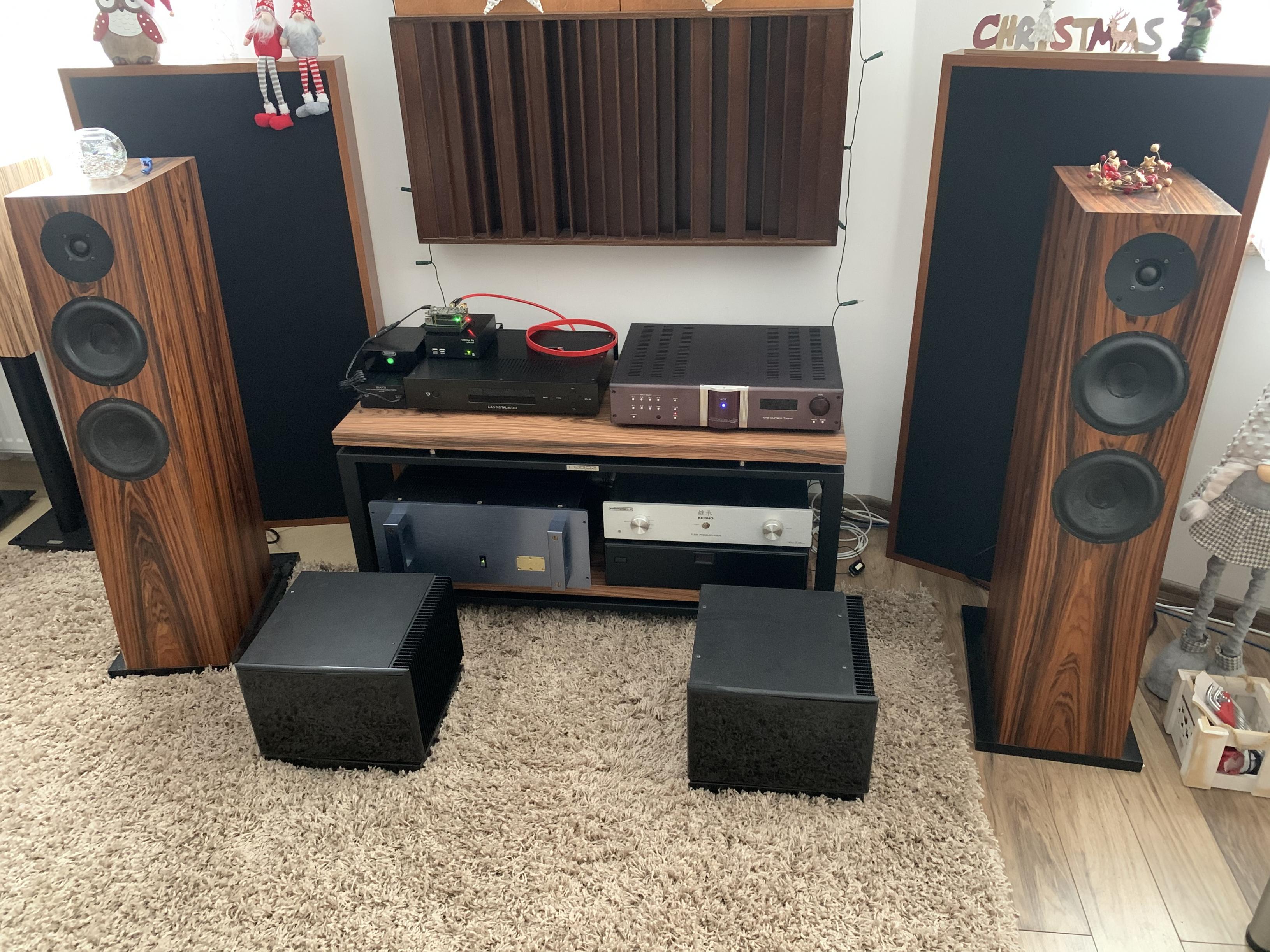

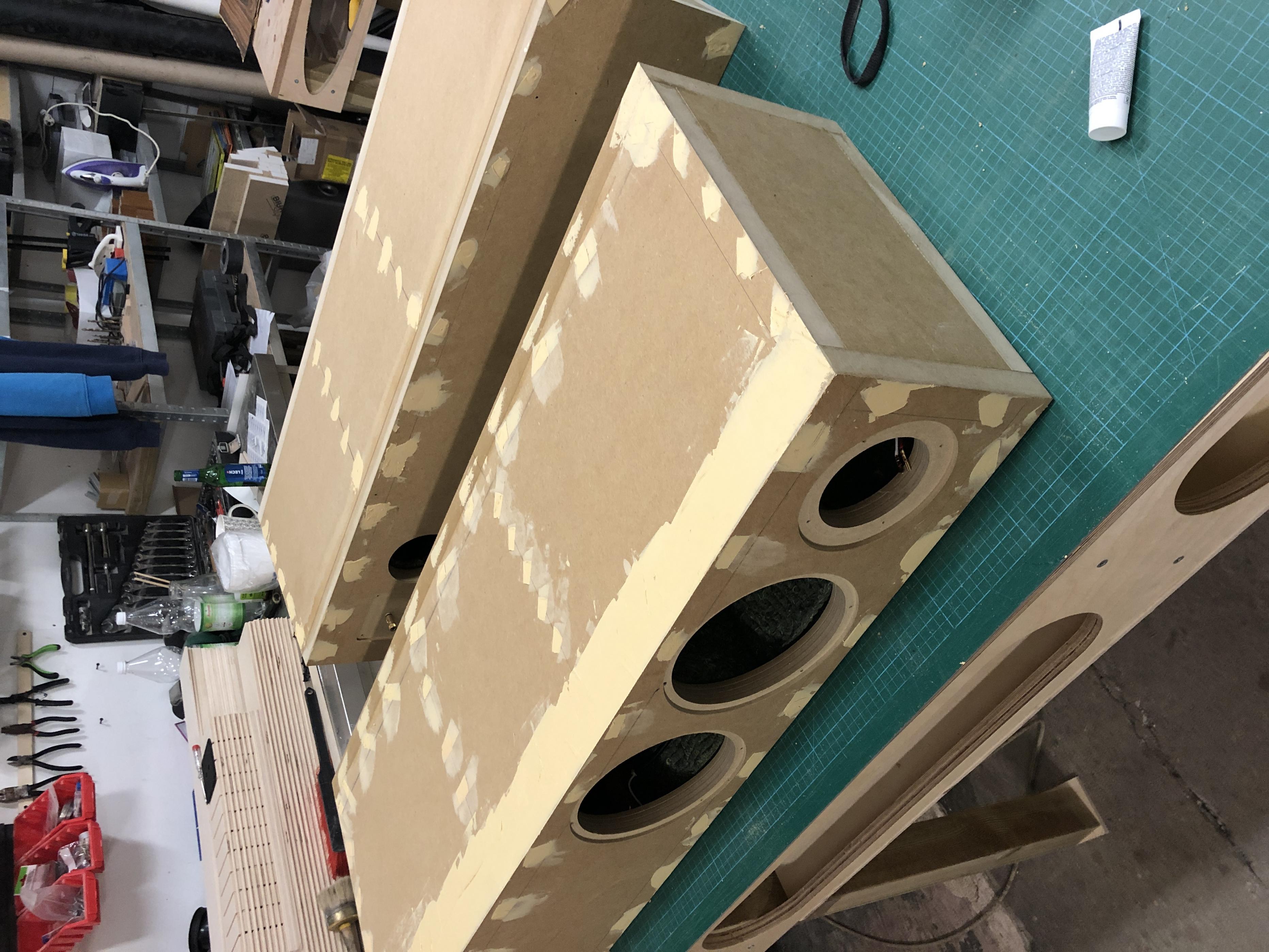

Hello, at the beginning I would like to say hi, my name is Artur and I am new to this forum. I have completed both projects - Scan Speak reference monitor and reference plus. Very good drivers were used in these projects. The 2905/9900 is one of the best tweeters ever made. Kevlar midbass 8546-01 gives a very sweet sound, in my opinion it is even better than 8545-00, although a bit more difficult to apply. The 8545 is a loudspeaker used in many projects by builders around the world. In this particular application it is cut very low and acts as a subwoofer. At this volume it gives very low bass and a good impulse response. So the speakers are great, but the crossover is terrible! Both the Scan Speak reference Monitor and Reference Plus have a very recessed midrange, and the treble is definitely too loud and tiring for the ears. I took a long time to fine-tune the crossover, and had to make a few modifications for all drivers. I would like to share my experience with people who are going to build these speakers.
2.2 mH for the voice coil is way too high, so the sound is recessed. I tried with lower values and in the end I got the best result with a 1.8 mH coil and a 5.6 Ohm resistor in parallel.
As for the Revelator, a slight modification also should also be made here. The 3.9uF capacitor is far too low. 4.7 uF should be used and the 0.82 mH coil should be replaced by 0.56 mH. This speaker sounds way too loud, so the 4.7 Ohm resistor should be replaced with a 5.6 Ohm resistor.
In the case of reference plus you also need to modify the crossover for the woofer. As mentioned above, the LCR filter is a must-have for the 8545-00, otherwise the upper bass is a bit too loud. However, with this filter there is not enough bass for my taste. Fortunately, scan-speak has made a new version of this driver with kapton. It is marked 8545-K00 and its impedance curve is much more friendly. It can be used without an LCR filter and then it shows what it can do. This is a great bass driver, I do not know a better 18cm that would produce such excellent bass. I hope you find this information useful.

Thank you very much. However, These speakers sound much better than they look. It's really worth building them !
