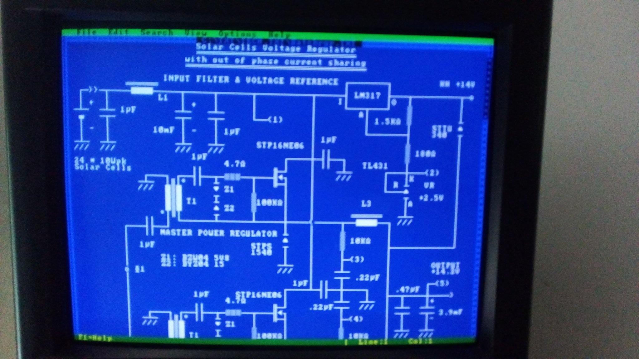

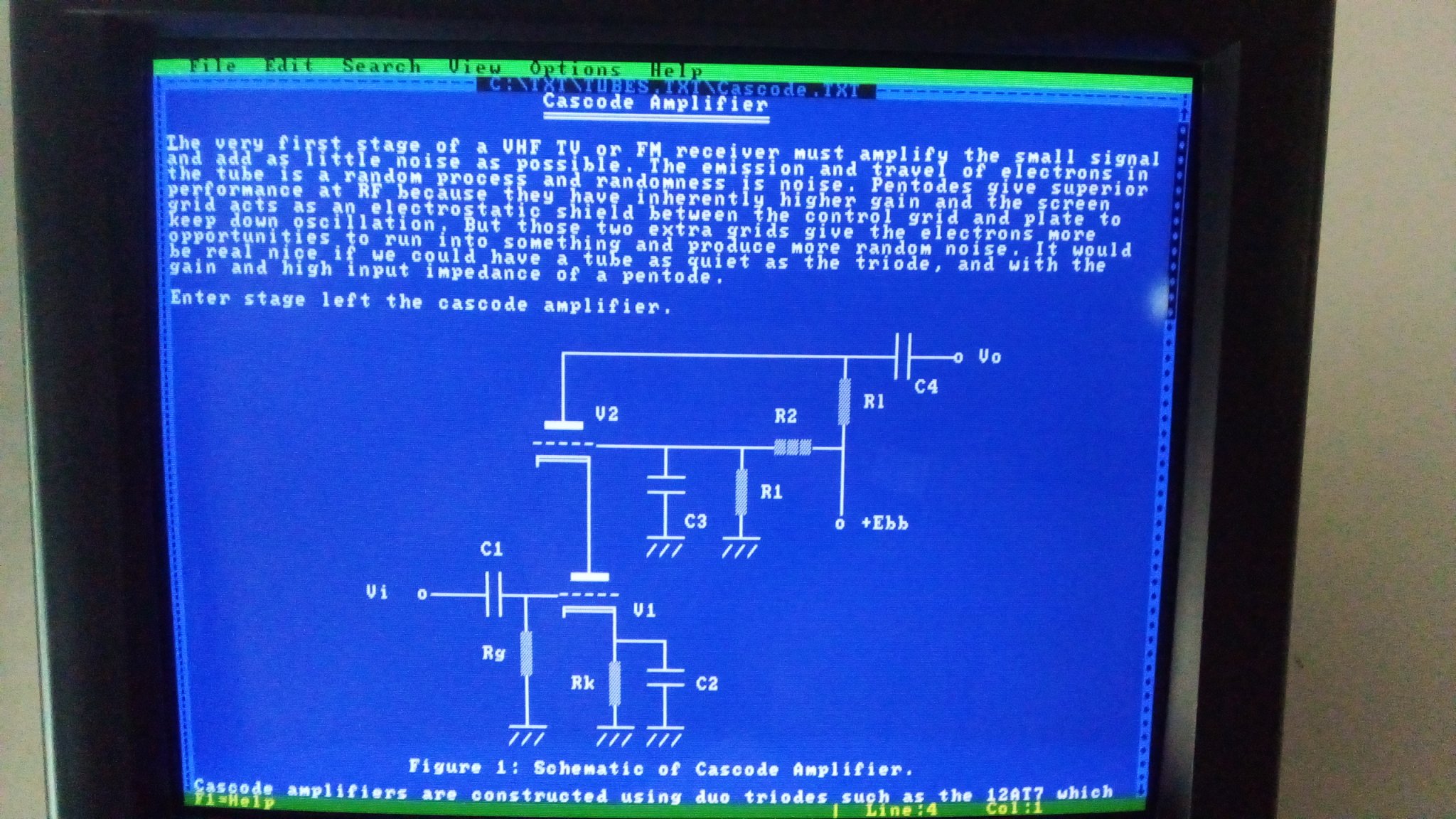

I normally use the most elemental text editor for schematics: the edit.com. It is quite simple and low size files.
Also I use ORCAD SDTIII for DOS. Or Express PCB on XP. A guy from the autotrax program gifted me the last version for DOS, the ATX v. 4.0. But l am now seeking for a program or app for Andoid.
