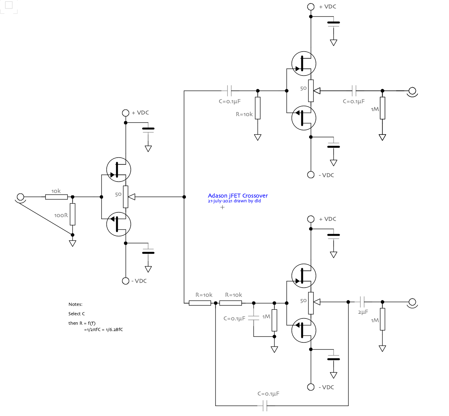

I use VectorWorks. I have some 30 years experience with it. And very comfortable with it and a large collection of bits already drawn that can be repurosed in another drawing.
You can see lots of my work posted here. An example.
