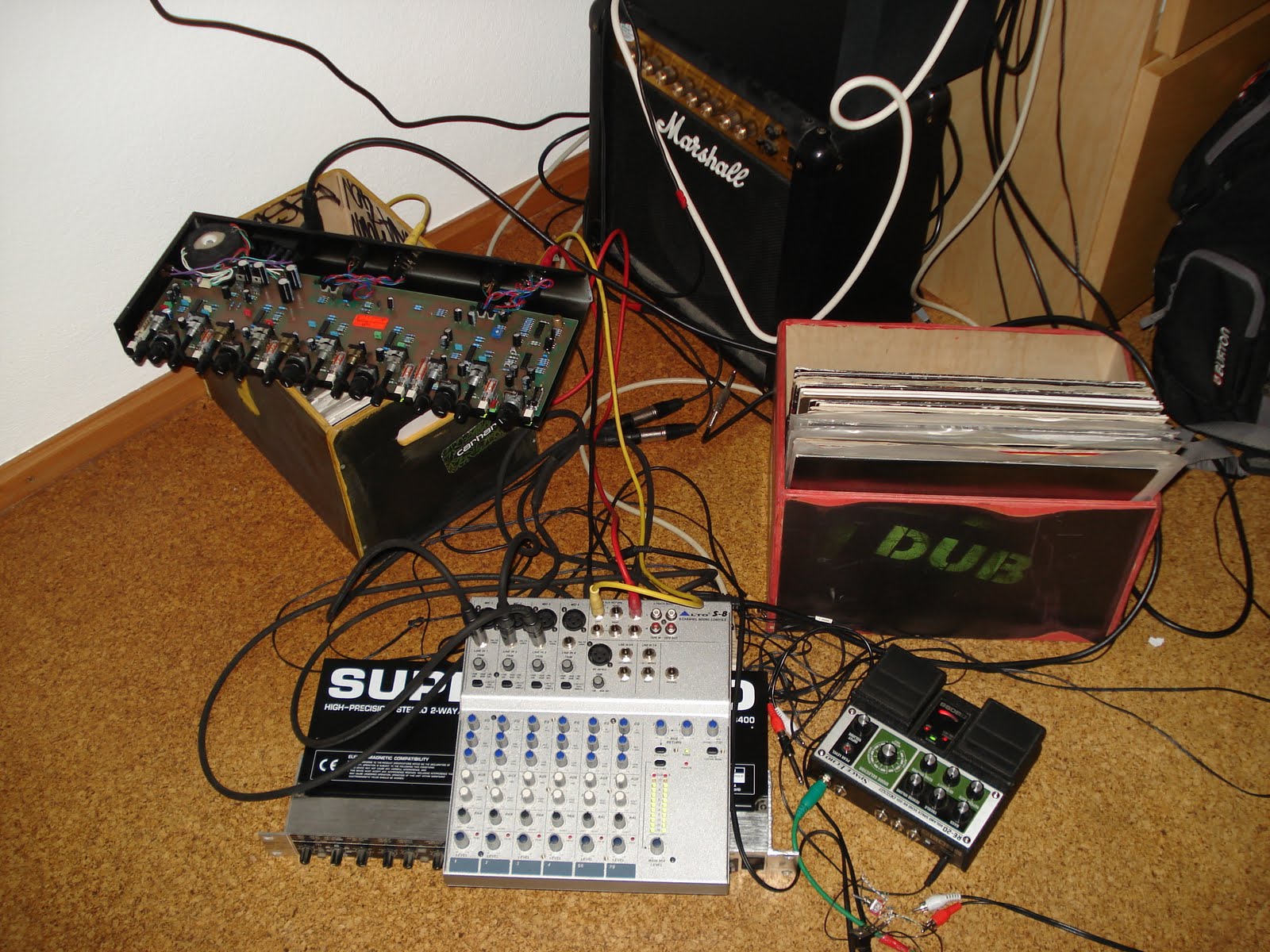

On the image of an opened device from this model is to see, that the parts are no SMD, but newer devices from the same model are performed in surface mounted technology, as a German guy from Behringer service center tell me.

If I had to guess by the picture of the open sample, it's a TL074 (or maybe MC33179) grave with a 78xx/79xx power supply. Assuming circuit topologies are chosen properly, this may be entirely adequate.

The unit works, but I want enhance the sound quality. The schematic I have in the meantime (reverse engineering), but I want to have additional the instruction- (resp. owner's- or operating-) manual) of this device so as the associated industry standart quad op amp labeled from Behringer itself.Hi tiefbassuebertr,

The Behringer naming is follow: "BE037 A0021" and the pin connection is compatible to the TL074/TL084 or MC33179 but not to Raytheon's RC4136. Cause used 1,2 meg-ohm resistors at the inputs there must be internal jFET's in use for the first stage, like by the TL074/084 ones.

More informations to Behringers quad operational amplifiers "BE037 A0021":
Current flow for all 7 pieces: 590mA both in positive and negative rail. This means 84mA for each quad device and 21mA for each single opa.
TL074 needs only 1,4mA typ. and 2,5mA max according data sheet.
The used supply voltage is +/-18V, created by good known voltage regulator LM317/LM337.
The device is manufactured 1992 according the used PCB.

the mentioned current flow from the last post was a misjudging resp. aMore informations to Behringers quad operational amplifiers "BE037 A0021":
P.S.: What means "Peak" and "Shelf" (only by the frequency areas 20-300Hz so as 1K-20K) ??
miscalculation from me. The true value is only a tenth (i. e. 10 percent) of the mentioned value, this means 59mA.
The voltage accross the serial resistors in the supply rails (between the voltage regulators and the power supply pins from the quad operational amplifiers) was 590mV, unfortunately the resistor has 10 ohms, and not according the color rings (brown-black-gold) only 1 ohm.
Various other resistors on this PCB have also values, which do not correspond to the color coding rings.
Thus all resistors I had to re-measure.
