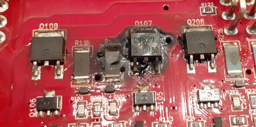

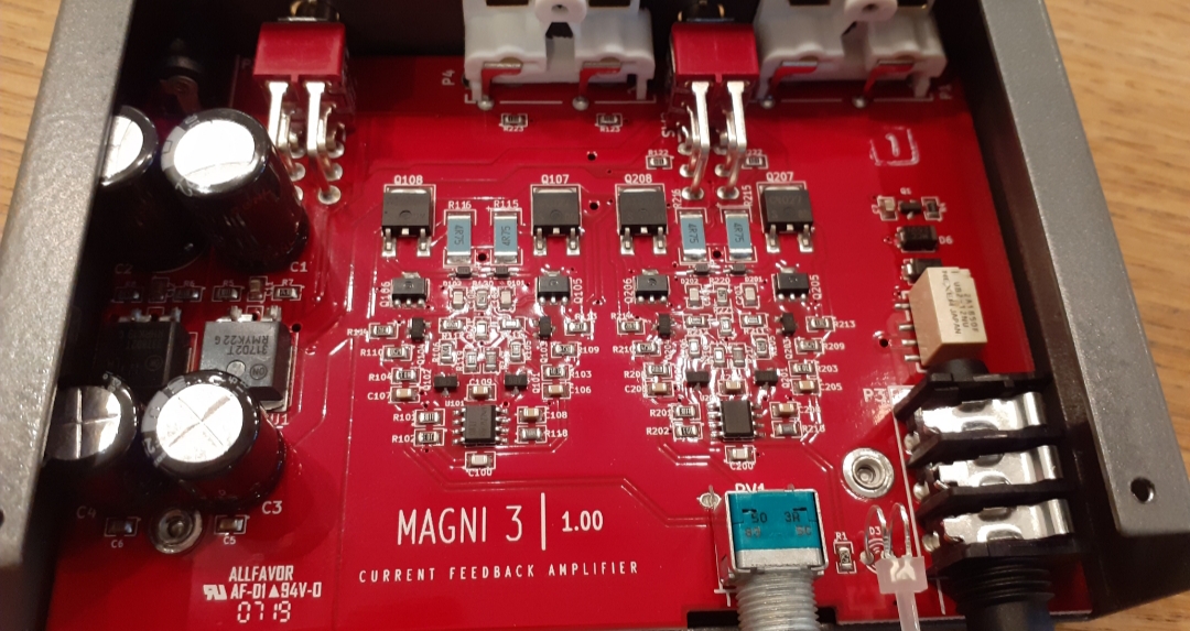

so as in the attachment (first both images) you will find versions with destroyed output stages.
A headphone friend I know well wanted to hear my opinion on this device because he is playing with the idea of getting this device.
But after checking the web I found the above mentioned (I was shocked), so that I strongly advise against buying it.
Nevertheless I want to know the reason for that or at least the schematic, which isn't online for download.

If one npn is toast plus the pnp on the other channel, this may suggest that L and R had been shorted together - this can happen momentarily in headphone jacks when plugging/unplugging. I would test for continuity between L and R just in case, and if found, inspect the headphone jack solder joints first and follow the PCB traces back if need be.
It would appear, then, that the circuit's short circuit proofing leaves something to be desired (well... presumably there isn't any). It should be obvious that a $99 commercial product won't be overbuilt in the way DIY designs often are, and I guess they didn't want to compromise power output either.
The point where it gets concerning to me is when the amplifier even gets hot yet still isn't blowing a fuse. That definitely shouldn't be happening.
Well, this low-end product certainly does not convey the feeling of luxury, but a short to ground could be caused by a break in the equally cheap headphone wire.
An ASR poster is saying the amp runs hot. The output transistors are only rated at 1W at an ambient of 25oC when used without heatsinking. The PCB layout shows no copper area dedicated to heatsinking the output devices. My tentative conclusion - the thermal design sucks.
I agree with sgrossklass. Those pictures likely show a catastrophic sudden failure. The only protection against a short appears to be the 4.7r emitter resistors. Combined with transistors running hot and thus a degraded SOA, a short could easily kills the output transistors.
