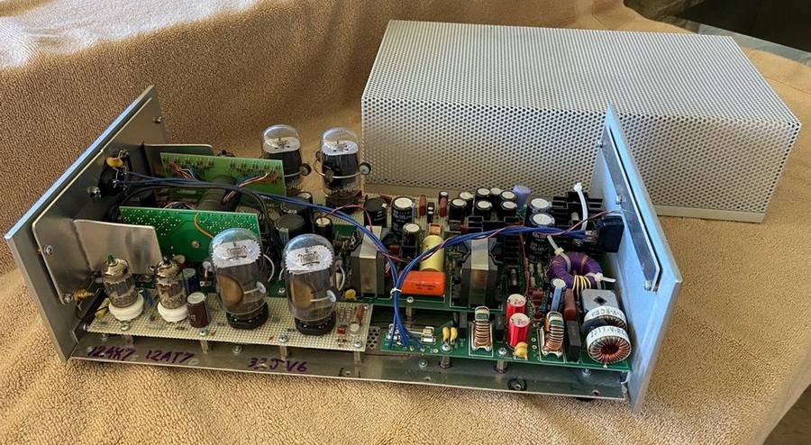

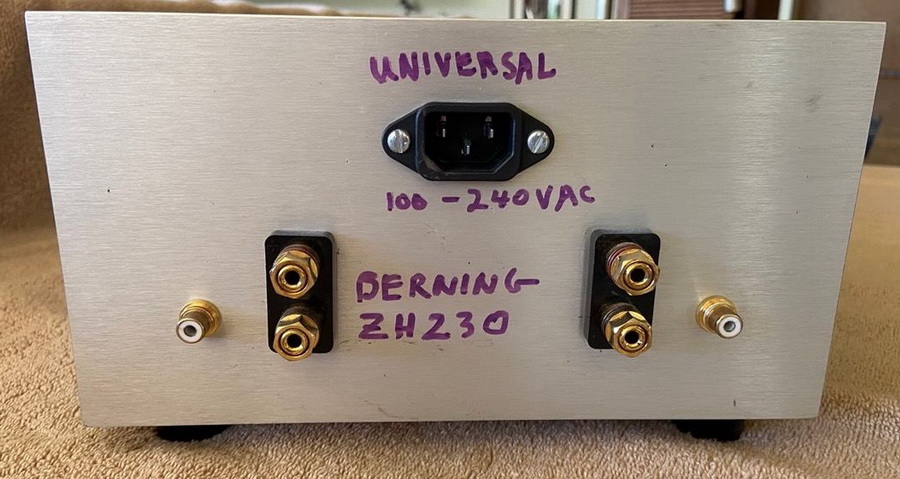

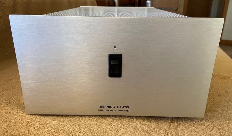

I recently bought a Berning ZH-230 OTL amplifier. It does not have a volume control.
It is a prototype, Berning recycled a face plate from an EA-230 amp, but the real story is on the back of the amp in Berning's purple marks-a-lot. Operates identically to the production model, including the ability to mix and match 12au7, 12at7, and 12ax7 input and driver tubes to implement different feedback, output impedance, and distortion characteristics.
Please see pictures.

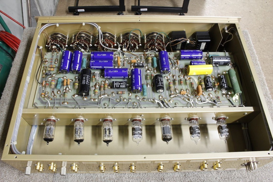

One is more than enough for me, I spent 57 years chasing an audio nirvana, I am 76 now and will be content to find a decent photo stage. If I get the Uesugi UBROS-1 full feature preamp, photo 1, I'll resell the Schiit for a few bucks.
If I was sure that the Otomon Ken Uesugi phono stage will work I would buy it, it costs half the price of the UBROS-1.
What a mess!!!
