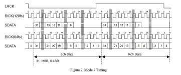

I want to use an usb to i2s board ( cm 6631A ) that output lrck and sck but not bck , can i use sck as bck in simultaneous mode for the tda 1541 A , with no oversampling ?

The sck on my board is 128 fs , normaly bck is 64 fs , so they do not have the same rate , will the tda1541a work with 128 fs in simultaneous mode ?

CM6631 has non-standard BCK output as it is 128fs for 44k1/48k and 64fs for higher sample rates. Modern DAC chips can work with 128fs but I doubt if TDA1541 can. You need to try it to find out. You could add a div/2 on BCLK if 128fs does not work.

Fact is it doesn't work at 128 fs , and the i2s to simultaneous glue logic ( same as the ryanj board ) has some reduction , so I have to find and usb to i2s board that output bck at 64 fs or divide by 2 the actual 128 fs

For div/2 single gate flip flop (e.g. 74lvc1g80) works fine. For div/4 binary counter (e.g. 74lvc163) is easiest. In addition it may be beneficial to reclock LRCK (or WS) with a flip flop.

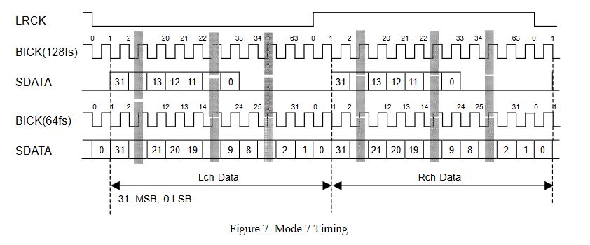

Hard to say without seeing how I2S signals look on scope or analyzer. Presumably this card with 128fs BCK at 44k1/48k works with some dacs so frame size is likely still 64 bits.
ok , what could go wrong when you divide by two the frequency of bit clock , a far as the signal doesn't become jittered or noisy in any kind , the i2s to simultaneous glue logic has 14 chips along the path , would one more chip degrade the signal that much ??
If the timings are as in post #17 (i.e. SDATA as in 3rd row) BCK divided by two would miss every other data bit.
