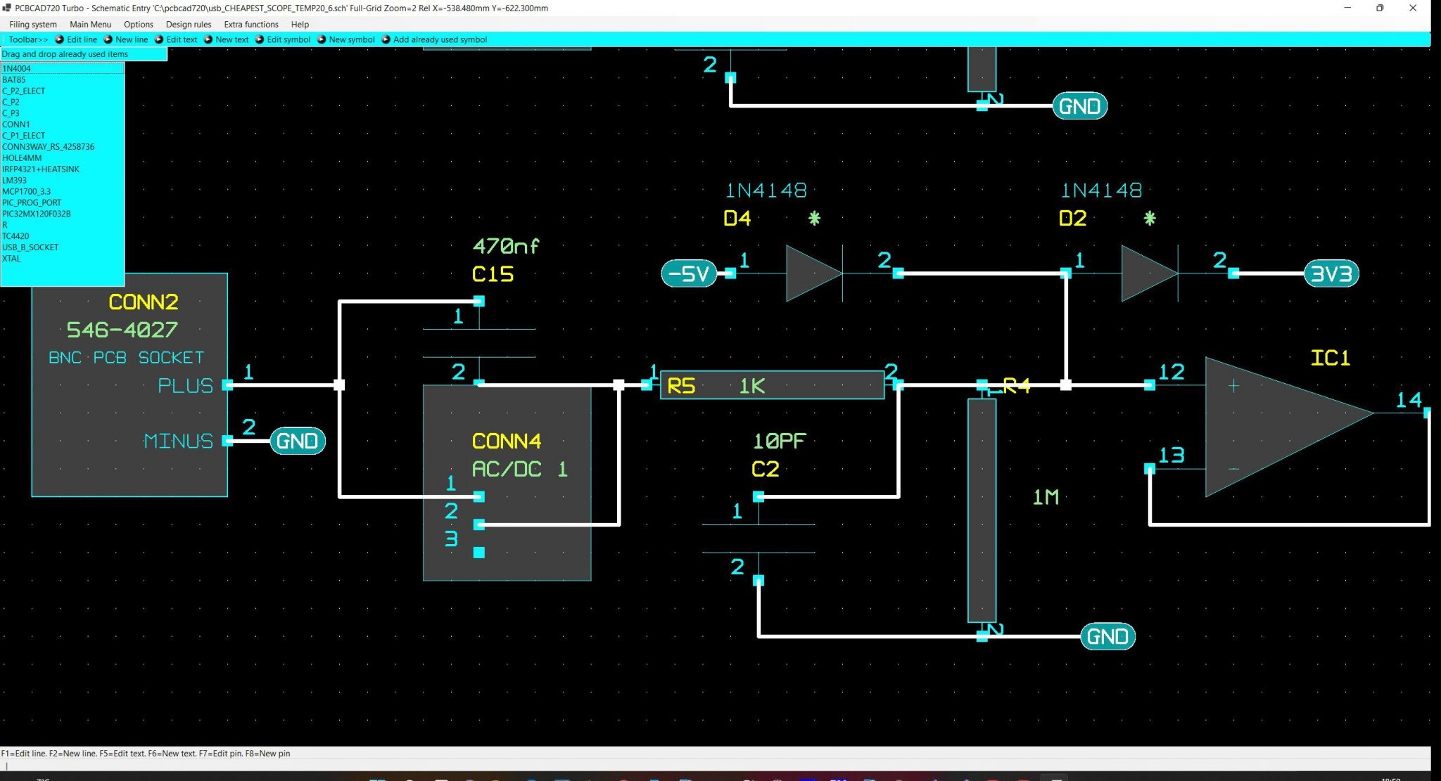

So, my old Tektronix died. Don't need 100Mhz for audio, but storage would be handy. Bought a Hantek 6022 20 Mhz USB interface.
NO AC MODE! Unbelievable. I see there are hacks to convert to AC only, and one could stuff a big cap in the probe, but this is just plain stupid. I knew it did not have a separate external trigger.

On my way to drop-off, I decided it is so cheap, I should just hack it. I'll test by making a little in-line block. If that works, I'll put it inside with a good micro relay and switch for each channel. It may be hard getting the isolation and low enough parasitics. 200V at least I think. ( I don't do tubes any more) Cap not too hard, relay maybe harder.
Success. I made a little adapter BNC to BNC. Put a .22u x7r in it. It works beautifully. Calibration square wave is square. It is only a 50V, so to make a pair of good ones, I'll order some 100V. So this thing is useable for audio work. I can look at noise and ripple.

Its not difficult to add AC mode to a scope, its just a switch and capacitor.

Am not certain exactly which model is discussed here as only "6022" was mentioned, but on Hantek EU homepage there's a "DSO 6022BE" and according to their info it has AC coupling, so not sure in what regards there is no AC coupling unless there are other similar models without.
https://www.hantek.eu/dso-6022be.html
With regards to the AC coupling cap 16nF, or closest standard value, should be ok as that corresponds to 10 Hz LF cut-off in conjunction with 1 MOhm input impedance, 10 Hz is a typical value seen on Siglent, Tektronix etc..

I don't know where you're looking, but almost all scopes have AC/DC coupling - 'toys' like your USB may not, just because of the issue of switching it. But certainly my Rigol scopes at home and at work both have AC/DC inputs.I was looking at a bunch of the newer digital scopes. Stand alone. Rigol etc. NONE have AC input mode. That is insane in my book. OK I can see if you had an option for an AC coupled probe but I don't see they exist. I am totally baffled. Do these folks assume the world only exists at logic levels?
Perhaps you're confused because it's normally done via the menu system?, if you're looking for a physical switch on the front labelled AC/DC you'll be looking for a long time.
The specs on the 6022 clearly specify AC/DC/GND coupling as is normal, presumably done on the computer screen?.
Edit: Just googled for a schematic, which clearly shows no capacitor for AC coupling (assuming it's the correct schematic of course).
