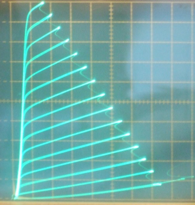

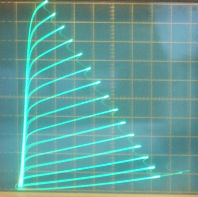

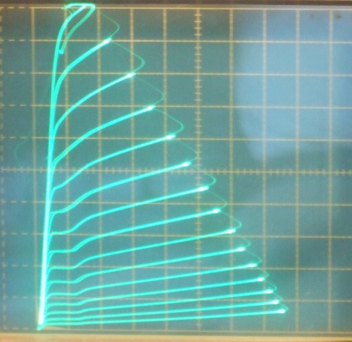

Are you sure those curves are for screen grid drive? They look more like "ultralinear" or grid 1 drive (except for the big grid voltages shown). [ Oh, I see what the problem is now. The grid 1 is being held negative there, which causes big kinks. Not a good idea. Grid 1 should be 0V. Grid 2 should swing slightly negative to shut the tube off at high plate V, not grid 1 ]
Here are some pics of a Matsushita 40KG6 in screen grid drive, in "Crazy drive" and in grid 1 drive.
50V/div Horiz, 50 mA/div Vert.
I also have a Sylvania 40KG6 here. I don't recall it looking much different on the tracer, but I could re-check that.

I also guess that screen grid input should be an ultra linear mode but only a very small ratio applied and should be regarded as a negative feed forward. It still can improve the kinks sections of the plate curve even it just small. As refer to smoking-amp's curve for screen input, the gm seems evenly spread over, this should be a linearity indication.

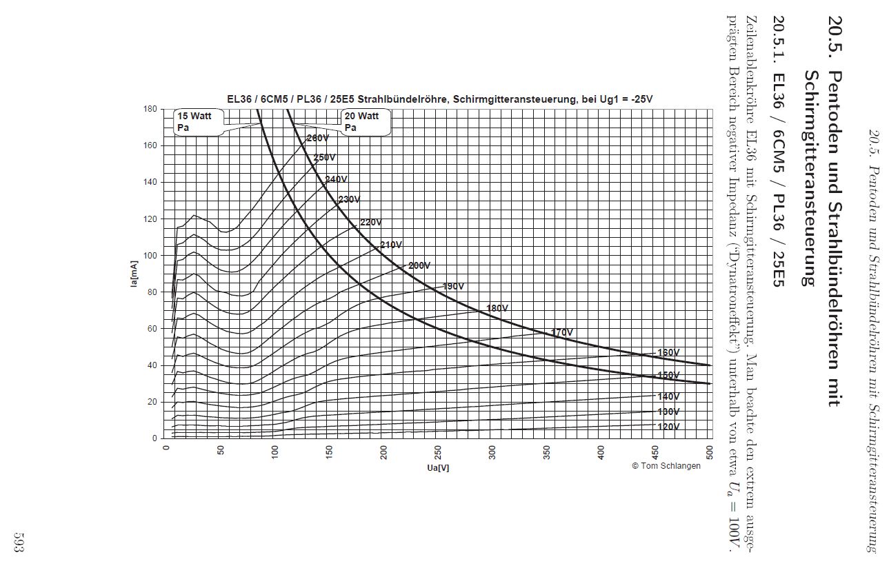

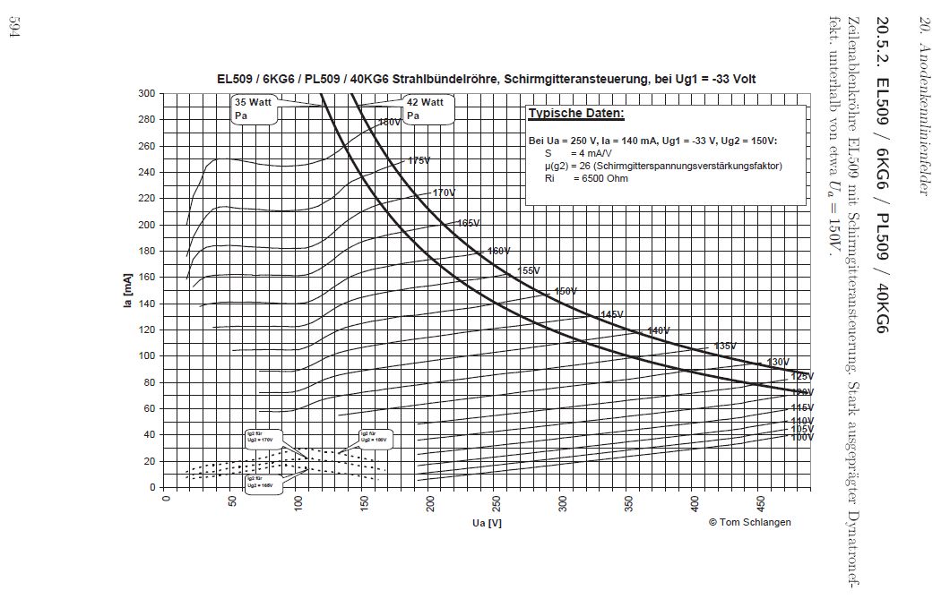

in 1998 Bob Danielak published screen drive curves for 6KG6 / EL509 with g1 prebiased to -33V in an application note for Svetlana. They looked so nice that I got sceptical and plotted (quite some samples, same and different brands) using the same conditions. As it turned out, the curves in the app note were no real plots but simulations.
You write that prebiasing g1 negatively is not a good idea. While this may be true for measuring purposes to show linearity of screen drive alone, it is a very good idea to do so to ensure stable operation conditions in real world amps.
Tim de Paravincini (google his EAR859 screen drive SE amp, circuit was published 09/1994 by Ken Kessler) held a lecture at ETF in Biezenmortel / NL (anno 2008, IIRC) about circuits using sweep tubes like EL509 for audio (including screen drive), nowadays (think 10 years back) quality and production tolerances of new production xKG6/EL509, and so on.
He insisted that g1 had to be prebiased negatively because these fat sweep tubes simply like to run away thermally, especially when operated close to their maximum Pa like in single ended amp circuits (this was not a problem within the operation conditions they were constructed for). And yes, he saw my plots.
By the way, are you doing your plots using rather fast sweeps? If so, please be aware that the tube will not heat up as it would if run f.e in rather constant Pa SE conditions. This usually makes a huge difference in real world concearning power tubes - even a with a generic EL34 or 6L6. Temperature coefficients may be positive or negative or close to zero, depending on construction, brand, charge, whatelse. In real world amps you have to deal with such issues.
Kind regards, Tom Schlangen
