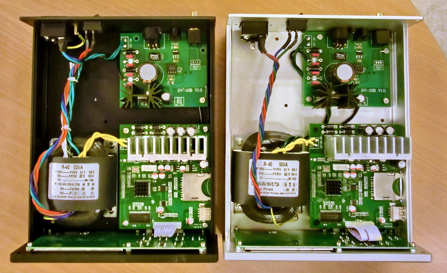

You'll be wanting something like this - takes a TF card and pumps out S/PDIF (Toslink) and I2S. Also supports BT

If you want to buy, this is what I have myself.
Used to be able to buy SPDIF output only, but now only with DAC + SPDIF out.
I have the one with AK4495 + SPDIF, very pleased after the analogue mods.
https://www.diyaudio.com/community/...-player-ess-crescendo-ii-ak4495-dv20a.285630/https://www.diyaudio.com/community/...crescendo-ii-ak4495-dv20a.285630/post-6106726
If you want to DIY, then this is one :
https://www.diyaudio.com/community/threads/ultimate-source.90725/post-3498804https://www.diyaudio.com/community/threads/ultimate-source.90725/post-3558470His site is no longer up, so I'll post his codes here.
Else look for a 2nd hand QA550.

You can see that most of the above, with the exception of the ESS Cresendo II, use a WM8804 to convert I2S to SPDIF.
Most SD card player solutions, including Rpi's, seem to favour using I2S out.
But this is one more example where it is direct SPDIF out :
https://github.com/PaulStoffregen/Audio/blob/master/examples/WavFilePlayer/WavFilePlayer.inohttps://oshpark.com/shared_projects/KcDBKHta
I am a fan of using the same clock (e.g. 256fs) to drive all.
So it rules out, for me personally, all these MCU based solutions using some other clock frequencies.
