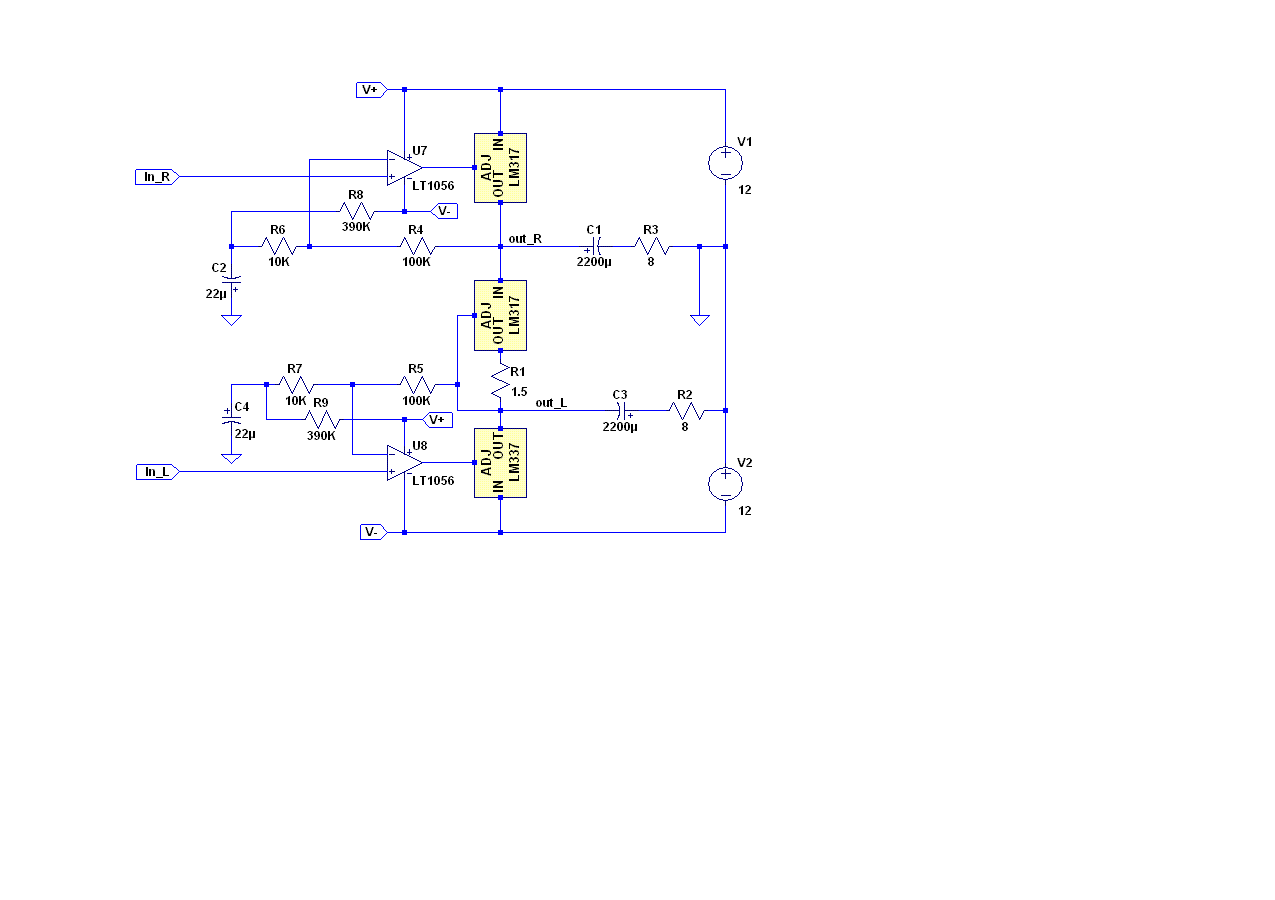

It is a (relatively) efficient class A single ended stereo amplifier utilizing the correlation between L and R channels to improve efficiency.
This one is a really top-class amplifier, boasting less than one ppm THD!
Have fun!!!

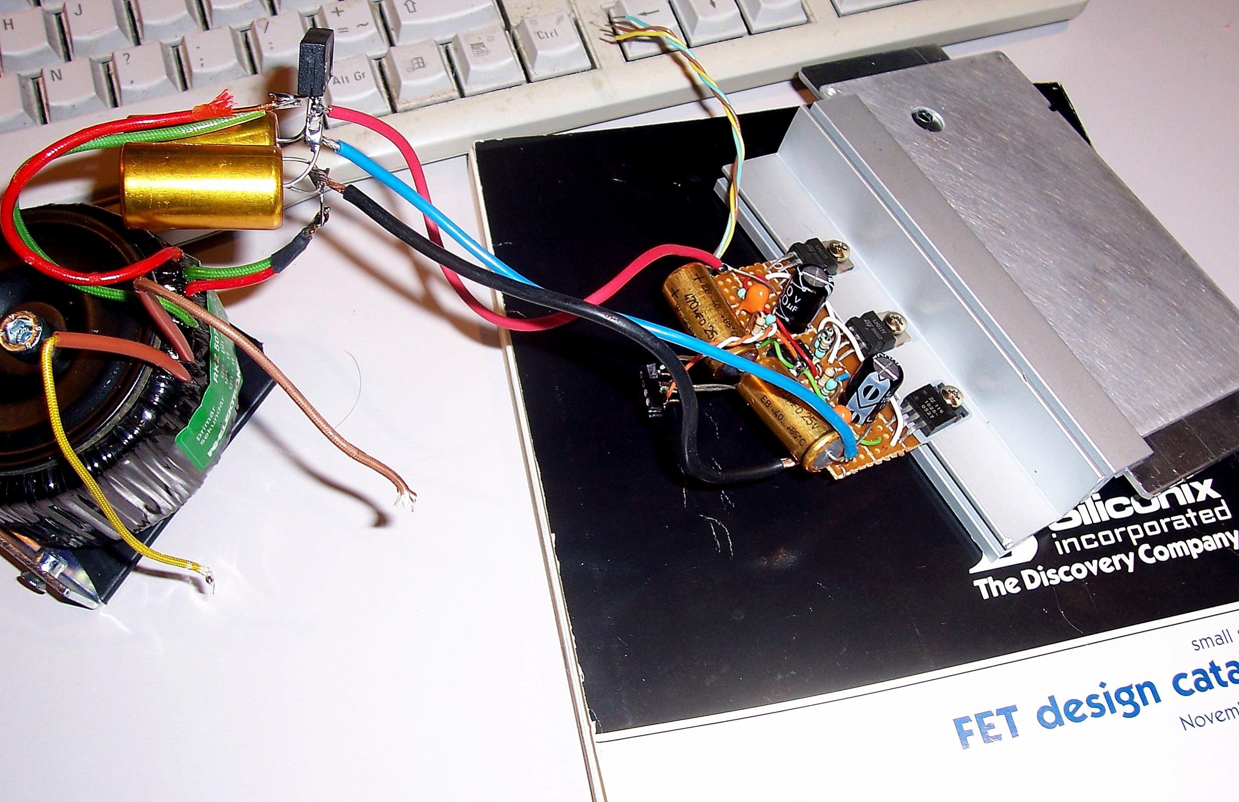

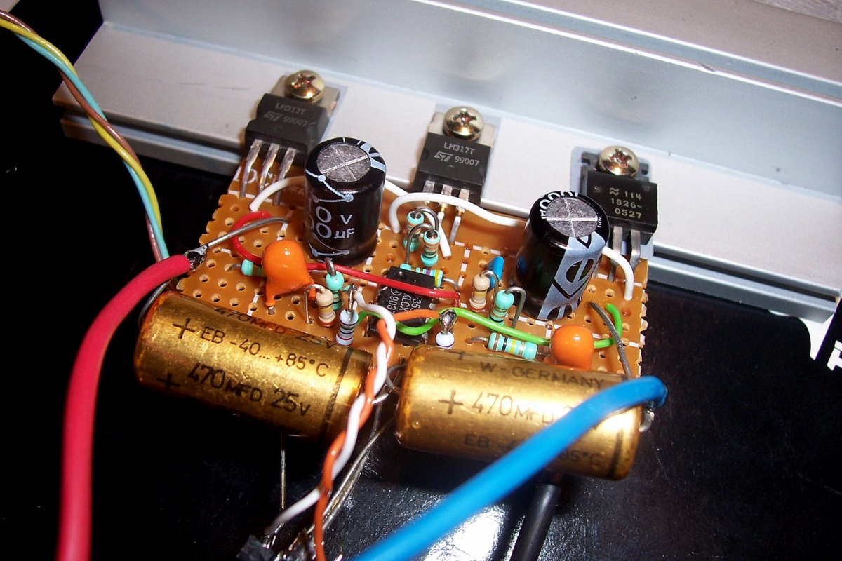

Here are pics of the prototype.
I haven't made any measurements yet.
But I used it as headphone amplifier, to check that the SE efficiency scheme had no negative impact on real audio signals.
I don't know whether I still have any bits of brain left inside my skull: the thing puts out 2.5W/ch. Sheer madness.
Anyway, the results look good: even when there is a strong stereo differentiation, there are no discernible negative effects, and the separation remains perfect.

Here are some test results. Unfortunately, my poor old ST1700B didn't let me go very far or deep into the measurements.
At 1KHz, the THD indication was the same as the noise floor of the distortion-meter itself: 0.0012%.
The residue on the oscilloscope did show some second harmonic, buried in the noise of THD-meter, but it was insufficient to influence the reading on the meter.
I can safely say that the distortion (at full power, just before clipping) is <0.001%, and probably significantly lower (but probably not as low as in the sim).
The power bandwidth extends to ~30KHz. Beyond, the waveform breaks down, probably due to insufficient SR.
The small signal bandwidth (@2Vpp output) is 140KHz.
The opamp was a LF353.
All the measurements were made with both channels in service and loaded with 8R, and receiving an identical signal.

Impressive results from a LM317/337.
What about using this circuit for a bridge mode amplifier?
This would avoid possible performance decrease due to strong differentiation of stereo Signal.
To still achieve the efficiency advantage by correlation is all to do to replace the lm317 with lm337 for correlation?
1543
1543
Why not, but you have to carefully evaluate what is to be gained by doing that.Impressive results from a LM317/337.
In SE class A, the current source determines the peak output current.
With the 317's, that's what limits the output power on 8R (bias=800mA, ~half the max current of the 317).
By bridging, you could increase the output power, but on a load larger than 8R.
Not very convenient.
There is another path to use the correlation: instead of the middle 317 used as a current source with a relatively low voltage across thanks to correlation, you could adopt a complementary scheme:
The middle regulator would be modulated by the L+R signal, and one of the channels and outputs would have its polarity reversed.
I will probably try this scheme too, but it's a bit more complicated to implement.

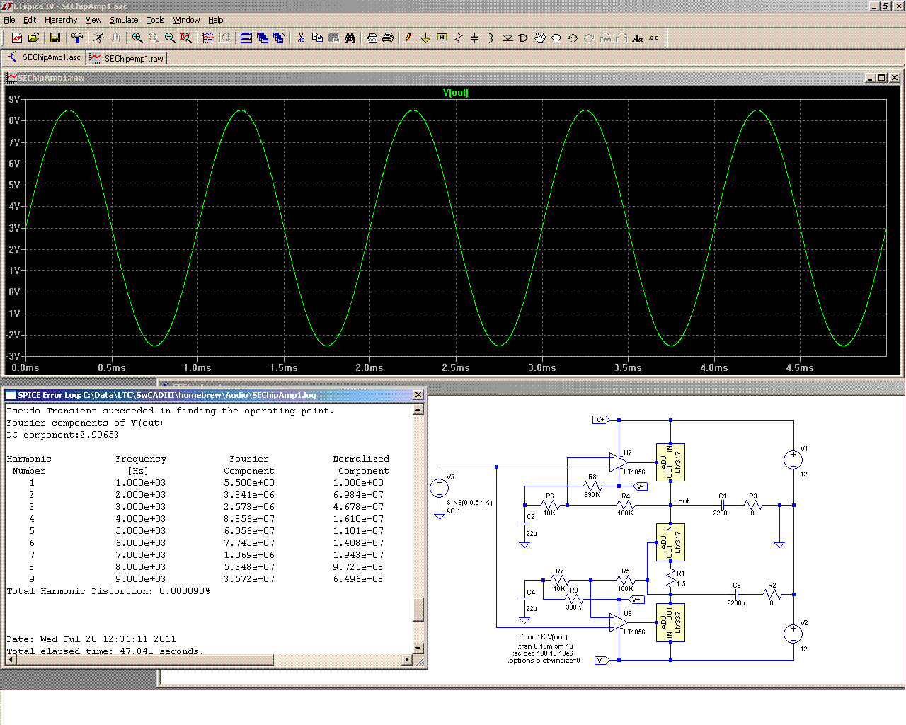

Hi, Elvee,
I tried your schematics on LTSpice, but I didn't same result.
The L channel works, but the THD is worse.
The R channel doesn't work well.

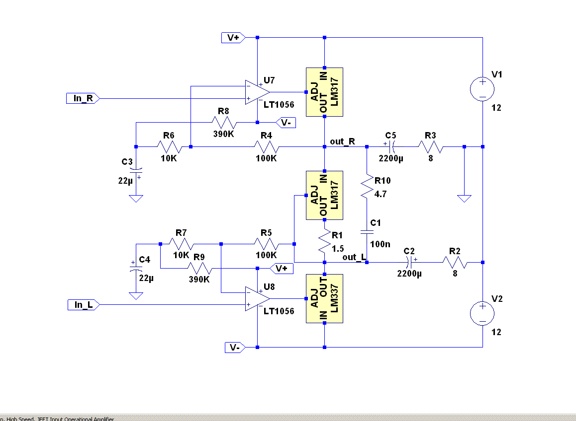

I did have problems with the 317/337 models: the ones I found seem to apply to the M versions: the current limitation happens at ~500mA, the third of what it should be.
To overcome the limitation, the trick I used was to parallel two of them.
It is not visible in my schematics, because I overlaid exactly the two operators (this gives an error message at the beginning of the sim, but I just ignore it).
Here are the sub files and the schematic:

The model that Elvee posted has a problem delivering current more than about 1/2 amp. It also didn't (for me at least) have an accurate ref voltage. I modded it slightly (after some googling) to get closer to the 1.25V ref voltage.

Hi Elvee,
I tried your circuit on LTSpice, but it didn't work well.
The L channel works well, but the THD is worse than yours.
And it doesn't get sine wave from the R channel.
I think that my models of LT317/337 are different from yours, and it make the result.
I got models from following page:
http://www.diyaudio.com/forums/parts/5025-who-can-help-spice-models-lm317-lm337.html.
Could you tell me where you get your model?
I posted my models in #12 above. Just remove the .txt to use them.
PS
And don't forget to parallel them (or use my .asc schematic, or Wintermute's fix)
I didn't look at this carefully last night. It's going to take some time to get my head around it! Could you give an explanation as to how the circuit actually works Elvee? It's a very novel approach to creating an amp!!
It is pretty simple in fact: on the schematic, just ignore the bottom regulator for the moment (suppose Out L is connected to the negative rail).
The upper regulator will act as a follower (common collector or drain): its Out will follow closely the Adj terminal, it will always be 1.25V higher.
The regulator can be seen as a depletion device having a very sharp transconductance.
The bottom regulator is wired as a current sink, and the combination of the two forms a classic single-ended follower, but having a much higher accuracy than what a discrete device could achieve: in a BJT for instance, the Vbe is modulated by the emitter current, and this causes non-linearities and a non-zero output impedance.
The follower made from the two regulator is almost perfect.
But on top of that, it is included in a loop with the opamp, whose role is to further improve the linearity, and provide voltage gain.
Now, here is the original stuff:
SE amplifiers are notoriously inefficient.
Here, the current source/sink is put in common between the two channels, and the voltage one needs to apply across it doesn't need to cover the full output swing of the outputs: since in a stereo system, the L and R signals are largely correlated, the two outputs will move in a synchronous manner, and that means the current source needs much less voltage headroom than if two completely separate amplifiers were constructed.
This means that the amplifier is not capable of providing its full output power when the two channels are completely uncorrelated, but this rarely happens, and the combination of the two situations is even rarer.
It does work in practice, I have listened to it extensively, on real audio signals, and I have never noticed any clipping, even when there was a strong stereo differentiation.
