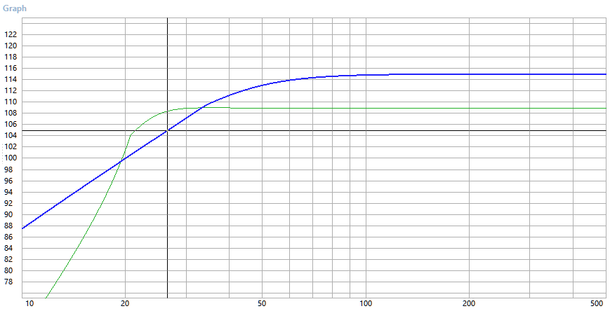

So I'm trying to work through various builds, with a specific size requirements (need 12" wide, and tall enough to use as stands). This is my first sub build.
I prefer a tight bass. I plan on using it for mostly music and tv, with the odd movie thrown in. I don't need earth shattering 20hz thx level bass.
Right now I'm modeling the Dayton RSS265HF-4. I want to go sealed but I worry that it wont be sufficient in my moderately sized living room. I want to build the sub so that I can stuff a sock in the inside or outside opening of the port to go sealed, but have to option to run ported as well. This will be my only chance at building a box, as I will no longer have access to a shop in a few months.
Gonna use a minidsp 2x4hd and Crown XLS 1502.
PORTED
2 cu ft gross enclosure
3" x 20" port, tuned to 22hz
1.6cu ft net (port/driver volume)
Cone excursion and port velocity will require a filter -4db filter @20hz
After filter - Expected f3 28hz f6 23hz
SEALED
Sock on the outside: 1.85cu ft
QTC: 0.656 - 38.68 Fsc
F3 42hz
F6 31hz
Sock in the inside: 1.6cu ft
QTC: 0.680 - 46hz Fsc
F3 42hz
F6 31hz
1. Is a stupid idea?
2. I can't decide between the Dayton RSS265HF-4 or CSS SDX10, they model very similarly. The dayton has a little more sealed SPL, but the CSS has more excursion head room. The CSS also has 4m/s higher port velocity with a 3" x 15" port tuned to 26hz. The spl between the 2 drivers track identically in WINISD. I don't know which driver to pick 🙁
Thanks!!!

i would say Qtc between 0,656 and 0,68 is quite OK for a closed, linkwitz-transformed (via DSP) box.Once you plug the sub ports there is no way to decrease cabinet volume for optimum sealed performance.
eventually you could even go bigger.
i suggest you just try it, as you are free to do program the DSP based on your in-room measurements.
once you are happy with one solution you will probably keep it.
you can then also optimize stuffing for the box: complete/much stuffing for closed box, few or none for a bass reflex box.
some more considerations:
a 20" port seems huge!
and a sock will probably not be very air-tight. you should consider some kind of rubber plug, unless you want a aperiodic box.
by the way: the difference between plugging the port on inside or outside is probably so small that it's not worth having both options.

Unfortunately I can't go bigger with the box. I was aiming for a qtc 0.7. Also, is there any issues with using a 20" port? The sub is going to be 25" tall to be used as stands for bookshelf speakers.
I was playing with winisd, and when I boosted the sealed box the group delay gets much worse. This also happens when I model a high pass filter. Is that accurate? I was trying to avoid boosting the selaed box because of that.

I think you should not go sealed and smaller, your suggested volume and qtc seems perfect. Again, that's just my two cents.
You could equalize with linkwitz transform and move group delay down in frequency as much as you want. I really suggest you try it out, ported, closed, equalized and find out what works for you.
Is this post related to this one? If so especially (and even if not), I would recommend a sealed subwoofer for music playback even more if you say yourself that you don't need 20hz thx bass which is seldom found in most music people listen to. I personally wouldn't consider a ported subwoofer because;
I also would advice to buy a different subwoofer as the l26roy has way better performance (especially in the distortion department) for just a bit more money; than the sdx10 (https://audioxpress.com/article/test-bench-the-sdx10-home-audio-woofer-from-css-audio) vs l26roy (https://audioxpress.com/article/test-bench-the-l26roy-10-subwoofer-from-seas). It also has the cone break up higher than the dayton which would be beneficial if you want to cross it over high(er) with a slow slope (first order). I have personally good experience with Seas drivers and enjoyed listening to it in a commercial speaker (grimm ls1be + subs) and I personally don't know anything better or as good (besides scanspeak maybe which I would also recommend) in this size for use between 30-250hz, others may be cheaper or produce a bit more lower bass, but are lacking in performance at mid(bass) frequencies and have often higher distortion.

Edit: thanks for the link to the paper! I'm definitely leaning hard towards sealed. But I still need to find something that works well into 1.5 to 1.75cu ft net.
It is perfectly fine for both applications, in my opnion it models just as good if not better than other comparable sealed aswell as ported subwoofers I've seen.Seems like the l26roy is good for ported? will it work sealed?
It is just as good (or bad if you think it is) as any other subwoofer, I would say even better as the cone breakup is higher than most subwoofers. The slow rise of 1/2db is easily compensated when using any lowpass. Wouldn't worry about it...The response will need some equalization up higher but I have a minidsp
A single ported l26roy works in that size cabinet, which I wouldn't do but if you want it, if you would want to use as much space as you can for more bass, in a sealed configuration just add another l26 for more bass and your at the same internal size. This is the max spl you get for both configs (I would imagine that comparable woofers would simulate pretty similar) blue is 2x l26roy sealed and green one ported; The 2x sealed has more usable spl at frequencies often seen in most music.But I still need to find something that works well into 1.5 to 1.75cu ft net.
I never did :-Dwhy do you recommend going smaller?
Wasabii did.
You ccould go slightly smaller to get a 0,7 Qtc max flat closed box but 0,6 is not much different (and goes slightly lower).
If you have miniDSP and are considering sealed, more displacement is your friend. Model it in your given box size to ensure you can drive it to xmax with the available power, and without exceeding the driver's thermal limit. Don't worry so much about Qtc since you can Linkwitz transform the response to the Q you want using DSP.Any thoughts on side mounted subwoofers? This can let me go up to a 12 inch, or even 15" if I really push it.
