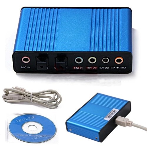

The sampling rate determines what you can get away with. If you need no more than 16 bit @ 48kHz, a CM108 USB soundcard will suffice for the input. They are dirt cheap. You can get them delivered for less than $15 via aliexpress. Search for "usb 5.1" and one of these will come up.
S/PDIF will work flawlessly, just don't expect anything at all from the analog side. It's horrible. But for digital audio up to 16 bit 48k you'll be fine.

I can second the cheap CM106 based (blue) interface shown just above. I was just playing around with one yesterday. I think they cost all of US$15, possibly less. Only has toslink spdif input (no coax) but it works fine at 44.1/48k.

I never got the 44.1kHz TOSLINK capture right on my CM108. But maybe my piece is broken, anyone positive practical experience?
