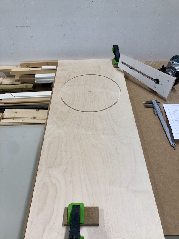

I've just started my project «SEAS A26 floor stander». Pretty much like the SEAS recommendation, but the height is extended to 85cm. 18mm BB plywood with bracings.
Considering making the rear wall removable with sealing and screws. It would be easier to experiment with damping material. In addition, I can go for M5 machine screws for attaching the woofer. Any views on this?
