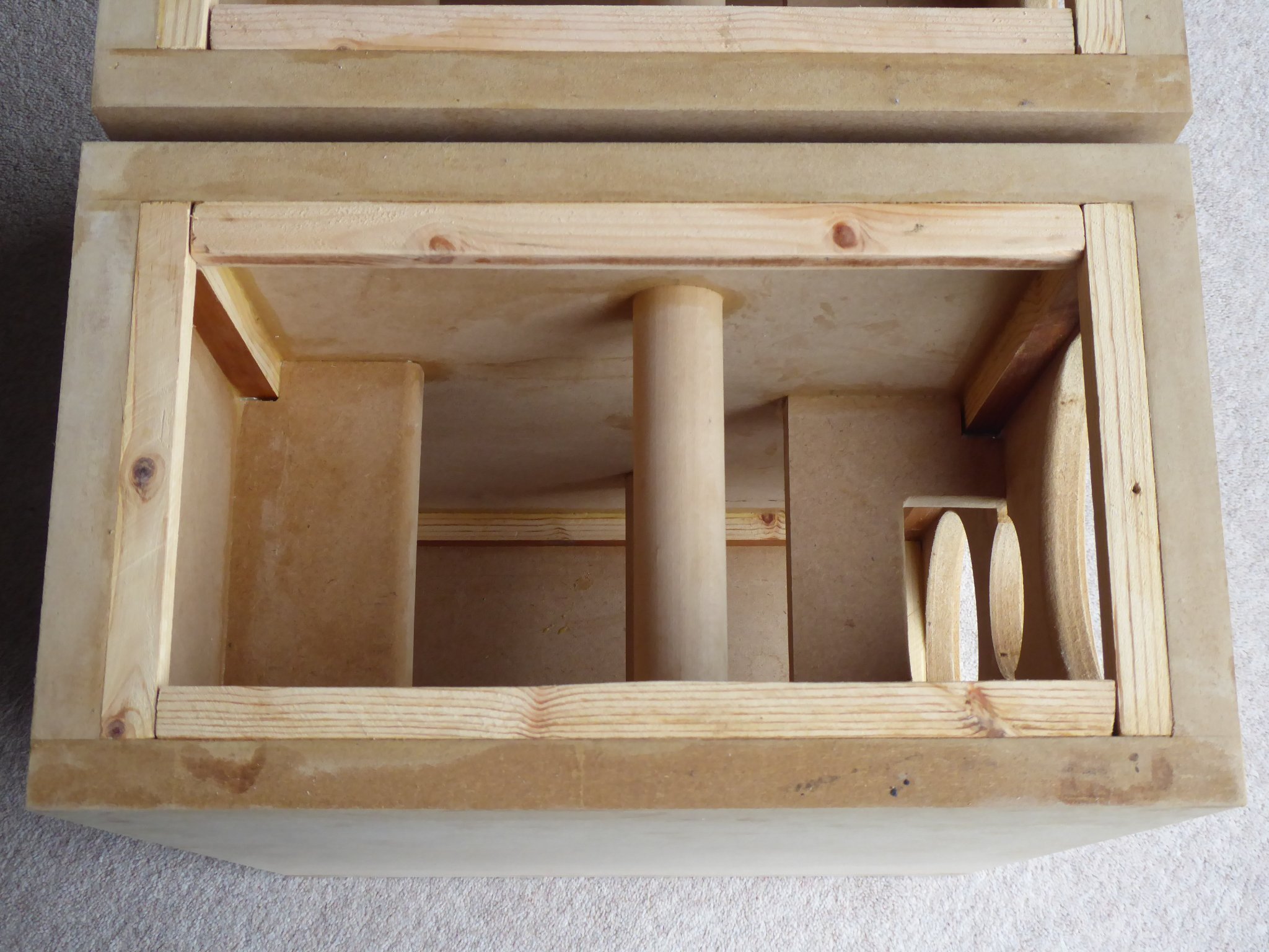

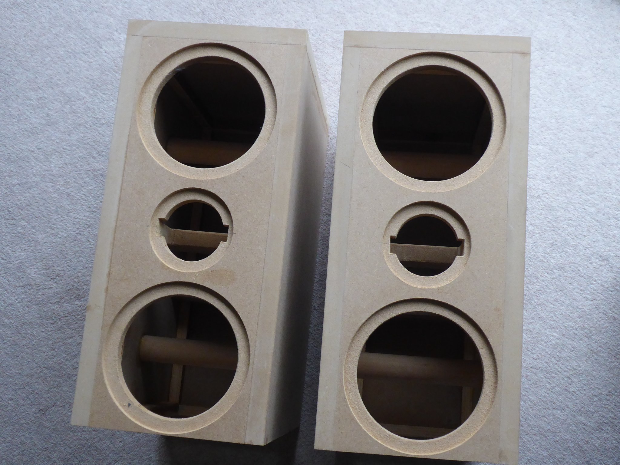

Hi All. I completed my Idunn upgrade to the Bragi Design. I've measured the responses and was amazed how flat the response is, ... well it is above 200hz, nearly ruler flat and most times, it sounds like it on classical and jazz. I say sometimes, but surprisingly, with cd recordings of "pop" style music it can sound very aggressive or just plain "wrong" and you would imagine the response is rising steeply upwards. I realise "pop" music and the like is not accurately recorded and maybe the speaker's low distortion and accuracy is ruthless in showing up the flaws. From the frequency plots, there seems to something wrong below 200Hz as the response falls away but listening it can sound bass heavy. Maybe the tuning is too low, it needs more UPPER bass rather than deep bass....Yes I realise they are close to the wall so maybe I'll show some plots after moving the speakers well into the room. PS the response is at around 1m at tweeter height, but I can move the mic around quite a bit with very little change in the flat response, quite amazing, I think.

Have you tried position changes? It's tedious, but moving the speaker 1cm here or there from the room boundaries can make a difference. Looks a bit close to the rear wall from your photo.
I agree the next way to go is to lift the tuning, and maybe experiment with a little stuffing. I'm a bit iffy on the DXT, but that's a can of worms. Your speaker cabinets look great, though!

Hi Motokok. Thanks for your suggestions... I agree they are too near but although I have a pretty large room this is really the only place I can put them, due to the entrance door and large patio types windows. I will do as you suggest though and ideally I would want them out at least a couple of feet from the wall but they would sort of get in the way, I will move them out some more though, and as said, move them right out for further testing. If it was summer, I would take them outside to measure the response and see what they are producing at the bass end. The other thing are the stands, they are far too lightweight, and I will be making a concrete filled tube stand to support them. This alone will, I'm sure, give more definition due to the shear rigidity (will photograph the design and show it later). As said with good recordings, the flat response and very low distortion gives the sound an electrostatic type quality. It could be this quality that highlights any shortcomings with the bass speed. I actually find the DXT merges to the U18 seamlessly and I've never heard any sibilance at all. It's a tweeter you just don't "hear" but it always seems to produce the correct tone and detail of any HF detail that's on the source. The response plot shows it's there with little distortion too. Thanks for the cabinet compliment. It's made in 22mm thick heavy grade MDF. and braced with 35 mm hardwood dowels and corner bracing at all intersections. I only used a single sheet of front baffle because, as you can see, the edges of the drivers are in fact held by the cabinet sides and cannot be any stiffer. The 22mm thick baffle also avoids closing in the rears of the bass drivers too. If I could do the veneering again, I could do it better. I learned a lot about veneering doing this speaker. It's relatively simple to do surprisingly. Biggest mistake was not using enough PVA glue for the "iron it on" method. Will update periodically when things transpire worth mentioning. thanks again 🙂PS: The cabinet front picture is without the final bottom side in place.... I had to get access to fit the bracing stuff.

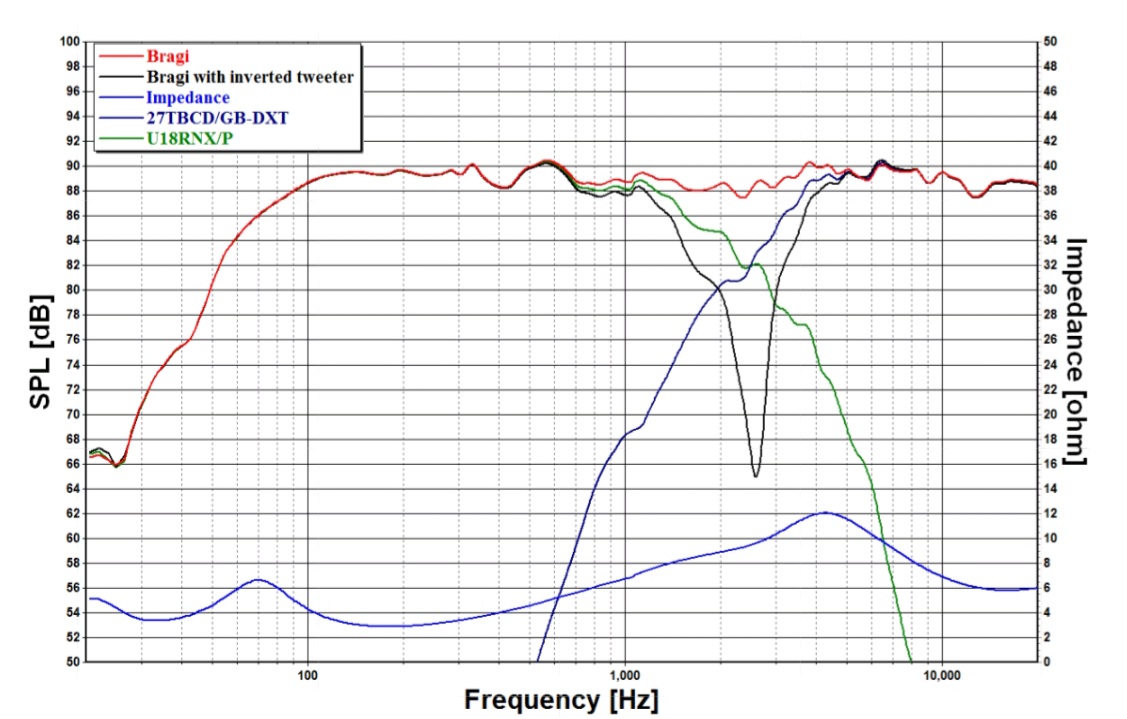

The MTM design principle is very suited to mid field monitoring. The crossover point is critical to its performance, whether significant lobing occurs in a detrimental place. I used to build smaller MTMs with a strategic crossover around 3.5 k to take advantage of the naturally occurring fletcher munson dip in human hearing, which also allowed a large percentage of the most important midrange band to be reproduced by the cone drivers. Obviously lobing is a bad thing, but sometimes it can be used to one's advantage. A slight reduction of average power response (increasing directivity) in the 2.5 - 5 k band significantly improves perceived vocal clarity and intelligibility, especially at higher playback levels.
The human ear senses FR very non-linear across the entire audible bandwidth, but the 2.5 - 5 k window is exceptionally important, always requiring some minute amount of attenuation to present a perceived neutral FR to the ears. This is in addition to and beyond the usual bass lift found in your typical loudness compensation circuit and has to be dealt with separately. The ear and brain can't isolate this small frequency window on its own, being its such a narrow part of the whole audible frequency range. Its energy balance and proportionality to the rest of the audio band is critical. The exact amount of reduction compensation required is quite subtle and constantly varies by average SPL.
The Seas Braagi kit has a crossover point slightly shy of 3k, close to the frequency range discussed above. This is a big reason why these speakers sound so accurate and natural. The curves below show what I'm getting at. The impedance still continues to rise due to the tweeter WG narrowing directivity at crossover, providing higher sensitivity towards its lower cutoff. This reduces off axis energy around the 3k mid band, improving midrange neutrality across the entire listening window. The fairly constant directivity curve helps here as well.
So is this a studio monitor grade speaker? Yes, absolutely. Most speakers with midrange dips aren't capable of neutral midrange having some amount of mid band coloration, hyped bass and/or treble, usually having all three of these.

I have moved the speakers well away from the rear wall and the sound now cannot hardly be bettered, although I will still carry on with experimentation and making the new heavyweight stands
Great to hear. Dunno if you have interest in the idea, but one option might be to redo the cabinets for a front port below the lower woofer, reducing the depth accordingly to maintain the original internal volume. Should help in both regards for your room placement constraints, but a bit of an effort.
