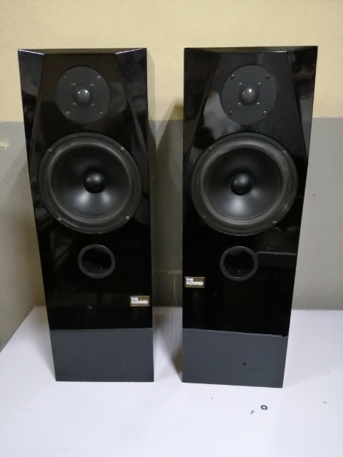

Hi guys,
That is the Neon model, from the "Seas Sound" range of speaker kits of the late 80's. There's practically no info about it online, but it can be seen in this Norwegian ad from 1989. The 3-way Argon model, of which I own a pair, received an MkII update a couple of years later, where the H398 (25TAF/G) tweeter was replaced with H534 (25TAF/D). I assume the same update applied to the Neon and Helium models too.
The characteristic cabinet shape helps reduce baffle edge diffraction, and ready-made MDF cabinets for all models were available. Front covers were made from profile-cut foam, and usually attached with Velcro, but would sadly not last for long before starting to disintegrate. The woofer is mostly identical to the H296 (P21REX/DD), but equipped with a smaller dust cap made of soft PVC.

thank you very much for the answers. I liked to make some root boxes using these speakers. what's the best box I can make? thanks in advance

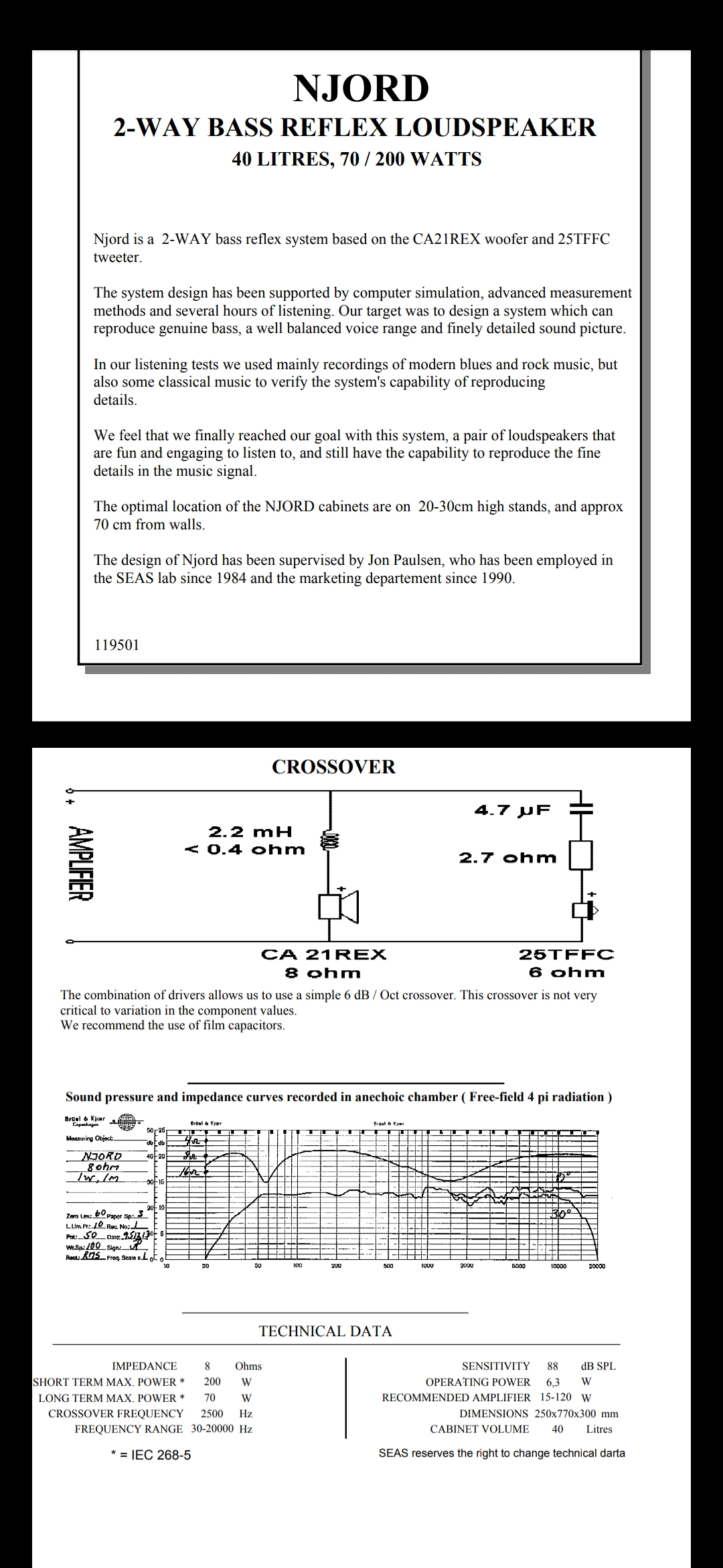

As vassilus1984 said, these do have an uncanny resemblance to the old SEAS Njord kit:
Not the last word in sophistication, but you could probably find newer drivers that do much the same thing: SEAS: The Art Of Sound Perfection.

The Neon and the Njord have obvious similarities, but the difference is in the details. I may be nitpicking, but hopefully all for the sake of nuance and clarity! 😉
The "Seas Sound" range of speaker kits was developed in 1987/88, and consisted of three models: The bookshelf-sized (12 l) 6"+1" Helium, the floorstanding (I'm guessing 30-35 l) 8"+1" Neon, and the full-sized (70 l) 10"+3"+1" Argon. The idea behind these kits was to showcase Seas' latest technologies, and the floorstanders were fitted with the then-new aluminium dome H398 tweeter. The woofers were all polypropylene cones, and the smaller two had dust caps made of soft PVC for smoother response in the crossover region. The larger two were equipped with Seas' patented Dynamic Damping voice coils. Although I don't have the schematics, I suspect that the crossovers were at least 2nd order.
Ready-made cabinets were available for all three models, as Seas had a long tradition of cooperating with local furniture makers. These were made from 19mm MDF, and the characteristic bevelled baffles were a further development of a studio monitor design Seas did in the late 70s. Evershumi's speakers seems to have different bevel angles than the ones I've seen before (the original design had the bevels going very close to the tweeter), so they are probably DIY. MkII versions were fitted with improved H534 tweeters, which had a "diffuser" ring in front of the dome, instead of the mesh grid and phase disc of the earlier type. They also included bi-wiring terminals, bitumen pads on critical internal surfaces, and spikes for the floorstanders.
The "Seas Sound" branding was also used on the cardboard sleeve-covered polystyrene boxes, in which Seas drivers were shipped from the factory. The metal badges seen on the front of evershumi's speakers, however, only came with the kits. Here's a close-up of my own Argons:
The Embla and Njord models are much more recent than the speakers in question (the response measurements in the brochures are dated december '95). I actually built the Njord myself - or rather a smaller-box version of it - before starting my studies in the late 90's. Seas' product range had bifurcated by this time, with the introduction of the Excel-series of drivers in 1994/95. From that, the kit design philosophy also went in two different directions: The highly advanced and costly Excel-based kits (Odin, Froy, etc.), and the comparatively simplistic Embla and Njord kits based on affordable standard drivers. While the Embla is very similar to the Helium model in terms of size and driver technology, the Njord design represents a return to the "old-school" philosophy compared to the Neon. Gone is all the new-fangled stuff, and in comes the classic coated-paper 8" and fabric dome tweeter again.

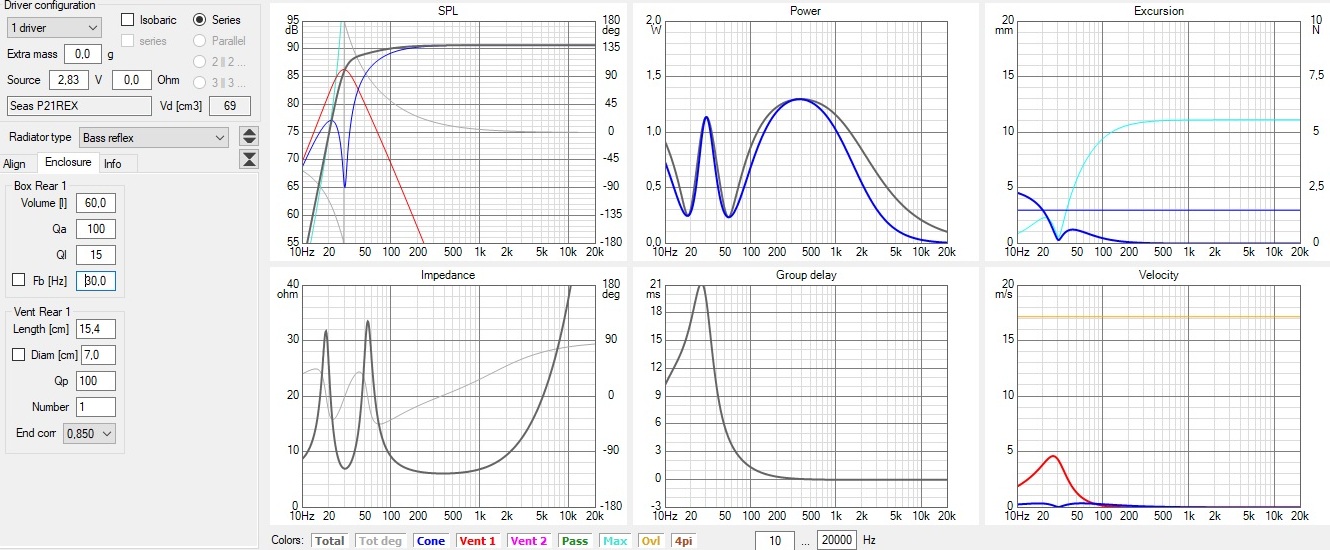

I would like to build some larger columns 60 l 30Hz. does someone more knowledgeable have the availability to do a simulation for this speaker? thank you

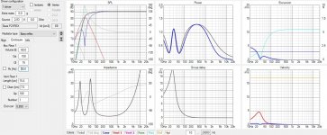

Here's two sets of curves for you to compare. First, a 35 l / 30 Hz reflex box (although the Neons are probably tuned quite a bit higher):
Then my 60 l / 30 Hz suggestion:
The port dimensions can be seen to the left of the curves. By increasing the box volume, the -3dB point has moved from above 45 Hz down into the low-30's. When increasing the signal to 100 dB SPL @ 1m (not shown), the 7 cm diameter port is still turbulence-free, and the woofer still close to its linear excursion range above the tuning frequency. There's still some headroom, but filtering out the extreme low-end (<30 Hz) may become necessary if you want to play very loud. After all, there are limits to what a single 8" can do.
Hope this helps! 🙂

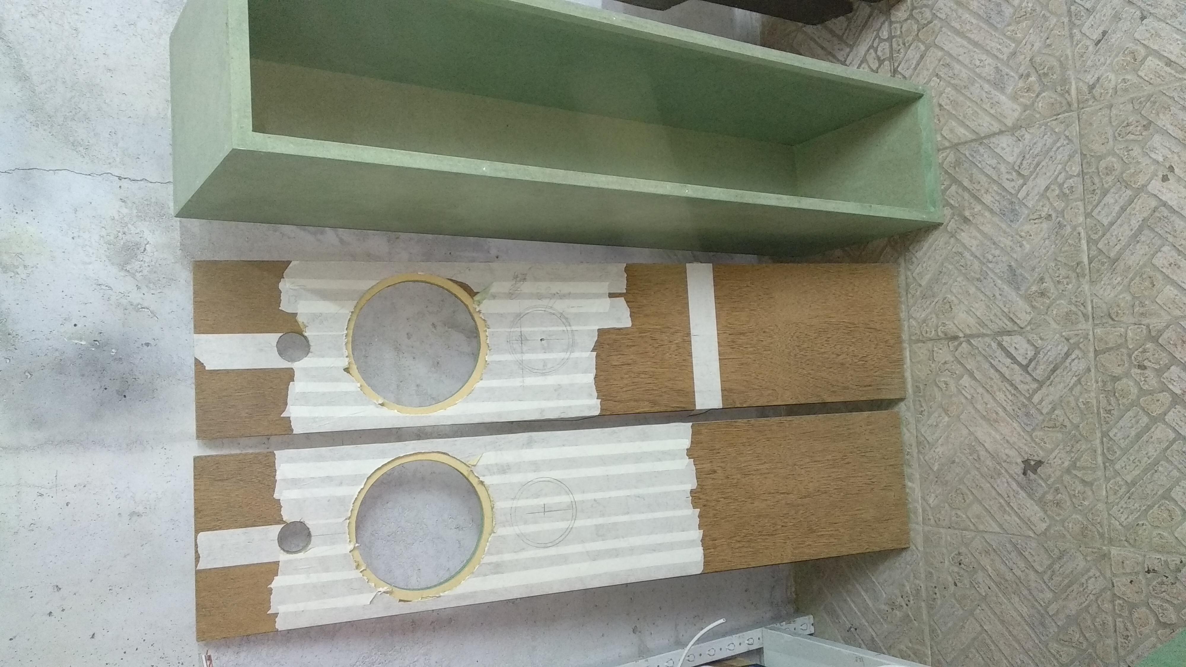

thanks for the simulation. was thinking about using frontal vents or down, does the simulation change? how to line the box? acoustic sponge or polyfill? Thank you for your help
The simulations do not take vent placement into account. Aside from the main port resonance, the behaviour will depend on the internal damping, the exact dimensions of the box, etc. Port location will also determine its coupling to standing waves inside the box.
A front vent is often thought to make pipe resonances more noticeable, but I think the difference is small in practice. The same applies to downward ports, although may give more unpredictable results. In the latter case, you need floor clearance to avoid obstructing the vent, and a good rule-of-thumb is to keep it at least equal to the vent diameter.
I typically line the rear, sides, top and bottom with 1-2" foam or 2-4" fibreglass/mineral wool, depending on size and how much room that leaves inside. I always leave the baffle bare, and also make sure the inner opening of the vent is free.

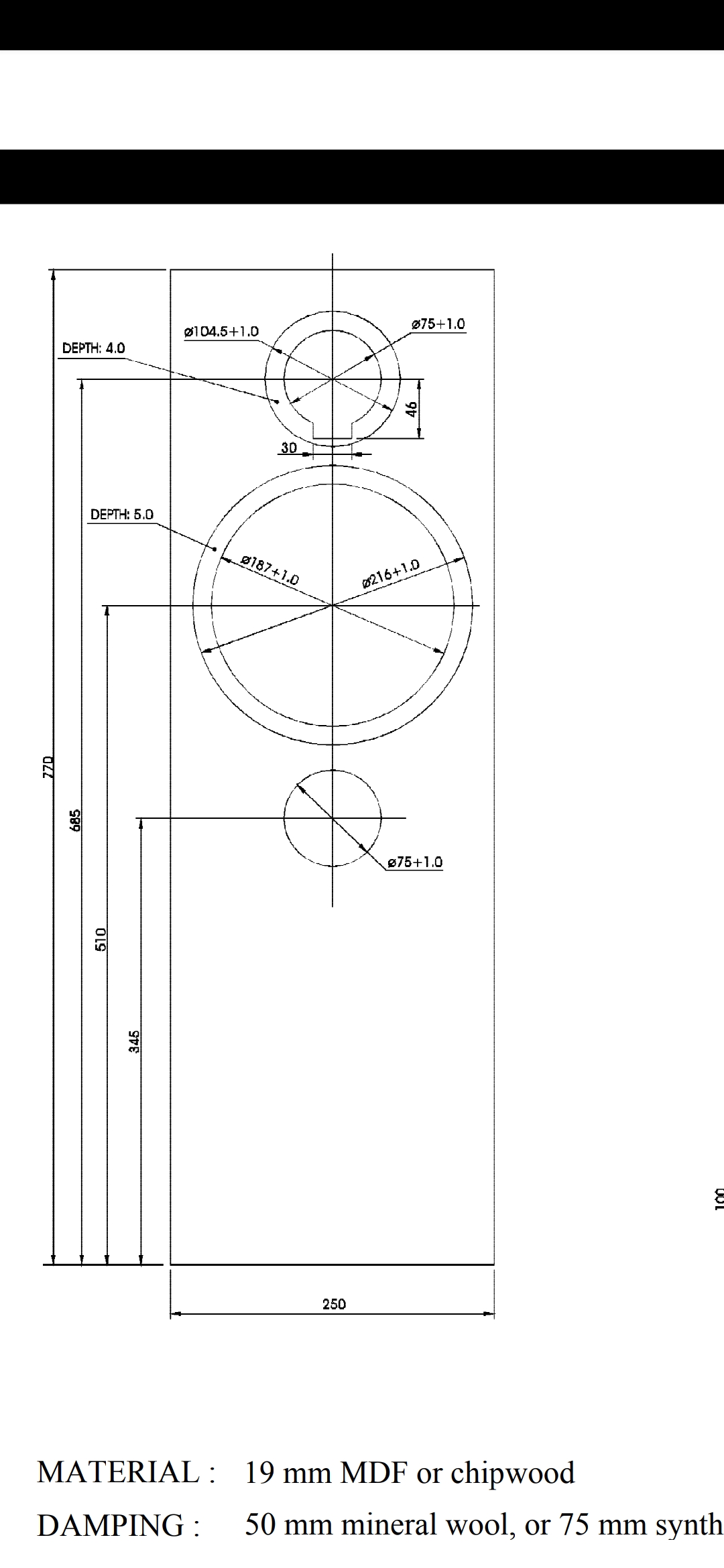

the box was thinking of doing with these measures. 104x25x34cm with 19mm MDF with internal reinforcement. the port I can get has the dimensions, 70mmx150mm. where would be the best location for the port?
There's a nice calculator here, which allows you to find the standing wave frequencies of your proposed box. The ones determined by width and depth are going to be high enough in frequency, that they can be effectively dealt with by the lining/stuffing, especially immediately behind the woofer. The more problematic standing waves in a tall box like this are going to be those determined by its internal height, because these will be low enough in frequency that the lining/stuffing won't be very effective.
At 1 meter height, the first mode will be located around 170 Hz, the next one at twice that frequency, then three times the frequency, etc. You would ideally place both the woofer and the port where exitation is the least, but that point won't be the same for all standing waves. I'd suggest mounting both at ~1/4-length along the cabinet height, as that should at least reduce the first two modes.
Additionally, you can place a circumferential brace at the midpoint of the cabinet, and put a good amount of dense stuffing in the centre opening of the brace. Both the woofer and the port has to be mounted on the same side of this "subdivision", but this will reduce most of the height modes.
