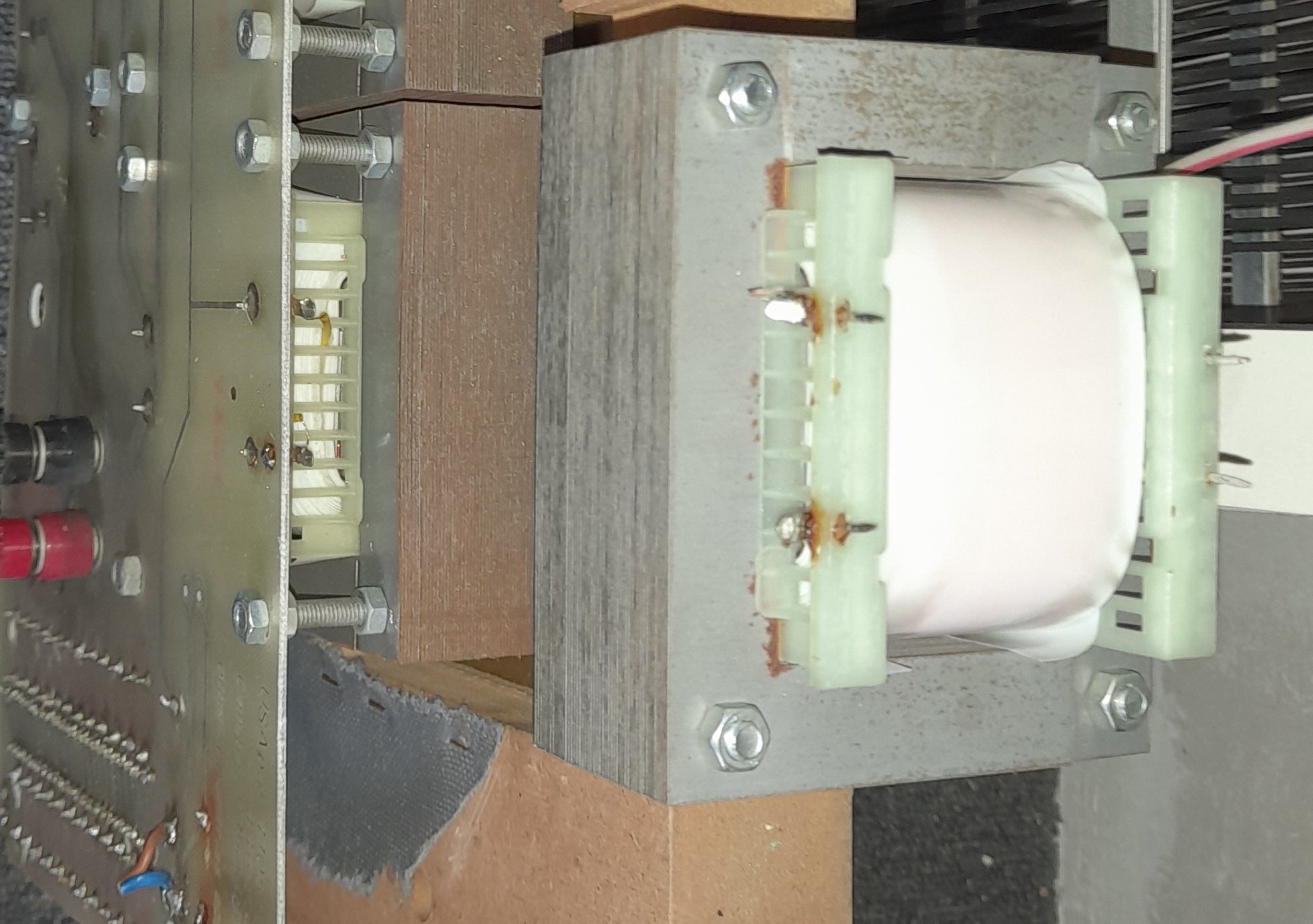

Having made some electrostatic panels for headphones in the past I thought well lets play, when I saw a pair of Audiostatic ES300R for 100 Euro claiming they needed new panels just 70km from my flat in Hamburg Germany.
When I got home I stupidly plugged them both in and the second one went BANG and set of the circuit breaker in my flat, so I left that speaker to later. The other played but clicked, around about once a minute. After a little while I realized the clicks where coming from the moving coil speaker on the other channel. Removing the electrostatic speaker connections from the amp removed the sound. So some how the Electrostatic speaker is making sound in the moving coil speakers through the Quad 306.

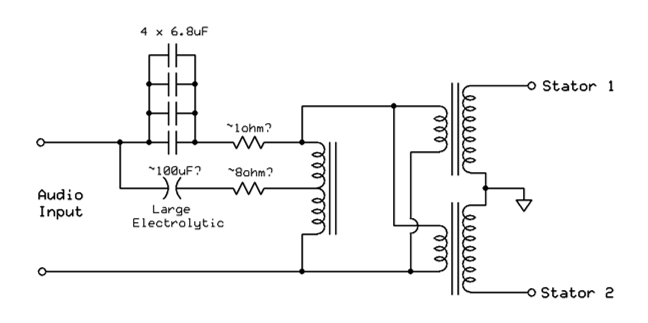

I guess this could be due to the mains voltage direct coupled and arcing (hopefully not in the output trafos), so upsetting the Quad 306 Amp? Any suggestions or tests I can do are very welcome.
I found some circuits here in DIY audio that are approximately correct for the Audiostatic ES300R (Resistor and capacitor values differ in the driver circuit but the voltage doubler is identical). Thanks to bolserst for the doubler circuit and maudio for the Audiostatic ES300 driver circuit that I stole from other threads in DIY audio and attached here.
The speaker that went BANG had a loose connection on the mains wire, and has obviously done it before, and taken out quiet a few of the PCB tracks near the mains connection. This still was not a killer but, sadly on further investigating one of the 2 stator driving transformers is open circuit on its secondary.
So although the Audiostatic ES300R pannel and stators looks rather well made I am not so impressed with the electro mechanical side. No detachable mains lead, no issolation transformer for the high voltages, no fuses, no screw terminals on the PCB, not even PCB pins, just bare mains wires soldered into the PCB.
As for the sound from the one working speaker the sensitivity is much lower than a Quad ESL63. Subjectively it has a similar quality to the highs and midrange, posibly even better, but I am guessing here but 300Hz and lower seem non existent. The capcitors in the Audiostatic ES300R mention west germany so I suspect they would need to be replaced.
So I probably will give up renewing the speakers, unless some one can sell me a driver transformer cheap, and instead I will sell the transformers cheap.

The transformer was likely killed by overdriving them. The common failure mode is that the membrane coating goes bad, causing sensitivity to drop slowly over time. The owner corrects for this by gradually cranking up the volume until the output becomes too low to be useful if you're lucky. Or until a transformer fails...
They will need new membranes for sure. Don't let the current sound quality of the other panel fool you, with bad coating it will be nowhere near what these are capable of and tonal balance will be way off. In good condition these esl's are among the best out there are. Imho much better than the Quad 63. They are truly worth a rebuild.
It shouldn't be too hard to source a replacement transformer. Try your favorite local internet market place, or place a wanted ad. Or try companies that rebuild them. Maybe Audiostatic itself still stocks them, give them a call.

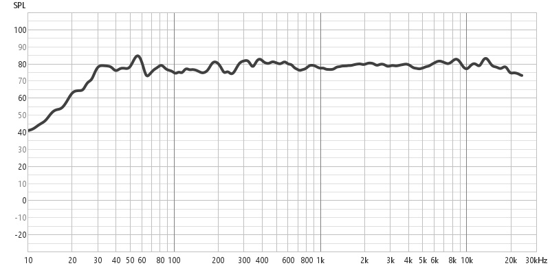

Yes, high frequencies of quad rolls off well below 20 kHz. Lots of stuff between mylar and ears as well. Audiostatics wire design stator literally opens up. Each his own.pick ofcourse
Not if you do a correct rebuild with 3 micron Mylan and the right coating, not the heavy graphite stuff that makes total diaphragm 9-12 micron thick.
Quad ESL-63 with 1/6 octave smoothing.

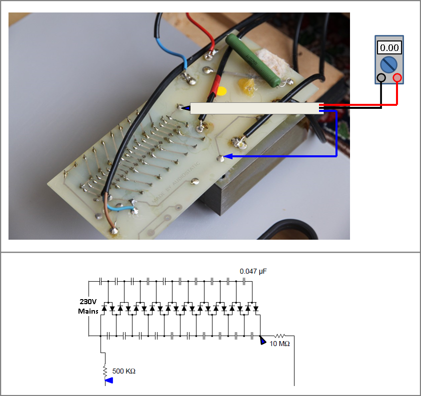

- Add a 1 Euro "Neon bulb" between the diaphragm and the voltage doubler the charges it. This will light up when ever it delivers about 70 Volts. This also give a fair warning about the health of your speakers. So 1 Euro to avoid the common "the transformer was likely killed by overdriving them" problem maudio reports.

This graph tlooks reasonable as the vertical scale is very compressed. It stills rolls off after 15 kHz like the Stereophile measurement. Maybe yours are slightly better, I have to look up the Stereophile measurement

In fact, when overdriving an Audiostatic the transformer insulation will fail before the panel will arc. As you found out already...
To the topicstarter; sometimes they offer srcond hand transformers. Currently on the site 'marktplaats'. I guess audiostatic uses the same 1:75 transformer so if they are from an ES100 (like the ones on marktplaats) they should be fine in the ES300 as well. . Bass auto transformers are rarely offered so I hope that it needs no replacement

Such a neon oscillator gives an indication of the amount of charge current flowing to the panel, which is a good indicator of the amount of leakage of the panel.Add a 1 Euro "Neon bulb" between the diaphragm and the voltage doubler the charges it. This will light up when ever it delivers about 70 Volts. This also give a fair warning about the health of your speakers. So 1 Euro to avoid the common "the transformer was likely killed by overdriving them" problem maudio reports.
However when the coating degrades and loses conductivity, the panel will not leak more and therefore such a neon indicator will not warn you for a bad coating. Better keep an eye on the volume setting.
I think the "Neon bulb" between the diaphragm and the voltage doubler the charges it, provides great benefit on my Quad ESL 63's and I fitted them to my home made headphones. You have an interesting worry that the coating degrading would make this useless maudio.
