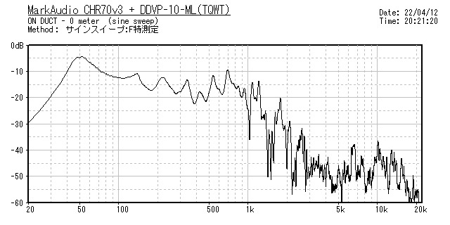

Hi maillard,
As for the bass, I don't know because everyone feels differently.
However, the duct is producing enough bass even at 4inch driver.
I think orchestral reproduction needs to be 5.5inch or more to have enough grandeur and sound pressure.
