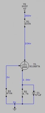

After soliciting advice in an earlier thread for different ways to add negative feedback to a simple 12ax7 amplification stage, I think I now know how to better direct my questioning.
I have attached sketches of two different circuits. The first one is the known-good single triode stage. It is directly-coupled to a rudimentary electrostatic speaker of unspecified impedance (hence the high DC offset). But for the fact that it requires a bit more drive voltage than my smartphone can provide, it does everything I need it to.
In the spirit of eliminating the separate drive amplifier (a little solid-state thing) and utilizing the other triode in the 12ax7 envelope, I would like to graft on an input stage adding a little bit of gain and hopefully allowing for some negative feedback from the output in order to linearize the whole thing.
The second sketch is my proposed circuit for a direct-coupled current feedback amplifier (sans component values) that I would like to implement. I have been unable to find a guide for calculating the appropriate values for the desired operating points, so I'm hoping someone here can point me in the right direction. I put together a prototype trying to account for the interaction of the additional components, but the results deviated from my estimates pretty woefully.
I am very flexible on the values of the input stage and feedback components, but I would like to preserve the behavior of the output stage (if not the actual component values).
By my calculations, the known-good plate circuit represents a resistance of roughly 110k with no signal (250V / 2.3mA). For simplicity's sake, I decided to use a feedback resistor of 110k (I assume this is effectively in parallel with the plate circuit). Since this would presumably draw the same amount of current as the plate circuit, I halved the load resistor to 11k to preserve the 50V drop (50V / 4.6mA). This feedback resistor was then coupled to ground through the input stage's 470R cathode resistor in order to generate a bias voltage for that stage of approximately 1V [470R * (250V / 110,470R)] and set the gain at about 235 (admittedly more than I need).
I am clearly overlooking some factors since my experimental results are pretty far off of the calculated values. Any advice would be greatly appreciated.

I don't think you are going to get any gain out of the second stage because the cathode resistor will need to be fairly large to bias the stage correctly in this direct coupled arrangement, which will also kill all of the gain available.
He can use a bypass capacitor across the second tube's cathode resistor to bring back the gain.
This will be tricky to get right, though. Do you only want a 50V peak swing?

I've attached a sketch including some measurements that I made after basically circuit-bending my initial design to try to and get close to the desired operating points. I don't like operating on the fly like this, but I was trying to make sense of things. The original second-stage cathode resistor of 680R should've pulled about 2.3 mA through the tube, with roughly the same amount effectively running in parallel to ground through the 110k feedback resistor. I had to raise the cathode resistor to 1k to even get 1.66 mA through the tube. The feedback path seems to be pulling far more current than it ought to.
Maybe my readings will make sense to someone.
Most of the proposed topologies using the other triode as an active load weren't workable since they require that the output be half the supply voltage.
Shouldn't. Should be able to set the voltage drop across the triode acting as the active plate load to pretty much anywhere you want. Ex: To replace the 47K resistor in your latest diagram, you would need something like a 137 ohm cathode resistor, and connect the grid to the bottom side of that cathode resistor. Doing so will drop 106V across the tube and essentially "do" the same thing as the 47K plate load resistor at quiescent conditions, in addition to keeping current draw somewhat constant at AC conditions. Whether or not this would make a well performing stage is a different question, but it should be possible to meet the DC conditions easily.

Maybe what you didn't account for is that adding the 100K feedback resistor will drop more voltage across the 11K plate load resistor than intended (because of the DC path to ground that is provided), which will shift the tube's quiescent operating point. Again, I'm not sure where exactly your calculations differ from experimental results, just some ideas.

I attempted to account for this by changing the load resistor from 22k in the single-triode circuit to 11k in the feedback arrangement. I tried to explain myself in the initial post, but I've attached a before-and-after sketch of this change. It's helpful for my understanding to take it step-by-step like this. In the final circuit, the cathode resistor of the input stage would be in series with this feedback resistor, but its small value would be incidental to this particular part of the calculation. The feedback resistor could always be changed, but 110k was a convenient value (roughly equivalent to resistance presented by the tube with 250v @ 2.2mA going through it — and a factor of ten larger than the load resistor for good measure).
One of the things that was causing me problems was that I assumed the voltage at the junction of the feedback resistor and cathode resistor would set the operating point of the first stage all by itself. I think I need to consider the effect of both currents going through this fixed resistance — the current from the feedback resistor and the current the input triode will actually draw on its own as a result of the cathode bias.

I have attached a sketch of the known-incorrect initial values that I tried with the operating points I anticipated. This is the best I can do since I didn't keep a record of the voltages present with the original values. The first post in this thread contains an sketch of the actual values and voltages after I made some component changes on the fly to try to approximate the intended operating points.
Forget for a moment that this was ever designed to amplify anything — for now I just want to be able to select components that will give the desired operating conditions at DC.
I think the crux of my problem surrounds the operation of the cathode resistor in the input stage. My initial — erroneous — thinking was that the voltage divider formed by the feedback resistor and the first stage's cathode resistor would result in roughly 1v at the cathode (470r * (250v / 110,470r)). I assumed — erroneously — that 1v through the 470r cathode resistor would draw approximately 2.2mA through the input triode circuit dropping about 100v across the 47k plate resistor. I think there is a complex interaction with the feedback current and the input stage's own current that is impacting the bias of the first stage. That's where I'm at. Thanks for pursuing an understanding of this with me.

GoatGuy — Thanks for posting this schematic. I've reposted it here for clarity. I assume this is from a simulator and thus basically correct. If so, I think I may have identified a critical flaw in my reasoning. My Ohm's Law may be a bit rusty — please feel free to correct me at any point along the way.
1.) The second stage is dropping 56v through a 33k resistor — dictating a current flow through that resistor of 1.7mA.
2.) This 1.7mA represents the collective current being drawn through this plate resistor by both the second stage triode AND the feedback resistor (which is essentially grounded at DC).
3.) The 330k feedback resistor is connected to ground through the 470r cathode resistor of the input stage, dropping 169v for a current draw of .51mA.
4.) The second stage is dropping 1.35v across the 470r cathode resistor — dictating a current flow through both the tube and cathode resistor of 2.87mA.
How can this be? Shouldn't the current through the second stage's 33k plate resistor have to equal the current through the feedback resistor (.51mA) in addition to the current through the second stage's triode (2.87mA)? I would expect a total of 3.38mA through the 33k resistor (which should force a voltage drop of 125.4v instead of 56v).
You forgot to account for the additional current that the feedback resistor will put into the first stage cathode resistor. For it to have 1V across it, it needs to be half its resistance value. You have ~2.1mA from the triode plate current and ~2.2mA from the feedback resistor for a total of 4.3mA. Ohm's law will show that you will get about 2V across a 470 Ohm resistor, which will throw off your plate voltage in your first stage. That's why the 220 Ohm resistor worked in the end.

The node on the second stage plate on this schematic appears to violate Kirchoff's current law. I'm guessing there is a typo or something.
Whew! I didn't know what to believe anymore. 🙂
