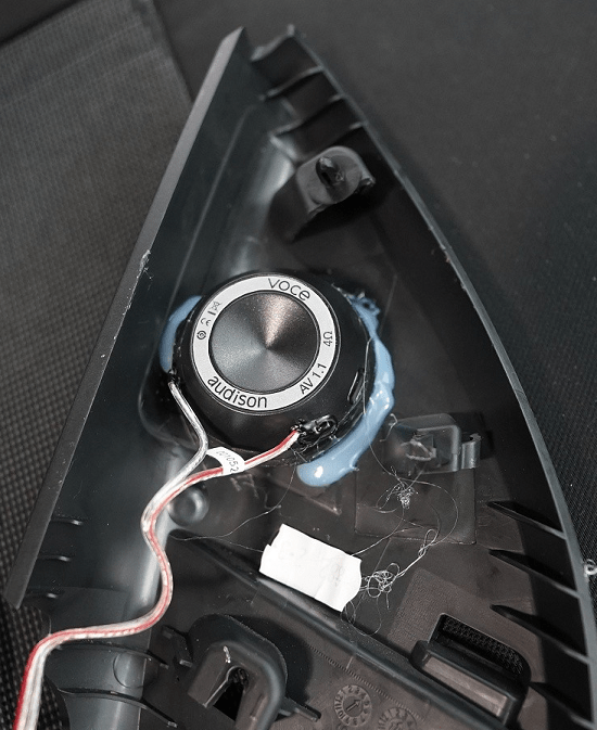

Currently I've cleared a bit my plan - change all of the speakers not only those in the front doors.
Based on my budget and the availability of the local shops best I can get is 2 sets of Hertz Cento CPK 165
Alternatively i can mix-match Audison VOCE AV1.1 tweeter and Hertz Cento C 165 woofer part of the Cento CK 165 component system.
AV 1.1 is good for XO at 2KHz when used without external amp. In this case the crossover will be hand-made 2nd order L-C.

After reading many articles on bestcaraudio.com and scouting for tweeter capable of 2KHz I've come up with possible solution - to use small 1.5-2.0 full range drivers instead of tweeters and XO at bellow 1000Hz. I've found several threads here for FR projects way back from 2009 and 2017 but no real results.
The original place of the tweeters is not like I said in the A-pillar but in the sail panel.
There are projects with Audison Voce AV 1.1 tweeters meaning there is enough place for driver with diameter of 50mm and depth about 30mm.
Several candidates are Peerless TC5FC02-04 and TB W2-2360S. Both rated up to 5 and 6W respectively but the TB seems very hard to find.
Eventualy TC6FC02-04 but it may not fit in the panel.
Is this reasonable solution?
Can someone point out any other candidates?
