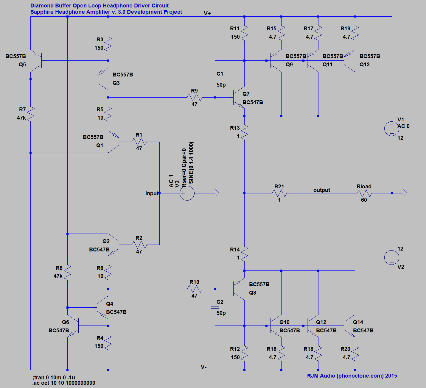

For reference, the circuit I'm mulling over is the headphone buffer shown below.

Your circuit has a requirement for some low noise, high gain types at the input stage and higher current types at the ouput. BC547 is normally considered to be a general purpose amplifier and switch - not a low noise, low level amplifier. You would probably benefit from using BC549 or BC550 at the input stage instead.If I could draw you on specifics, what it is about them that makes the 2SC2240/A970 better than the BC547/557?

At low voltages, there is no reason to use improved high voltage types like 2SC2240 but there are others, such as 2SC1815/A1015, that are equally good or perhaps better here. The main concern at the input stage is lowest noise/high Hfe
Rather than use multiple output transistors, you could also use a single driver pair, like BD139/40, BC327/337, BC639/40 etc. or even 2SD669/B649 for their better overload capability.

Back to this circuit, correct me if I am wrong. The circuit has gain of unity. Q1 and Q2 are EF driving a composite emitter follower. Total gain is unity at best. Why noise comes into the picture?
Matter of fact, why noise of the IPS input transistor even that important? You only have gain of say 20. I can understand noise can be an issue if it is the preamp or a phono preamp. Why noise is important for power amp?
From looking at the circuit, it seems to me that it would be better serve if there is an adjustment on the voltage driving the power stage. It's like the Vbe multiplier in conventional VAS stage to adjust the bias current to optimize cross over distortion. Again, this is just my inexperience observation.

Thanks again Ian. You've helped me a lot.
The circuit is part of a headphone amplifier. It will be driven directly by an OPA134 (until the day comes when I can design a discrete voltage stage that beats it). In principle the op amp will determine the output noise ... I expect, at any rate, but since I'm not completely sure and since it's no sweat to use BC549/550 it seems prudent to. The thing is since its a unity gain buffer, I wonder if just replacing the input stage transistors would be useful, or whether I'd need to replace the full set.
I was going to use BD135/136 for the output transistors, the parallel version with TO-92 is an alternate. Both options are on the table at present.

Not one, not two, but three different pinouts for TO-92 package. Ugh. Though the nxp/fairchild parts are simply 180 deg rotated, so as long as you know, you can just flip the parts.
For low voltage audio applications at 0.5~5 mA typical emitter currents, I cannot see any particular advantage between, say, 2SC1815, BC327, or BC547 .. though in principle the low noise variants BC550 might be desirable, its hard to compare the noise data between manufacturers since it is very dependent on measurement conditions.
Since my circuit is running on 12 V rails, the BC549/559 pair seems the best choice, unless I went with the Toshiba 2SA1015 as being of better audio pedigree.
I'd have to settle this before the getting the boards fabbed, unfortunately, given the different pinout. Then there's the question of availability of the 2SA1015-GR part (its non-stocked at Mouser ... and though its pretty easy to track down in Japan I'm not sure how it is in Europe etc.)

Self's Small Signal Design Handbook is good guide to fairly recent discrete parts selections and design too. http://www.amazon.co.uk/s/ref=nb_sb_noss_1?url=search-alias=stripbooks&field-keywords=Douglas+Self....For low voltage audio applications at 0.5~5 mA typical emitter currents, I cannot see any particular advantage between, say, 2SC1815, BC327, or BC547 .. though in principle the low noise variants BC550 might be desirable, its hard to compare the noise data between manufacturers since it is very dependent on measurement conditions....
BC327 or 328 for example, can handle higher peak currents, making them more suited to output current demands. They have other good qualities like low Rbb that make them suitable for extreme low noise and low voltage amplifier applications that may not be relevant here. I have used them in small amplifiers for many years and recommend them as excellent, economical devices for a small output stage like an output buffer or headphone amp. up to ~ 0.5 watt. However, some people now seem to expect these to be able to drive loudspeakers too, so it's not always obvious what people mean by "headphone" amplifier, even if it is pure fantasy.
More generally, beware that TO92 parts are now going the way of the Dodo. Toshiba 2SC1815/A1015 are obsolete and On-semi has now pulled the pin on BC550/60 and other manufacturers will follow suit as designers switch more completely to SMD. DIY and hand assembled specialties just became that much harder. There is some NOS available and there are 1 or 2 good Chinese and Taiwanese copies of the Toshiba parts. The point is, relying on TO92 parts into the future as a manufacturer, may not be wise. YMMV
Well, if the worst comes to the worst I can re-do the board for TO-126 or something. For the moment TO-92 is fine. I'll take your advice and go with the BC327/337. Hundreds of thousands in stock at Mouser.
