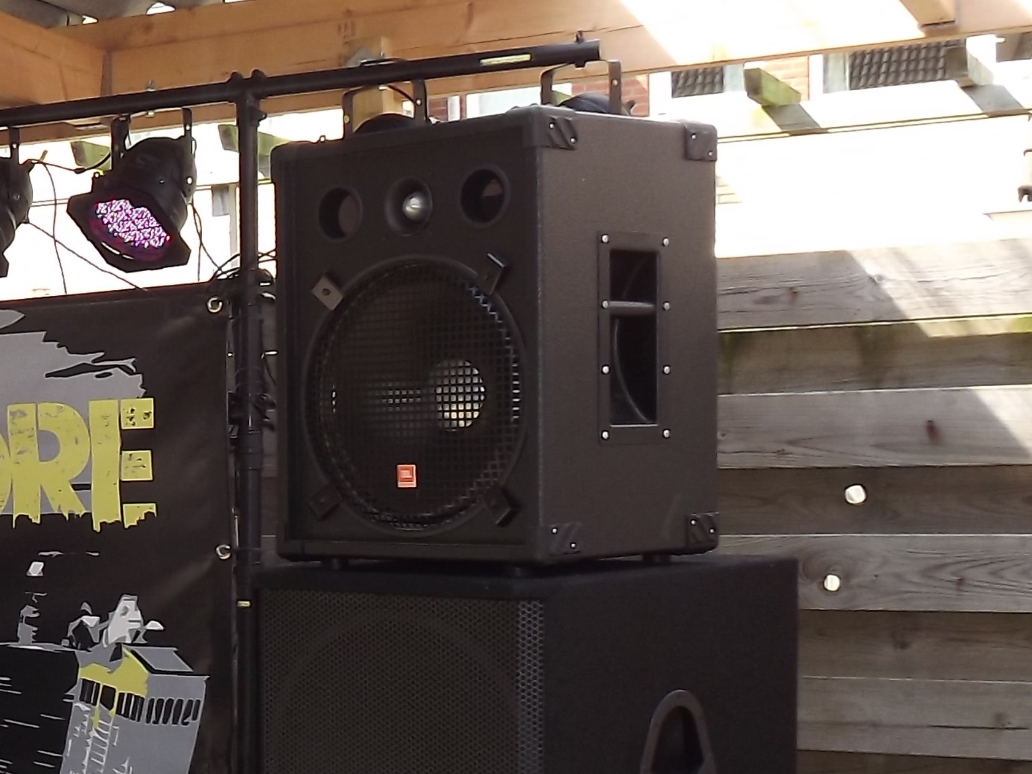

I use them as replacements in PA systems.

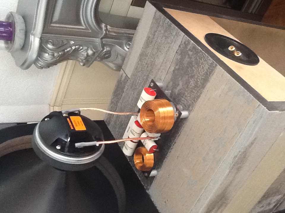

I purchased the emerald physics cs3 and that tweeter is crossed at 900hz 3rd order in the eminence coaxial 12" driver.
seems to do just fine.
I was suprised it could, I'm going to tri-amp these speakers soon and take measuments.
the passive x-over looks like a real mess in these speakers.
I'll post a photo, hold on.......
wow. 900hz in a coax? imagin the polars on that one. even a 10-12" waveguide would have problems that low.
