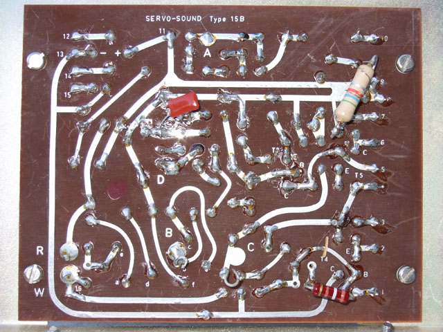

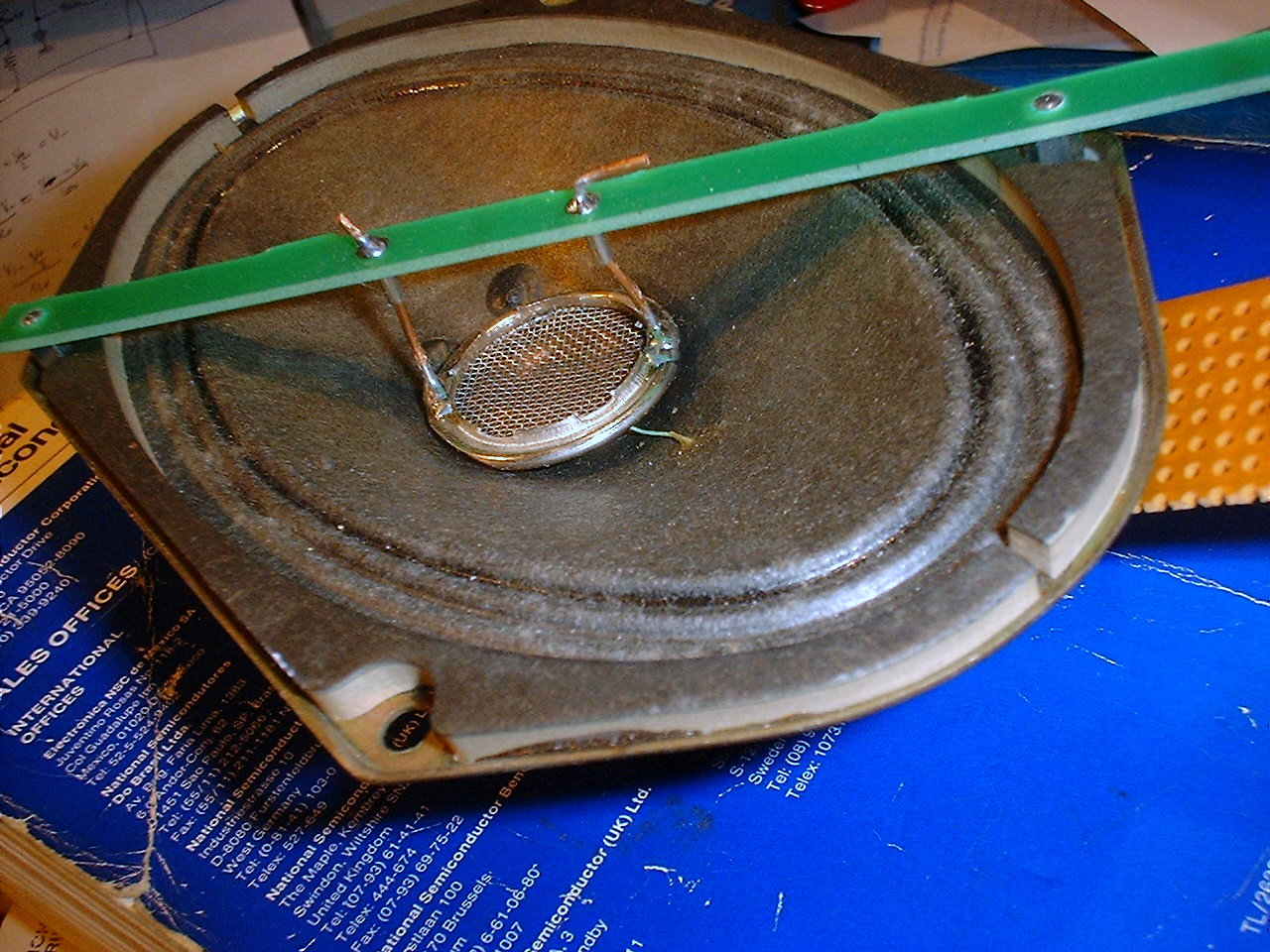

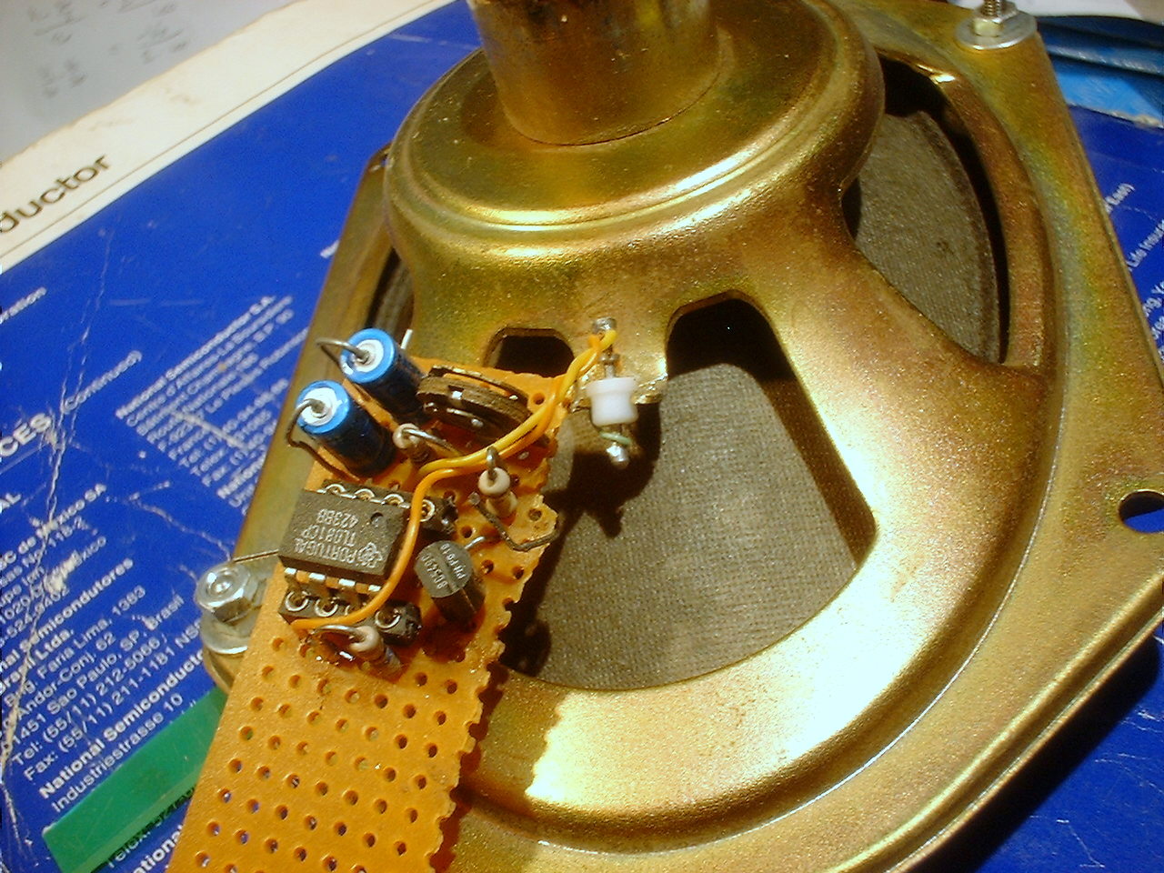

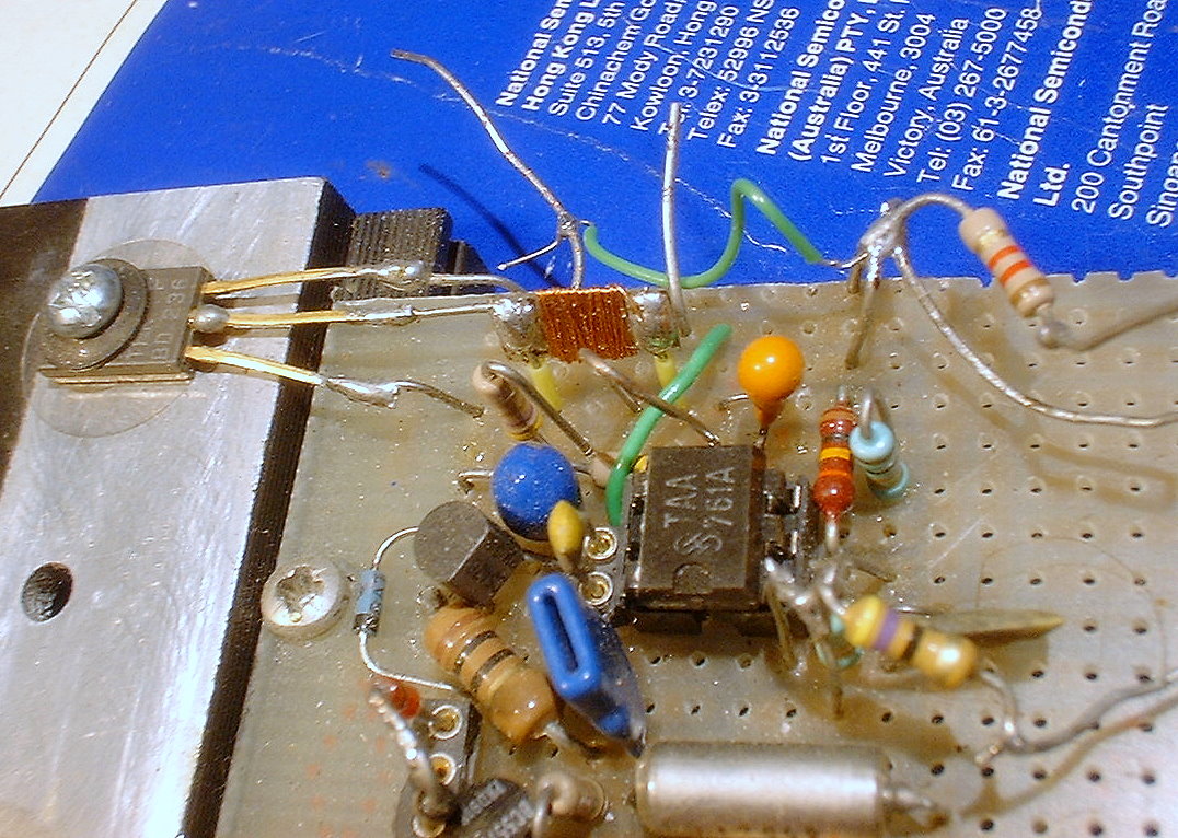

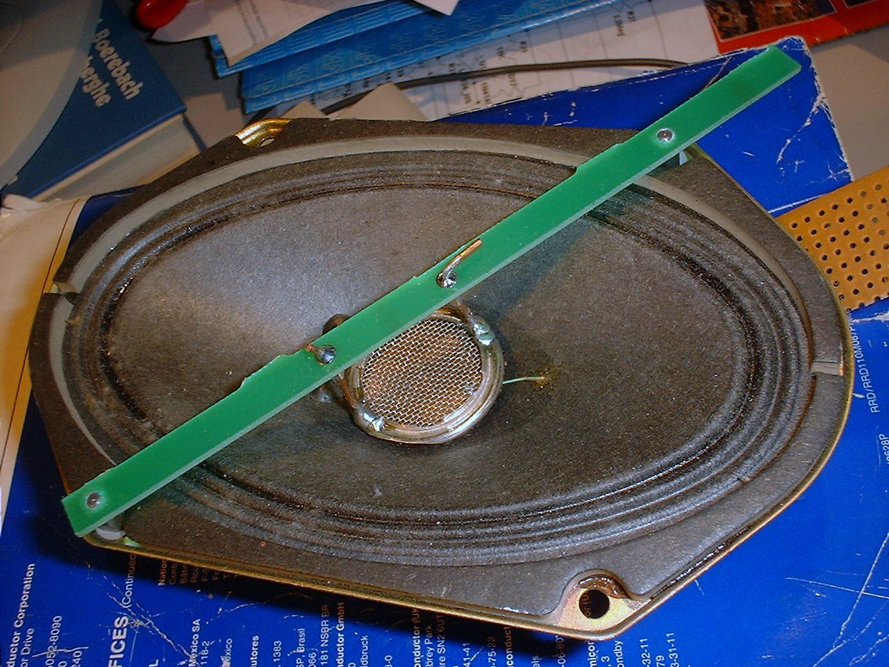

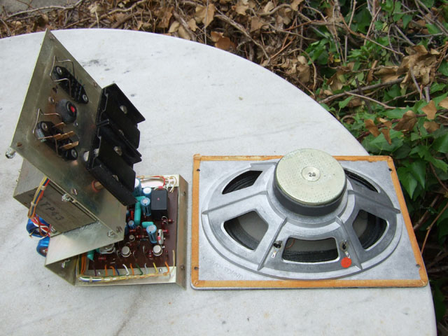

hello,

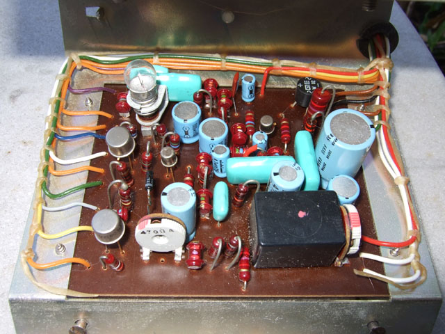

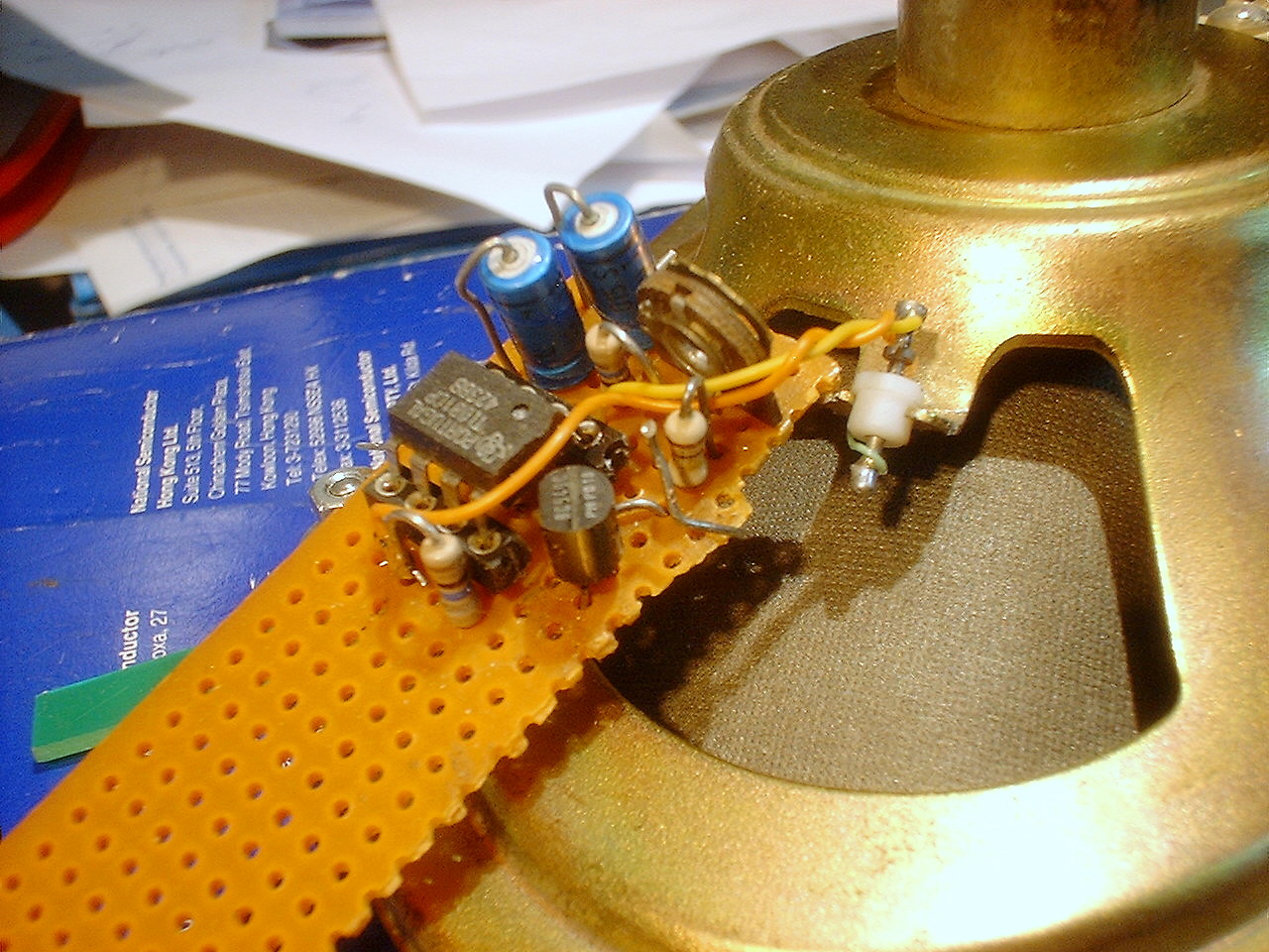

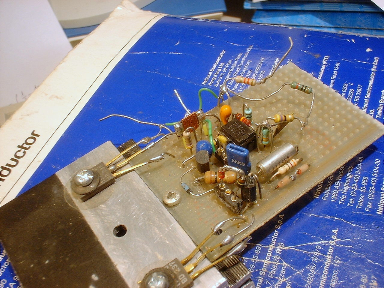

I just found two Servo-Sound loudspeakers. I just dismantled them. See the pictures. Can somebody provide the schematics ? It reads "type 15B" on the PCB.
This is a interesting device because the little black box on the PCB is sampling the voltage potential that's developping on a small resistor inserted in series with the loudspeaker, and from what I can see, this black box generates the feedback to the amplifier, in the bass range.
Obviously, the aim of such feedback is to extend the bass response, ironing out the typical closed box woofer resonance. Kind of motional voltage synthesis, so the whole amp gets motional-voltage feedbacked, instead of voltage feedbacked. In the bass range. That was the big sales argument claimed by Servo-Sound.
From my experience, if you try a bass extension like this, using equalization in a closed box, due to the limited power and limited excursion of the woofer it is necessary to reduce the bass extension at high volumes. That is maybe the role of the bulb, maybe used as variable high-pass filter at the input, with the cold wire resistance decreasing with the AC audio current it sees. I can't see any LDR, so I'm quite confident that this bulb sees the AC audio signal, and is the variable element needed. But, on the other hand, one may expect a lot of distorsion if the thermal reaction time is faster than the audio signal ...
Note the unusual design of the loudspeaker chassis. It is truly rectangular, covering the whole surface of the baffle. First first time I see something like this. Kind of integration of the driver and the front of the baffle. The idea sounds right, but do you realize that if you want to redesign or upgrade the loudspeaker you need again to order one with a custom-made chassis ? What a nightmare, indeed ...
Cabling looks high quality like military or aeronautics. But look how far the power transistors are from the PCB ! And see how small and how far the rectifying bridge is, far from the filtering cap, and far from the transformer. That's completely mad !
Doesn't surprise me too much they stopped trading.
Their concept of an active loudspeaker integrating some smart equalization and variable high-pass for meeting the safe operating area of the driver, is still valid.
Therefore I'm sad they stopped trading.
So, if somebody could provide more info like a schematic of this Servo-Sound 15B version, that will be very welcome.
Steph

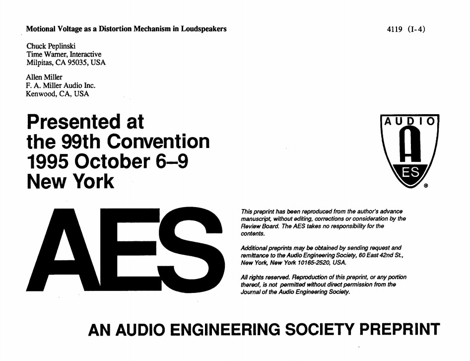

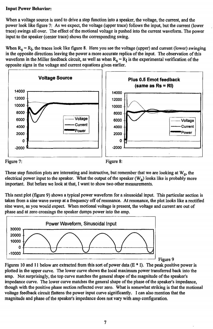

My idea would be to get the focus (this concept is explained in a post above) basing on the power signature signal following Peplinsky-Miller AES publication in 1995. See attached pictures.
Once you have your "flat" power signature in the time domain as described by Peplinsky-Miller (instantaneous current times instantaneous voltage) on a couple of frequency bandwidths (need a few banked bandpass filters - easy with DSP), and if you keep track of the value of the positive impedance you are generating for effectively attaining the unity damping factor, then you know everything about your load.
The algorithm to be used is the autofocus algorithm used in digicams. It starts hunting, but the more signal you give him as food (contrast and details), the more accurate and faster he gets in focus.
When you are in focus, it means thus that you have acquired with great precision the equivalent schematic of your loudspeaker in the closed box. Or, possibly, any other loudspeaker arrangement like a 4th order bass-reflex, 4th order bandpass, or 8th order bandpass aka Bose.
This is the way to automate the obtention of Peplinsky-Miller unity damping factor with a 0.1% precision, say from 10 Hz to 250 Hz.
This is my idea #1. Is this a new idea ?
What to do with the precise knowledge of the load impedance ?
Answer : sample the current using a small shunt resistor. Feed this current into analog components emulating the equivalent schematic, with the values you just calculated. Extract the pure motional voltage. It may be precise at 0.3 % if you use 12 bits DACs for defining the values of those analog components, if you use 0.1% precision resistances in your gyrators and capacitance multipliers, and if the target value are precise at 0.1% from the autofocus process described above.
I know it's a kind of rocket scientist solution for getting a high-precision wide bandwith motional voltage.
This is my idea #2. Is this a new idea ?
What to do with the motional voltage ?
Answer : use it into an outer feedback loop, encompassing all what got discussed untill here, for finally getting an inner unity damping factor arrangement, but completely motional voltage driven from the outside.
That is my idea #3. Is this a new idea ?
I don't expect to have the magnetics non-linearities corrected by such feedback. Philips MFB using an accelerator sensor does.
With time passing, this looks less and less like a rocket scientist solution, if one dares to call this a solution, nowadays.
A tiny SoC containing everything, including ADCs, DACs, DSP, laser-trimmed FET opamps, laser-trimmed resistors used in gyrators for synthezising the reactive components, will be cheaper, one day, than a PXE (piezo) crystal needing two terminals, one precision FET amp as buffer, and two or three supplementary wires and associated connector going to the driver.
If my 3 ideas are all right, all quality active loudspeakers will be built like this : a rocket scientist approach. With possibly more tricks for compensating the magnetics nonlinearities.
Steph

I can remember the launch of the short lived servo sound loudspeaker in the seventies
I came across them in an exibition
I thought that they were really good for their size.
They in fact inspired me to produce some motional feed back spk of my own !
I fed the spk voice coil with an rf signal and had a pickup coil located in front! This amplitued modulated the signal so that I could determine the relative posistion of the cone and apply corrective feed back to put the cone where ir should be !
I was promised financial support by a then famous loudspeaker manufacturer to advance my ideas but whem push came to shove! they let me down and the project had to be dropped
regards Trev

Hello, I'm afraid we are not on the same wavelength yet.
1. In this thread we are discussing about the control of a loudspeaker membrane without relying on a sensor. The aim is to have no accelerometer, no extra coil winding, no optical pickup, no RF system.
2. There is one post in this thread describing a very interesting RF system. This truly deserves a separate thread, as from what I'm understanding, there was a working prototype and maybe results or issues to be discussed on diyAudio.
3. The Servo-Sound ver.15B still needs to be properly reported. I can reverse-engineer the printed circuit. But I don't know what's inside the little black box next to the trimmer (see attached pictures).
4. The Servo-Sound ver.15B is sampling the current using a small resistor in series with the loudspeaker, and this signal seems to be used in a bridge substracting the I*R component from the overall voltage, hence coming close to the pure motional voltage.
5. If you do the maths, you'll see that point 4 is equivalent to feeding the loudspeaker using a negative resistance power source. Therefore, one can say that the Servo-Sound is a variant of the negative resistance power source. If the negative resistance is different in module from the actual coil copper resistance, the extraction of the pure motional voltage fails. It still contains a dumb (delta R * I) component. This is not a good start for organizing the feedback around it. But we can live with that.
6. More problematic, if the module of the negative resistance is greater than the actual coil copper resistance, you end up with a system that's fundamentally unstable.

This might be of interest:
The first two pictures could give you some clues about the insides of "the black box": it is a thermal image shunt.
The following pixes illustrate a tentative electrostatic MFB speaker.
Despite its apparent crudeness, it probably deserves some more attention: preliminary tests showed an astonishingly good behavior and stability when enclosed in a relatively high-gain closed loop, without any precautions, calculations or compensation.
See you sometime on Futura
