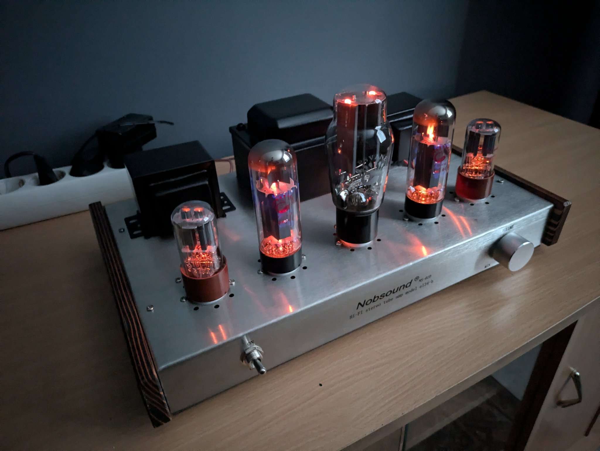

I purchased a Nobsound NS-02D tube amplifier from amazon.de, which was specified to have 1*5Z3P 2*6N9P 2*EL34B tubes. However, it actually came with 1*5U4G 2*6SN7GT 2*EL34C tubes.
I found some information from a YouTube video where a version of this tube amp was tested. The mode (pentode, UL, or triode) wasn’t specified. Here are the test results:
I want to ensure I don’t push it too much. My speakers have a sensitivity of around 85-87 dB.
P.S. The tubes in my amplifier are from Psvane and include: rectifier 5U4G, preamp 6SN7GT, and power amp EL34C.

I have Pro-Ject Primary E + Pro-Ject Box-Design Phono Box MM connected to the amp and to get louder sound I need to turn volume control past 12:00 clock position. It could be that coming signal is little low or power lacks. Speakers start to giving humming sound past 12:00 clock position without music playing. Usually I listen volume knob turn to 09:00 clock position. Only for experiment I have turned it past 12:00 clock position. I wonder is it because there is only 1W of power.
1. A complete and accurate schematic of your amplifier is needed.
2. If I remember correctly, that phono preamp, can not drive a long shielded cable from the preamp to the power amplifier.
More information from you might be helpful for troubleshooting purposes.
