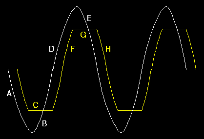

Clipping is the distortion of the audio signal as it reaches the power supply rail voltage. It's the clipping off of the top and/or bottom of the waveform. In the following image, the yellow amp has less rail voltage and is being driven to clipping. The white amp's waveform has higher rail voltage and isn't yet driven to clipping.
10 amps at what voltage? You are asking for too much with that power supply? The amp is going to have dynamic peaks as well and every time that's happening you are dropping voltage drastically and the amp's power supply is going to demand even more current which will task your 12v supply. You need something that will provide around 35 amps continuous at 12v or higher to work in that power range.
You also aren't getting "max power available" out of a cigarette outlet with an amp that can produce 150w a channel, the car wiring is too thin and the fuse will either keep popping or the cigarette jack will melt and come apart (if the car's wiring doesn't melt first).
