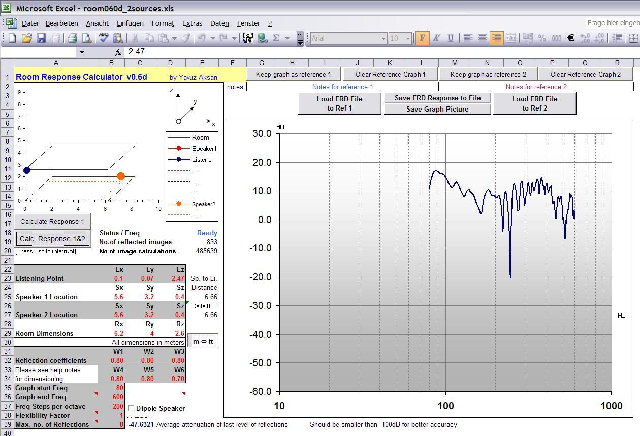

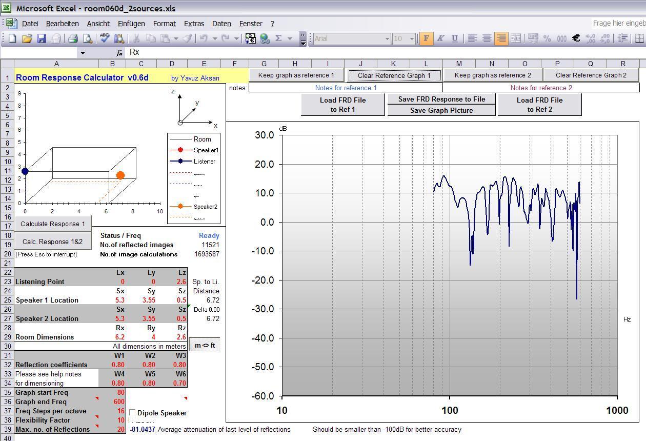

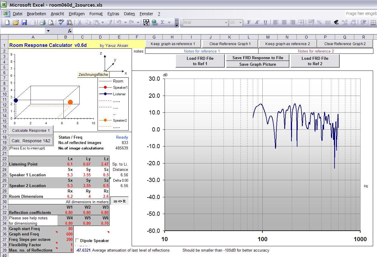

Example for "modal smoothing" upper bass / lower midrange
The following pictures may not be a "proof" as this evaluates only
one specific setting, but it may serve as a demonstration of
"modal smoothing":
1st picture: 2 sources exciting the room from the very same position
...(or "single source with double volume displaced")
2nd picture: 2 spatially separated sources
...0.6m along X-axis (depth of room)
...0.1m along Y-axis (width of room)
...0.6m along Z-axis (height of room)
The "listening position" in the opposite corner under the ceiling may not be
"typical" ... but instructive
The frequency range from 80Hz ... 600Hz was chosen, because there
is only little change below 80Hz: The separation of the sources is too small
to show significant effect in the lowest octaves.
In the frequency range shown a multiple subwoofer setting can do close
to nothing while a "multiple woofer" with moderate separation of sources
<1m setting can do a lot.
>> Which range should have priority in smoothing the loudspeaker room
interaction:
a) 80Hz.....600Hz or
b) 20Hz ......80Hz
Kind Regards
"modal smoothing":
interaction:
b) 20Hz ......80Hz
Kind Regards

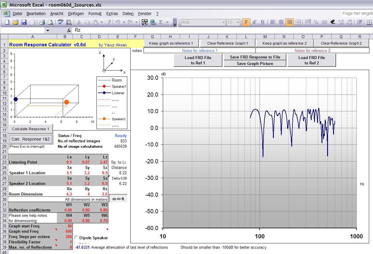

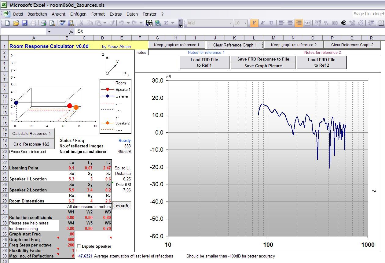

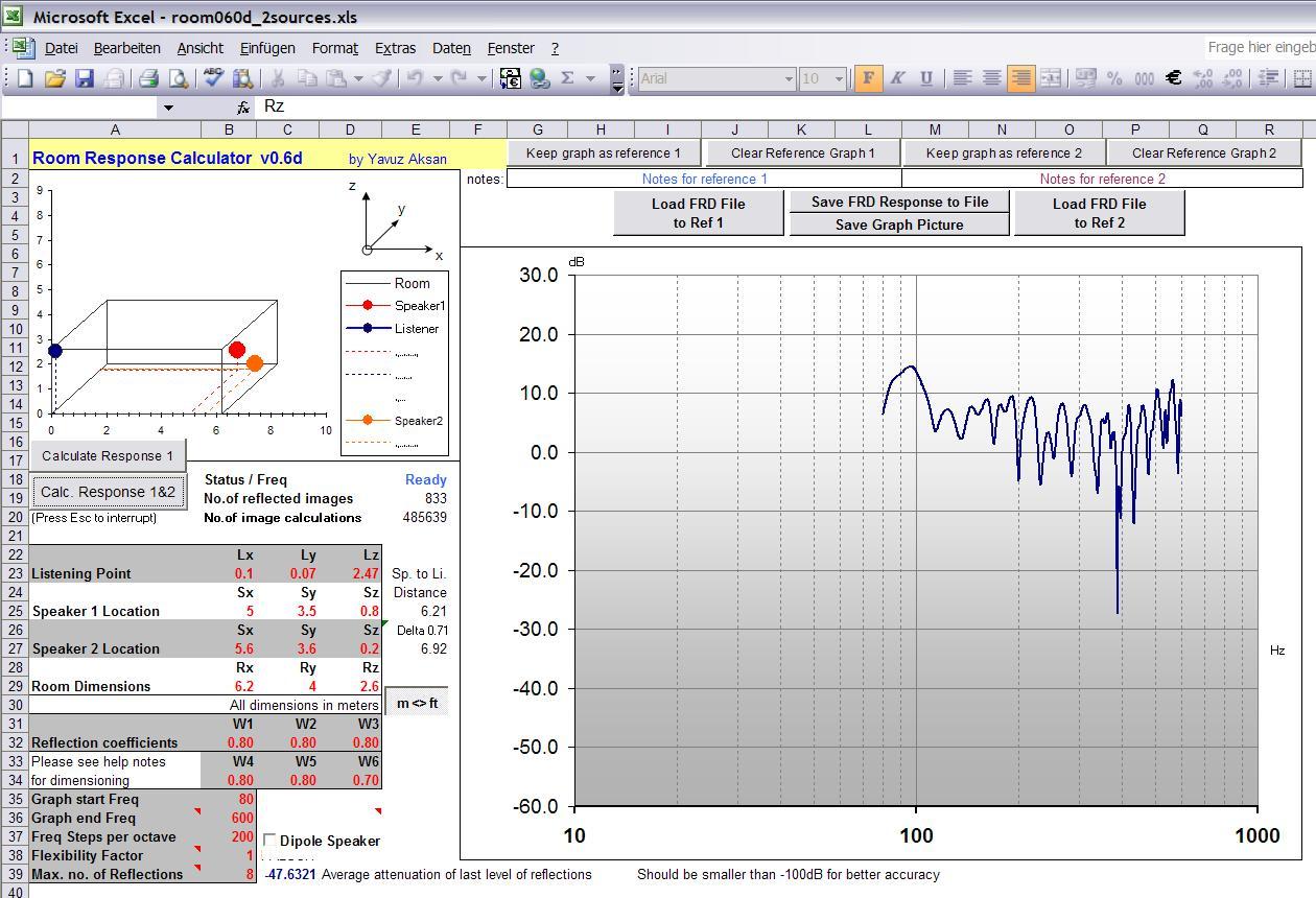

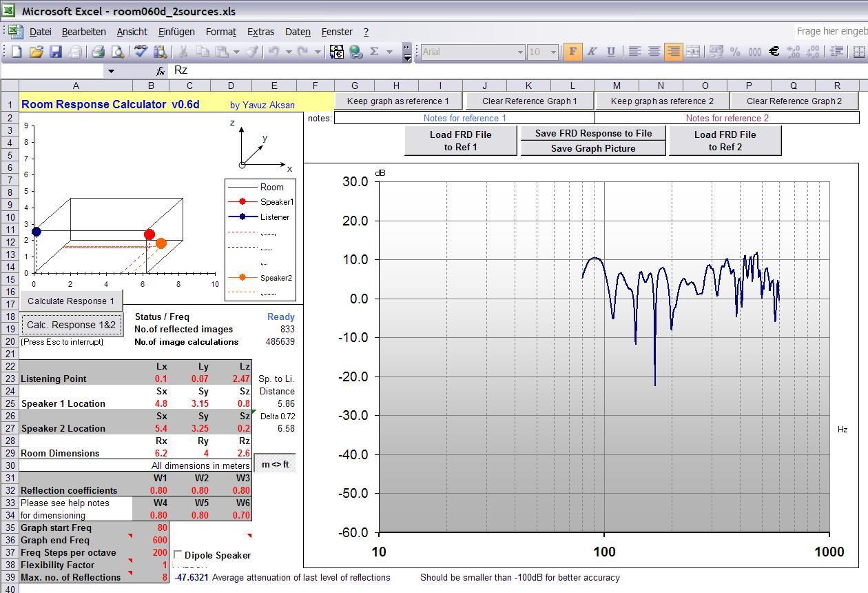

Some more examples:
- there are 3 pairs of graphs, pairs have filename prefixes "02", "04", "06".
- within each pair there is a single source and a double source member.
- the single source member in each pair is placed at the mean coordinates
of its double source twin.
Absolute position and separation is varied slightly between the 3 pairs.
One cannot say "use separation and you are fine". But using separation
there is a tendency towards more smoothness of the inroom response,
which would have to be evaluated in a more systematic experiment of course.
