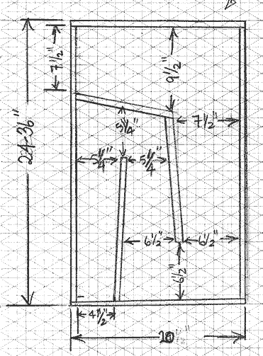

7V said:
PS: Dave, if you can get me sufficiently inebriated from where you are, I might be tempted to describe a 2" thick, transmission line speaker based on the Picture concept described. Then again, by the time I've finished typing this out, you will probably have already figured out three variants on the concept.
Here is one i did in 1975 for a Jordan-Watts. It was 4" thick, but the JW is also a larger driver.
dave
Knew you wouldn't disappoint. Also, you could put the driver centrally and have the line going round the outside - saves on bends.
