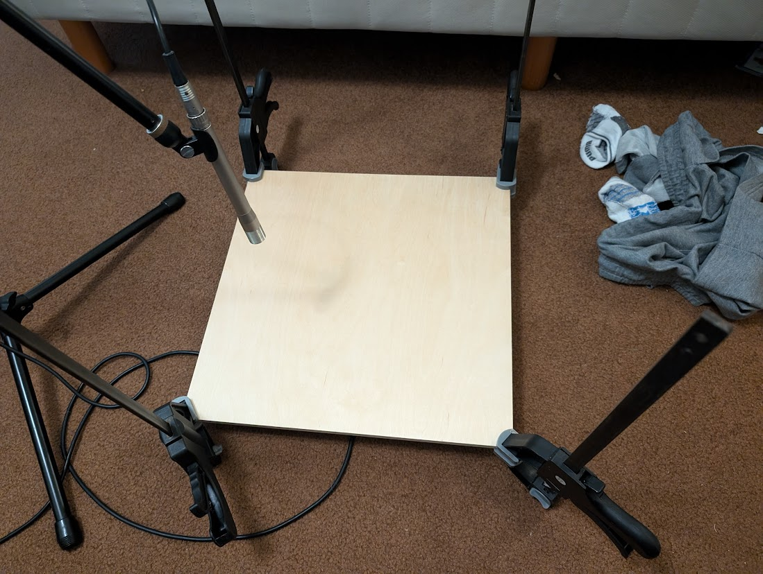

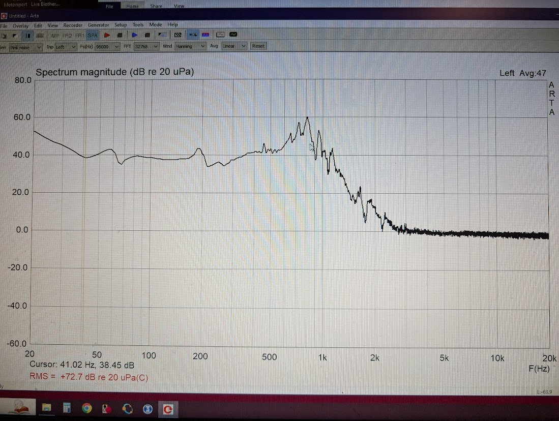

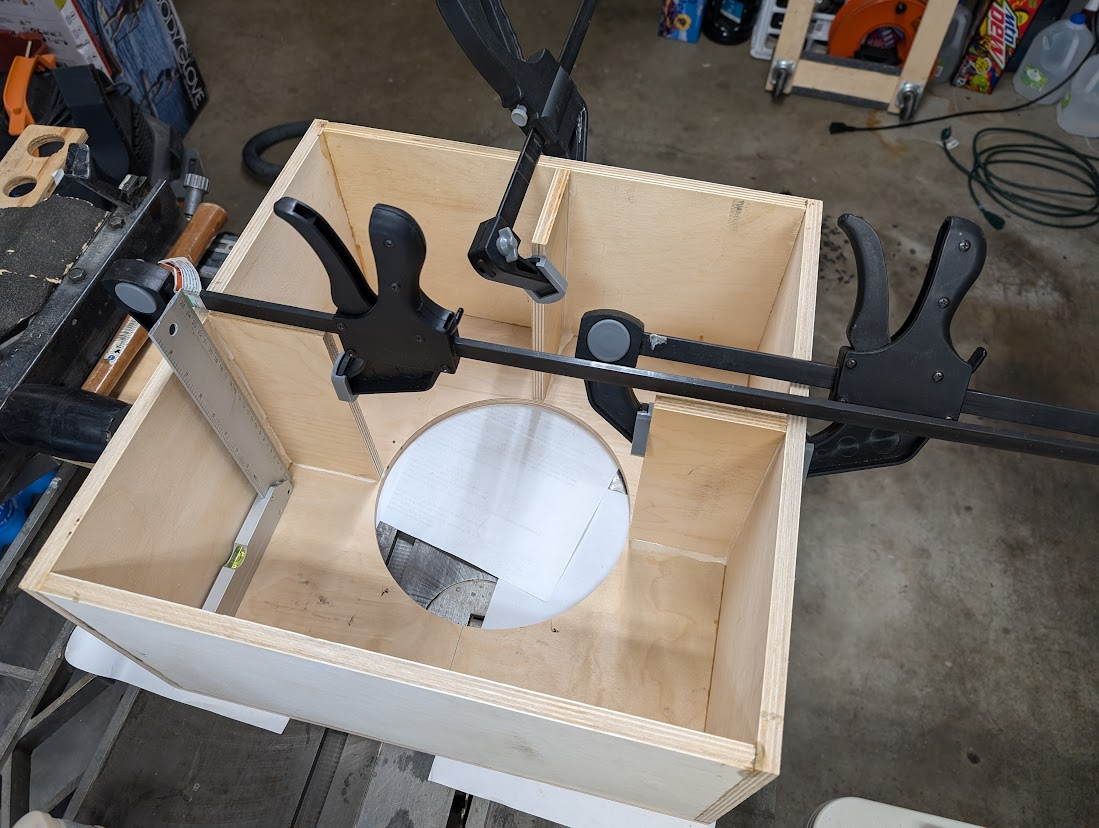

I built four woofer boxes in September using the 12 mm birch plywood from my local lumber yard. The 5' x 5' sheet of 12 mm ply was about $60 USD. To verify the properties of the wood I cut a sample panel and tested the resonant frequency to determine if it would work for my project. I also used the Matlab scripts at the website vibrationdata to find the resonant frequency of test panel and then went on to calculate the expected resonance frequencies for the panels in my woofer box design. I was able to build the box with a 10" woofer and keep the weight under 20 lbs while having the lowest panel resonance above 800 Hz.
In the end I just knock on the panel and measure the spectral content. I need to take the time to learn to use a more complete CAD/CAM
package some time.
https://www.vibrationdata.com/rectangular_plates.htm

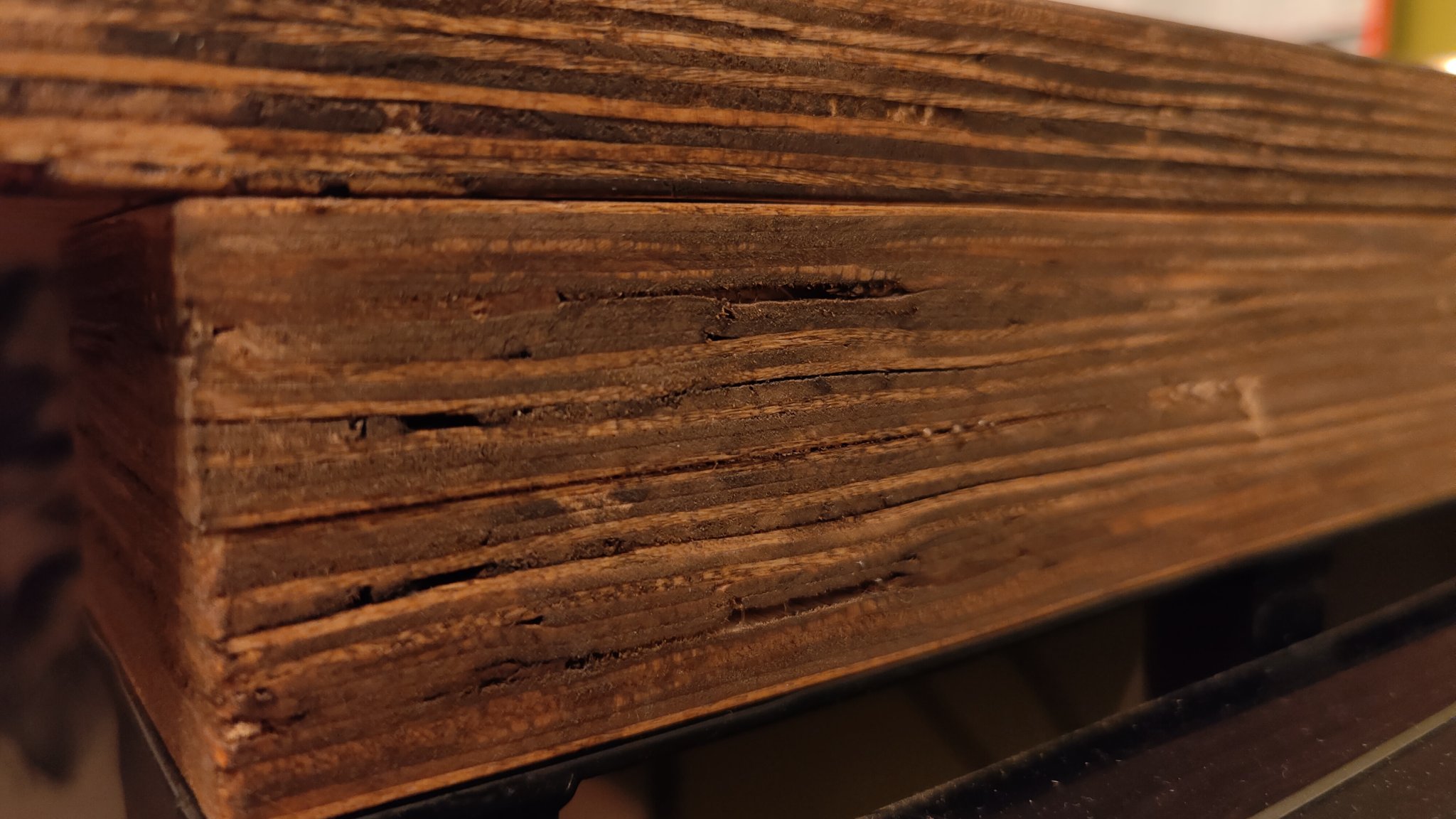

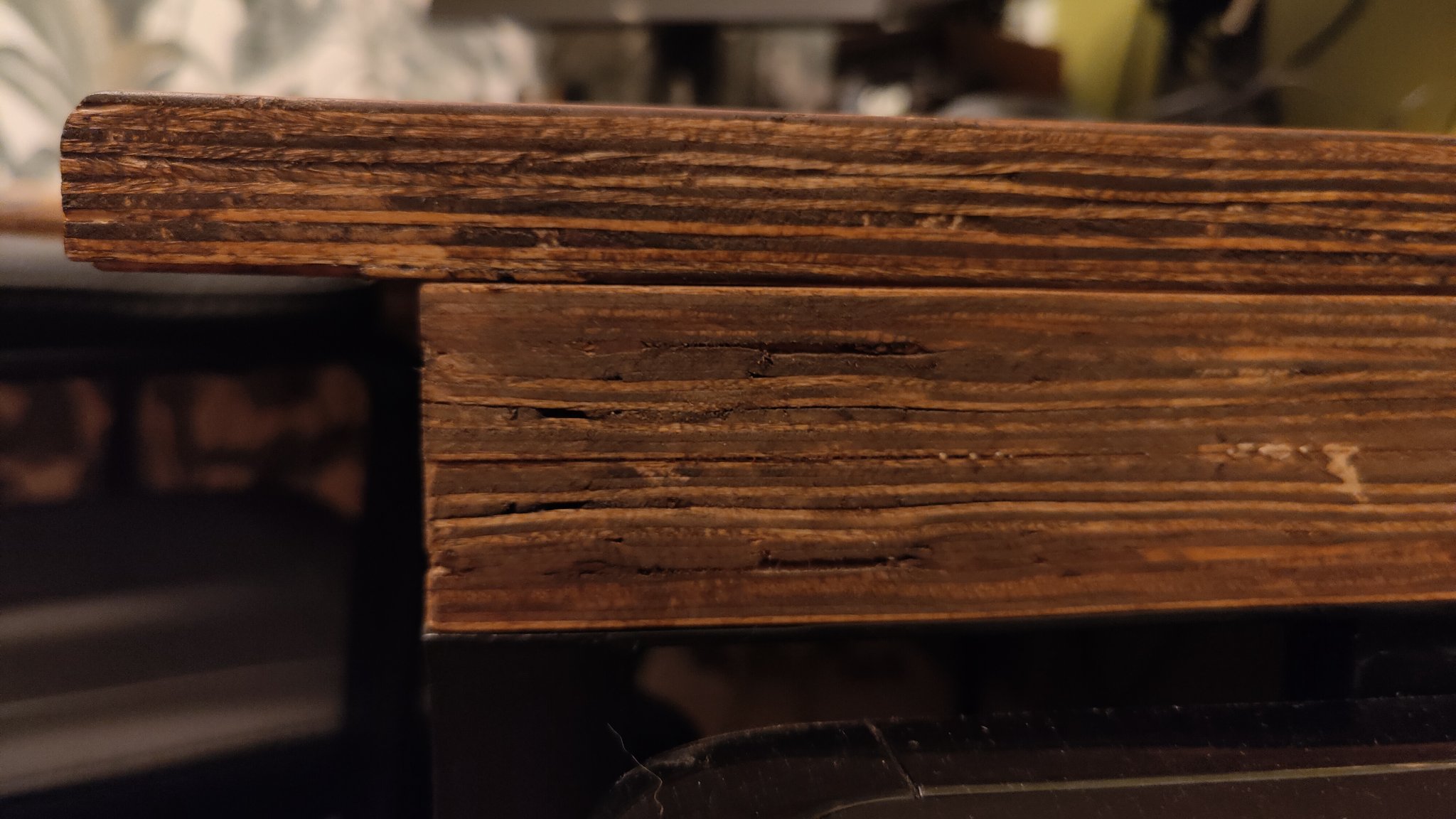

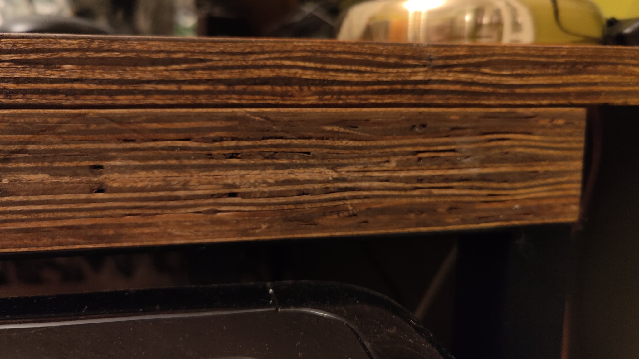

I bought some cheap Chinese stuff from the builders merchant. Not sure it it was MKM, or Jewsons. Never again. Atleast it would be useless for speakers.
I bet @rjbell is having kittens looking at this stuff. More like a random ply sandwich, the plys are more turbulent than laminar. And when you run your fingers over it you can feel and hear the voids. Terrible stuff. I was committed so the project continued on and I was pretty disappointed with the outcome on the edges. I ended up trying to fill some with little biscuits of the offcuts, but in the end I gave up. It was heavy in it's full sheet so I can imagine a proper voidless furniture grade sheet would weigh a ton.
They somehow manage to get decent laminations around the outside so it's only when you cut into it you see the true horror!
