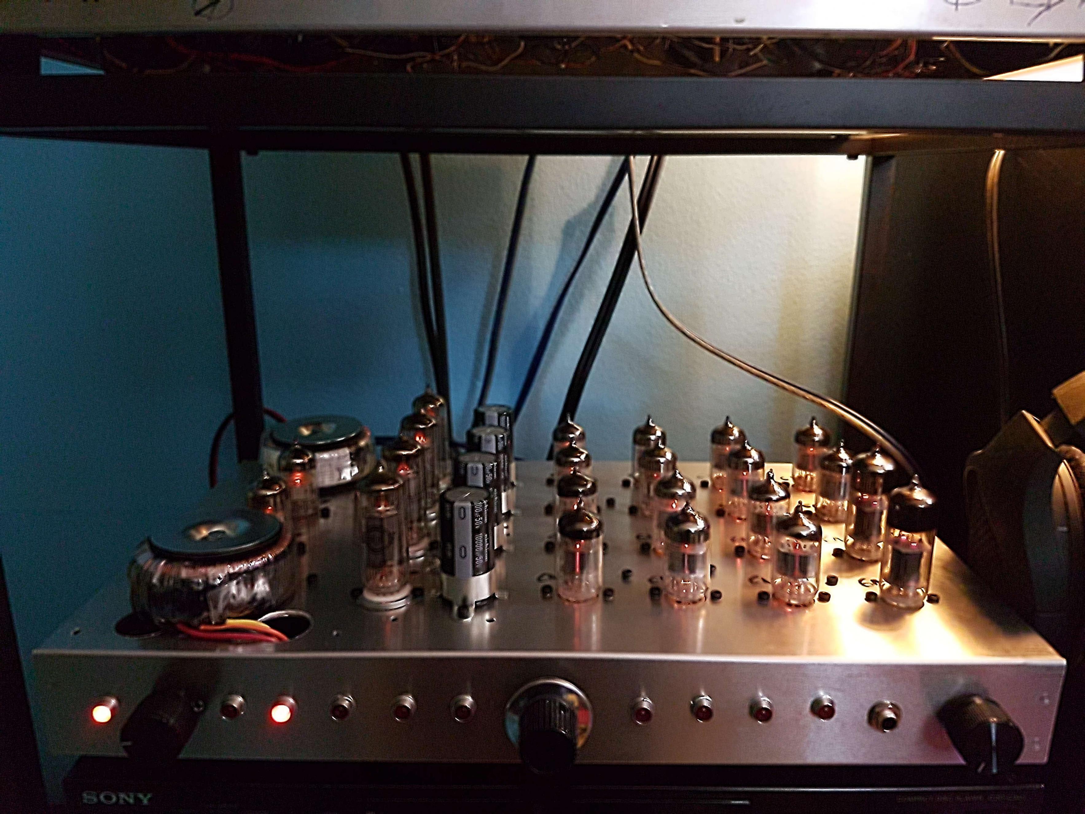

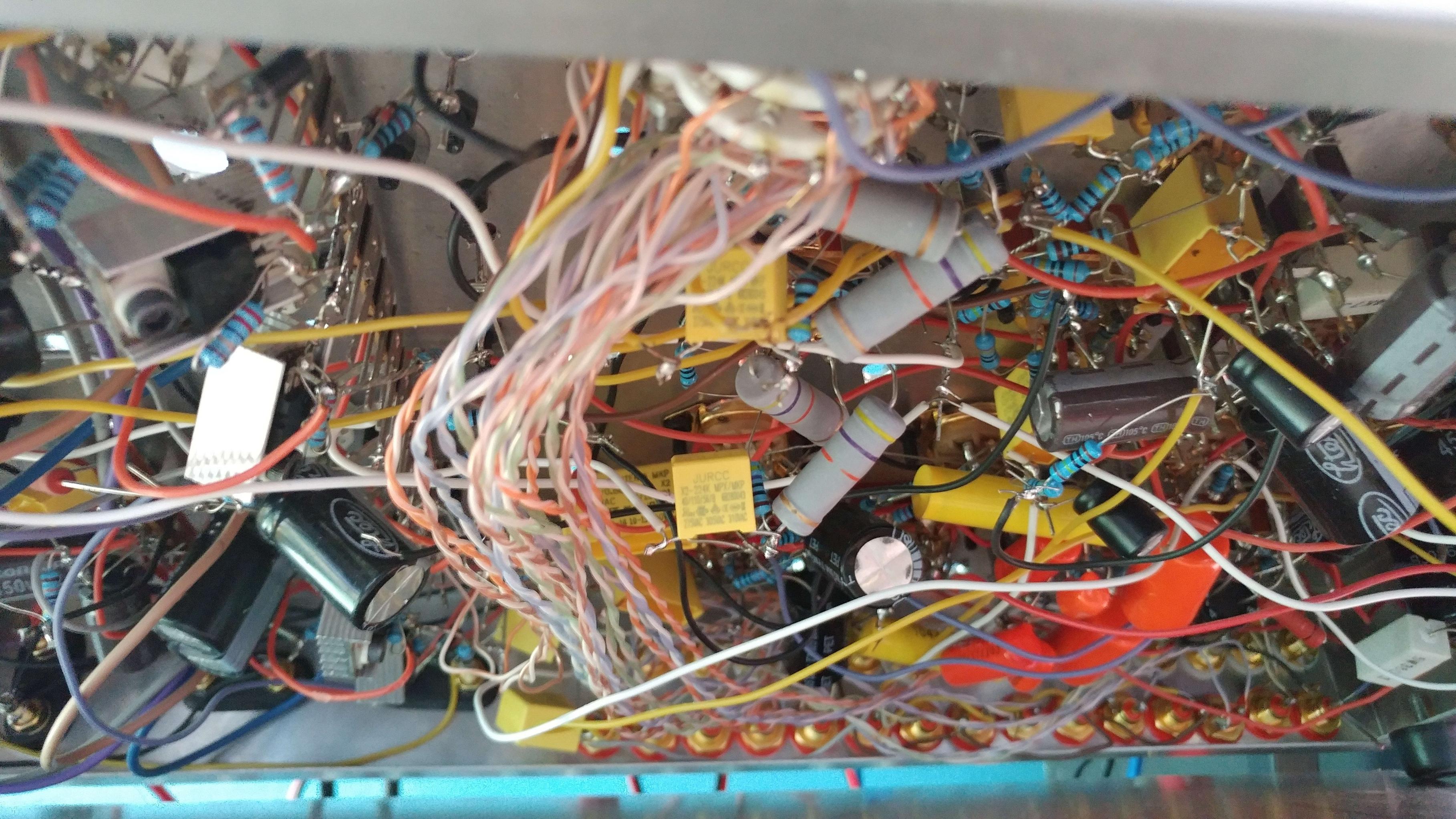

Here's a pic of it. 10 in 5 out and despite how messy it looks in this pic there is no noise, hum, crosstalk etc. All signal grounds are switched with L and R.
This is an integrated amp with a headphone amp (32-600 ohm), buffer (for 4 parallel outputs), phono amp (with dedicated output), CCDA gain stage feeding a floating paraphase splitter and PP AB1 output in a 17x10x2 inch chassis. External power supply.

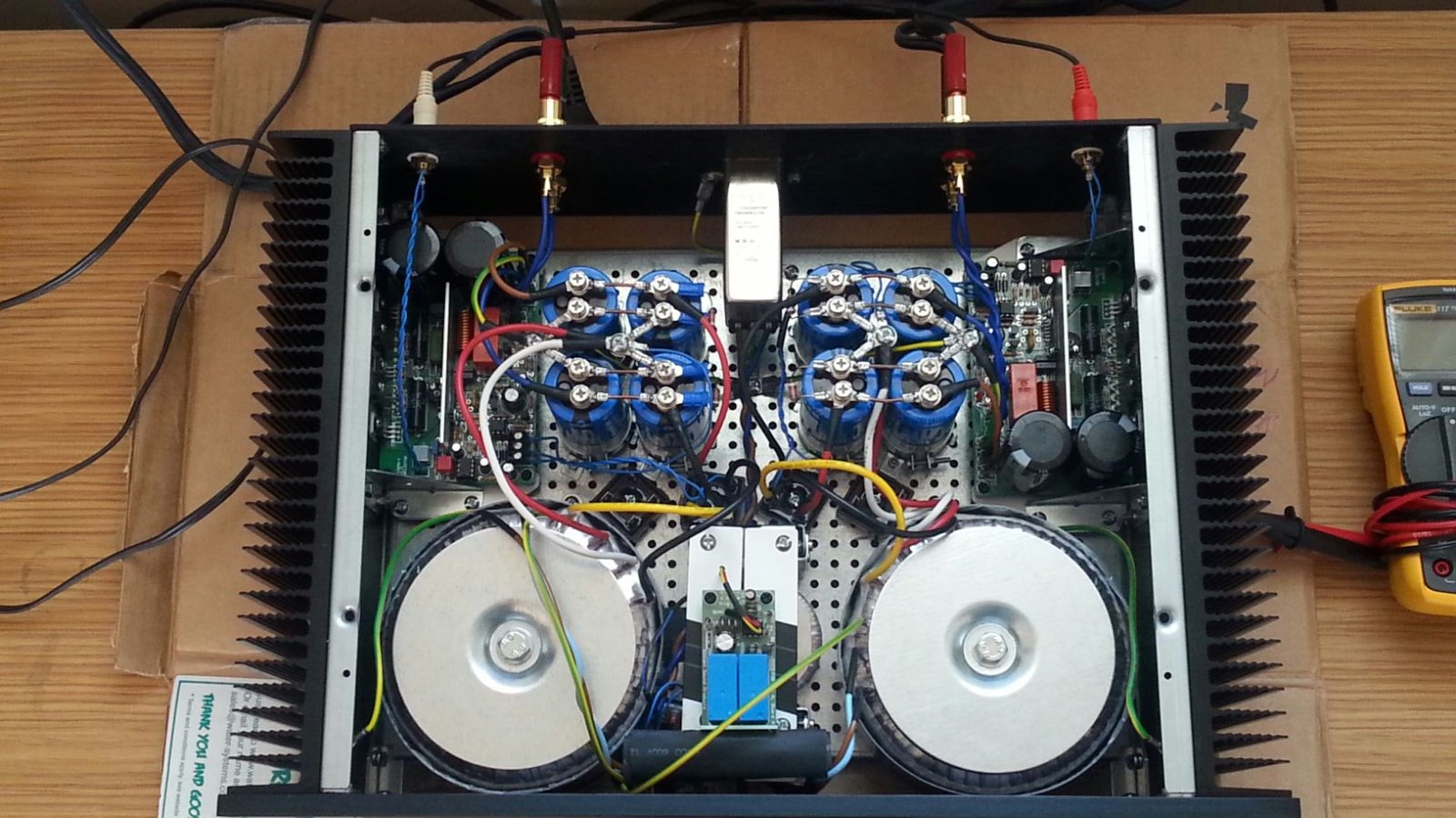

For my power amp, I twisted the audio input and output wires. Coax looked a bit more fiddly, and I never noticed any issues with noise or interference. The inputs are minimal length (almost not enough for a twist), as the amp PCB is positioned to the rear.
