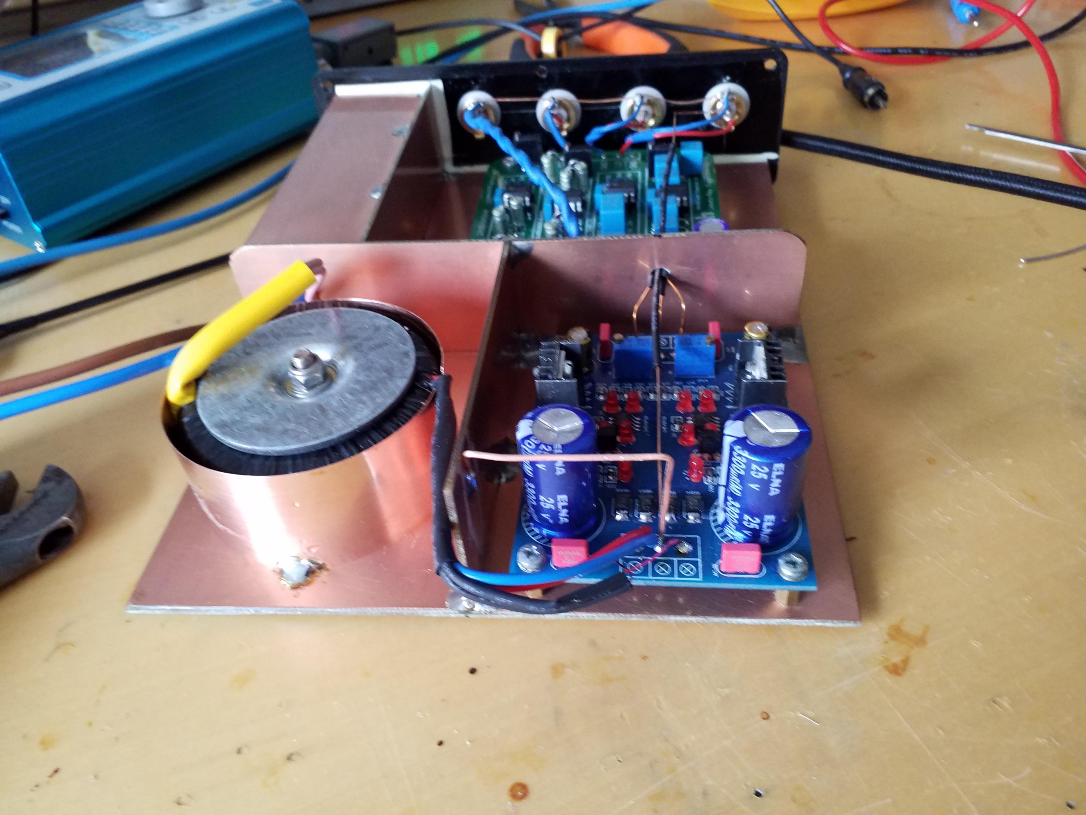

In my active filters I paid alot of attention to screening well, toroid belly band double sided pcb as screens, grounded of course, has it helped? Well soundcard testing was very nice, 112 db noisefloor which is the soundcard limit.
Removed windings from this to lower secondary voltage and made a belly band to
Nice belt.
Copper belly band deserves thicker.

The "belly band" is a one turn coil that shorts stray fields.
It's effectiveness strongly relates to the thickness.
From a forum:
More, here:Re: Copper tape around Current Transformer
A belly band goes around the transformer windings (all of them) and the core as well.
With the ends soldered together it acts as a shorted turn around the whole transformer reflecting any flux leakage back inwards. It doesn't need grounding to work.
