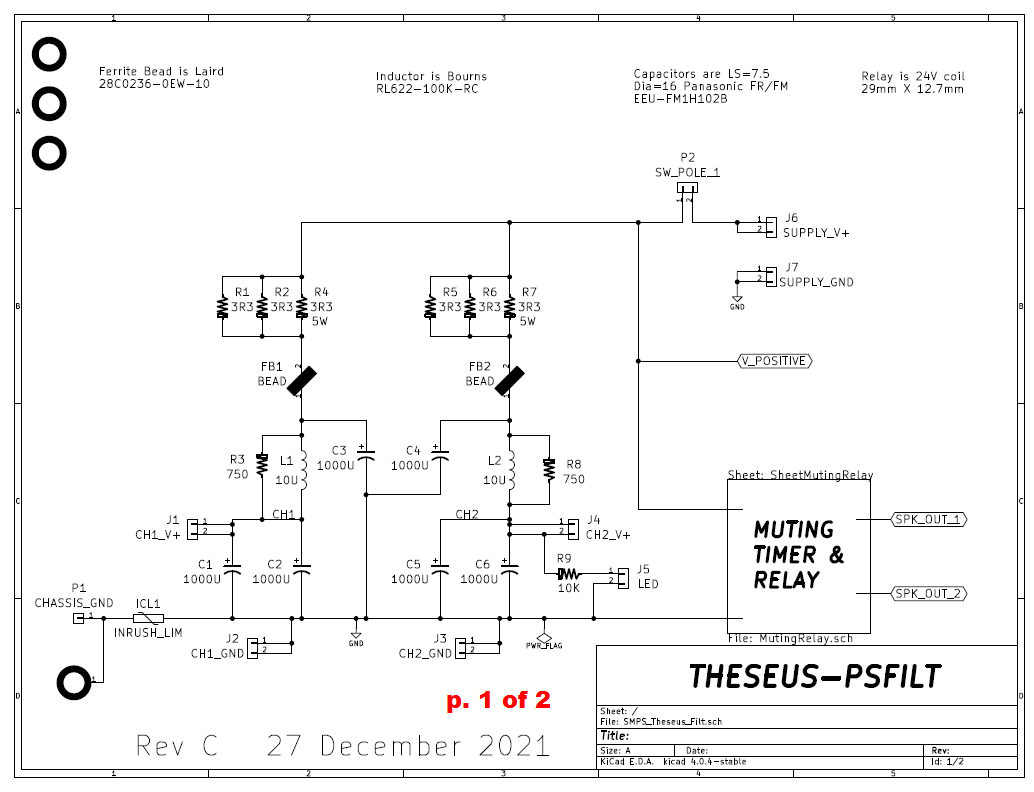

Builders without an original VFET kit will need Front End cards, a PSU filter card, and output stage cards. The Ship Of Theseus portfolio of choices, provides several possibilities.

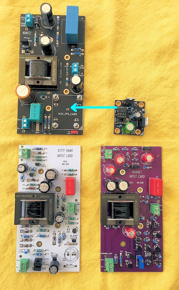

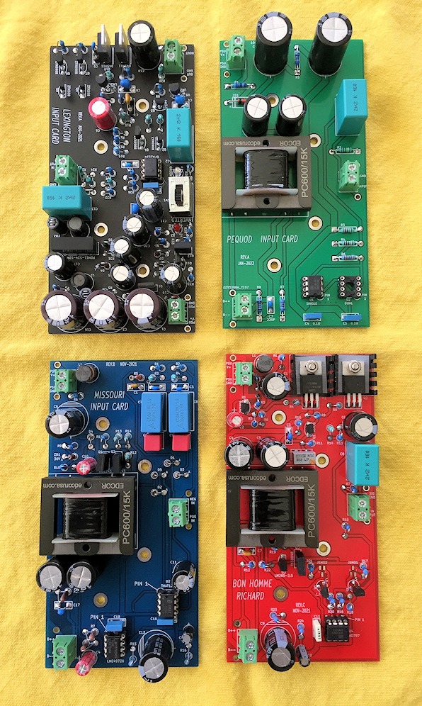

Here are brief summaries of the seven new Front End cards. The previous Front Ends were named for British warships: Scourge, Bulwark, Marauder, and Dreadnought. The new Front Ends are named for American warships. Well, six of them are. The seventh, Pequod, is American but not a warship. It's the boat in Moby Dick.

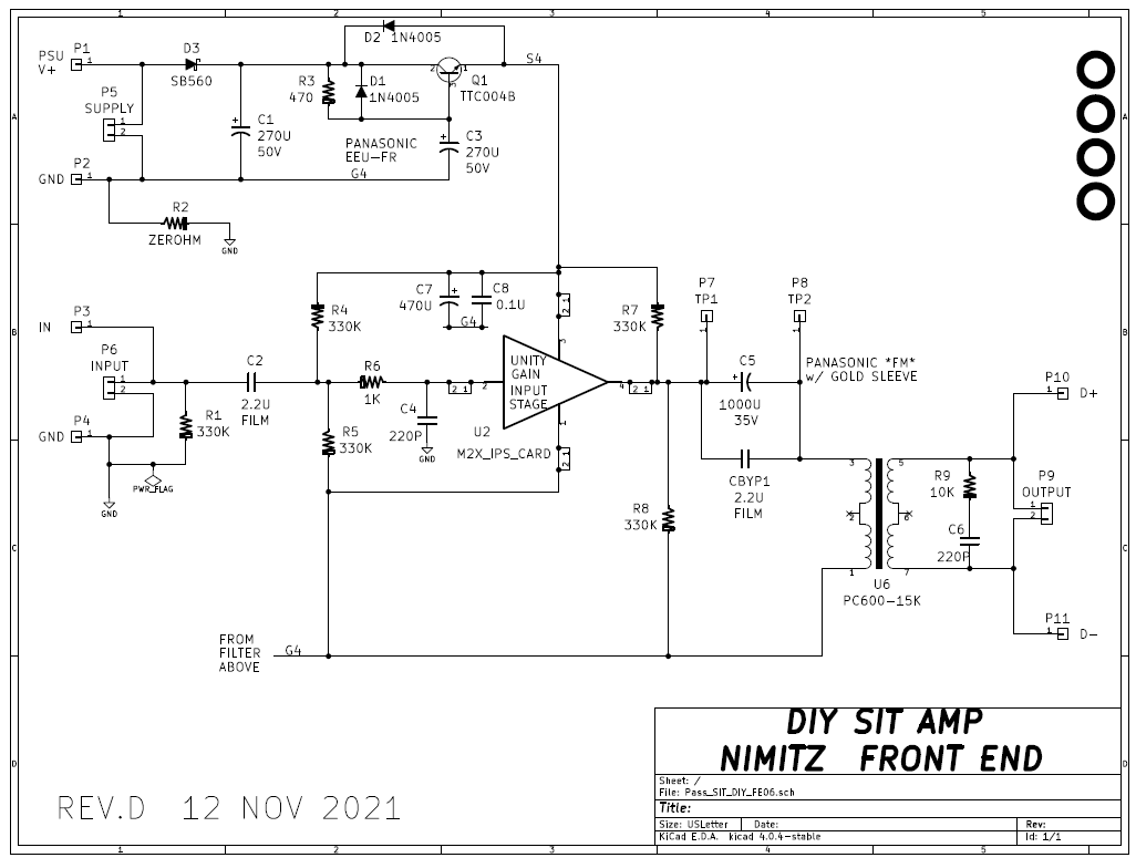

Nimitz is a customizable Front End which accepts M2x daughter cards. Builders can bolt whichever M2x card they wish into Nimitz, and that
becomes the Front End for a VFET or Theseus amplifier.

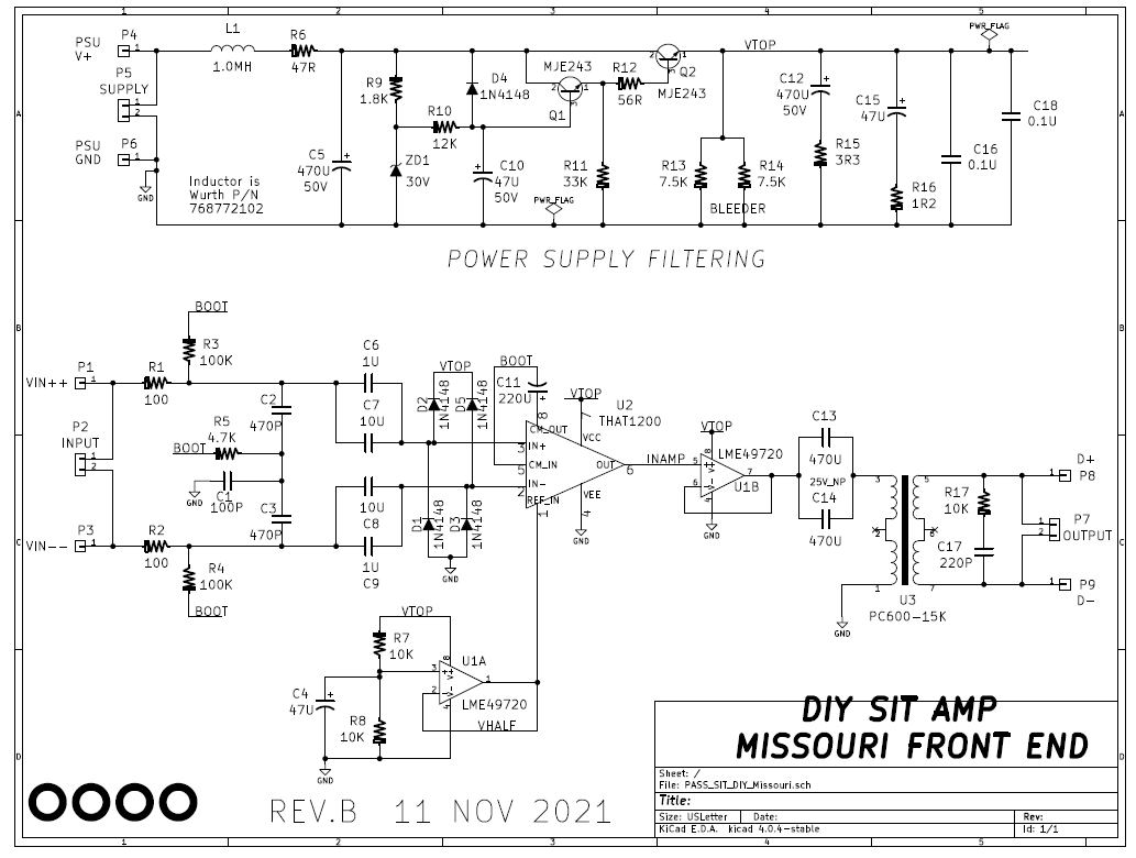

Missouri is a Front End that accepts balanced inputs. It uses the highly regarded THAT-1200 differential receiver IC for maximum CMRR

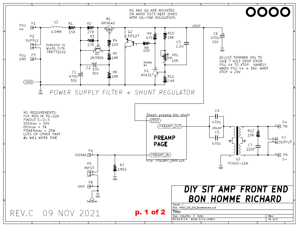

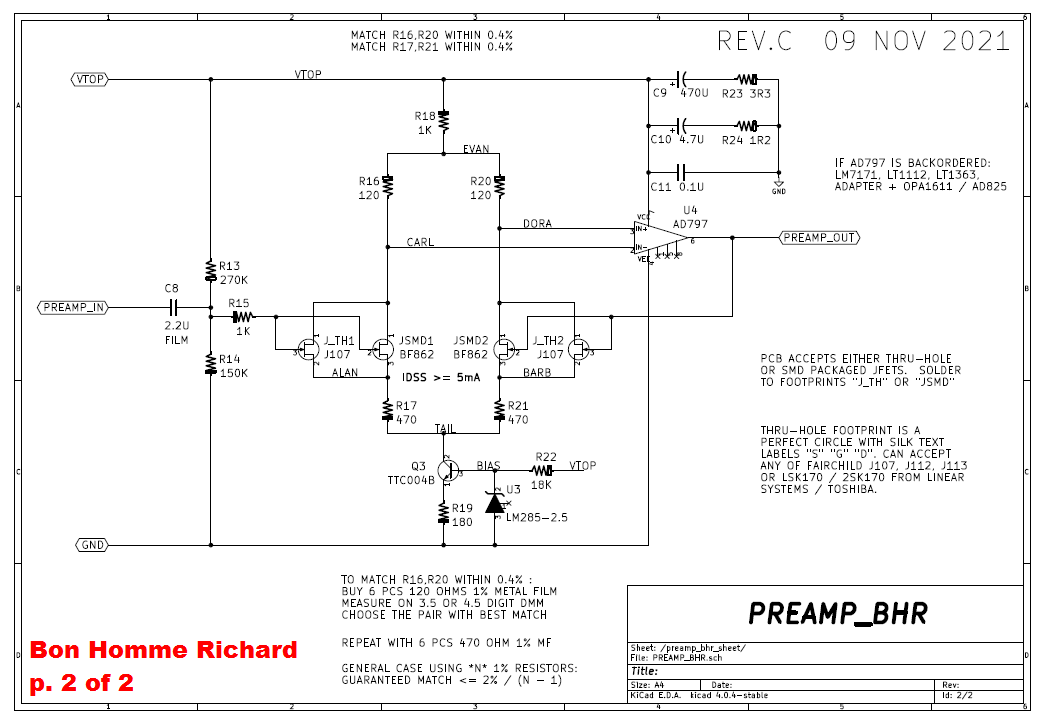

Bon Homme Richard is a high performance opamp (AD797), plus a discrete JFET input stage, fed by a shunt-mode voltage regulator for maximum PSRR

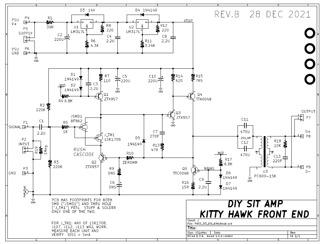

Kitty Hawk is a transconductance (current output) amplifier, which uses a Rush Cascode input stage: PNP follower + NJFET common gate.

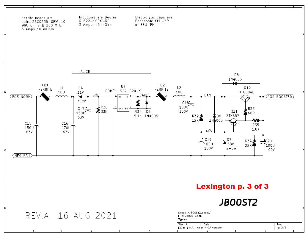

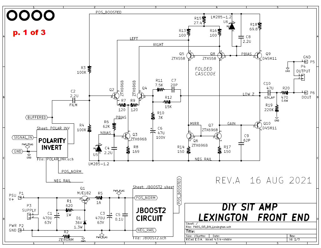

Lexington is a folded cascode discrete opamp, using a self-generated high voltage supply (“JBOOST2”) and no Edcor transformer. The boost circuit includes an isolated DC-to-DC converter module plus extensive filtering.

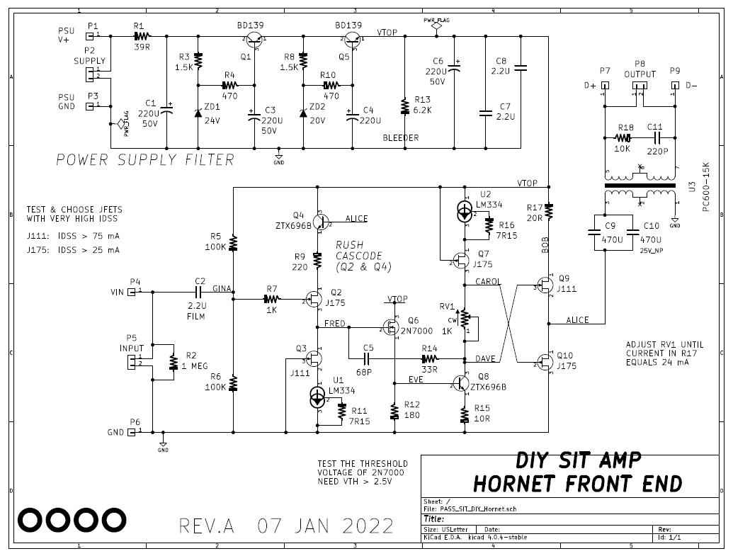

Hornet is a discrete opamp whose unusual all-JFET output stage has no degeneration resistors. The supply filter is cascoded, each of the two constant current sources are cascoded, and the input is a Rush Cascode.

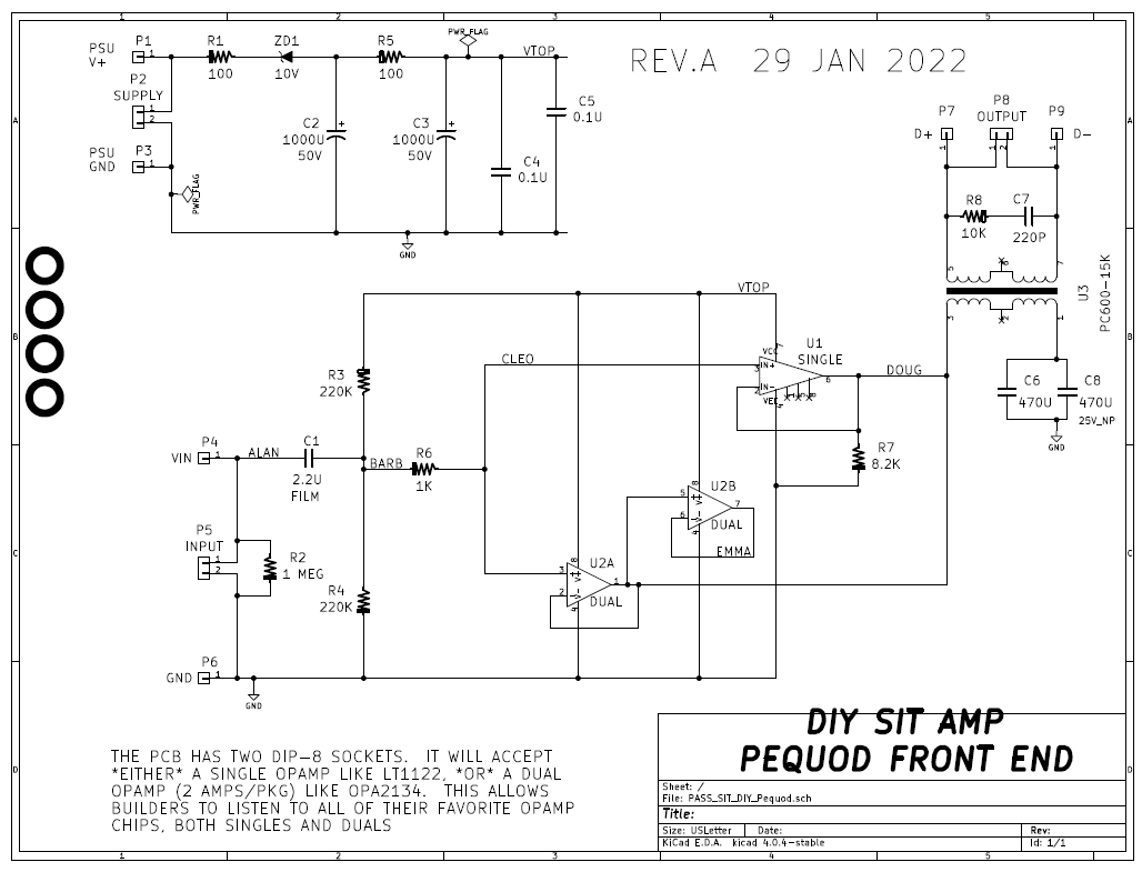

Pequod is a simple opamp follower with few parts and relatively modest parts cost. It accepts either dual opamps (e.g. LM4562) or single opamps (e.g. LT1122) and the two opamp sockets are surrounded by blank empty zones, making it easier to fit discrete opamp modules such as Sparkos or Burson, if desired.

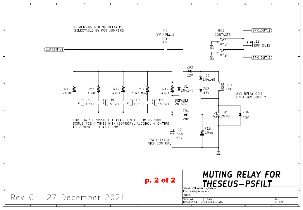

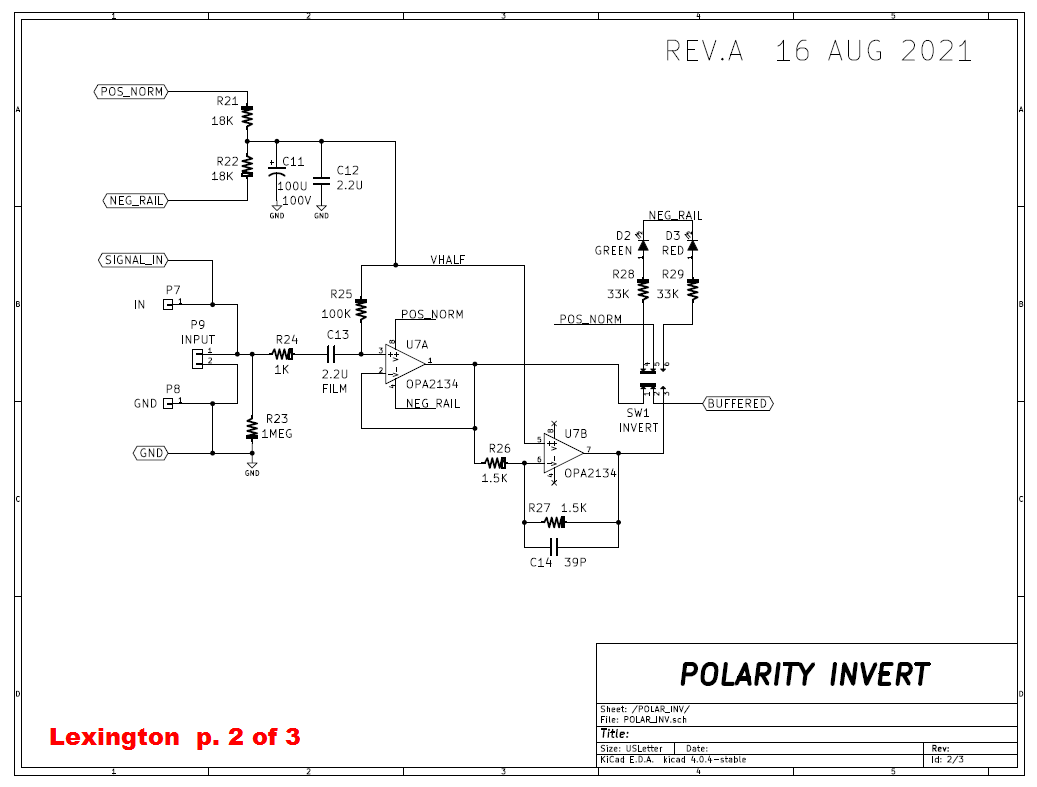

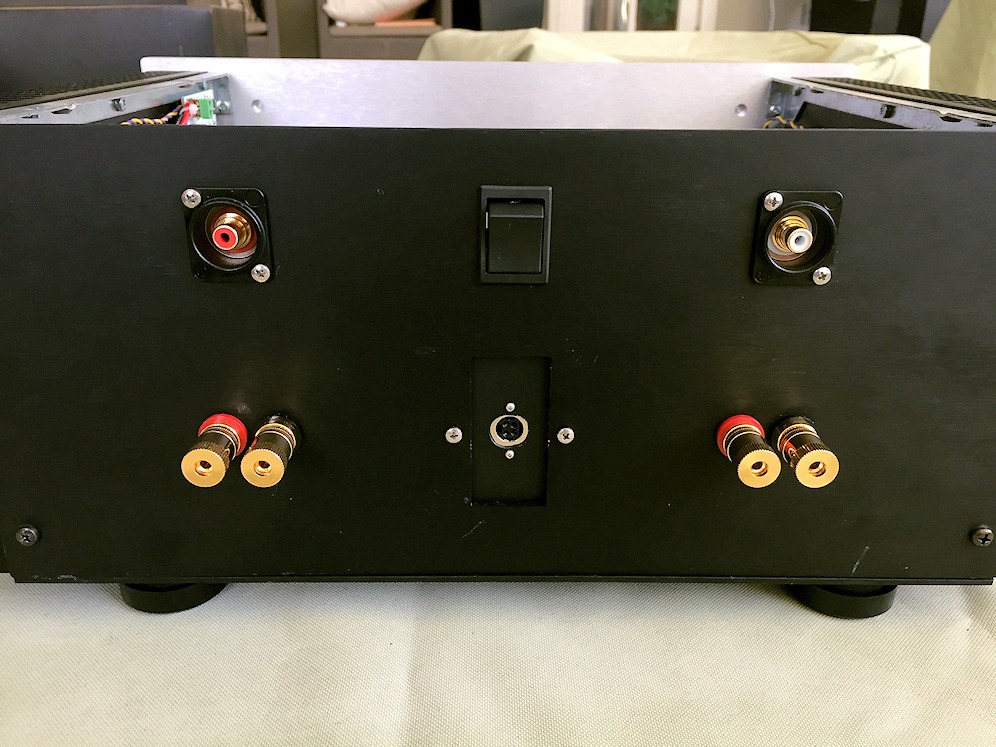

The rest of the schematics. And also a photo of the rear panel, showing the Neutrik RCA jacks used. These can be swapped out and replaced by XLRs in the same panel cutout, for use with Balanced inputs / Missouri.

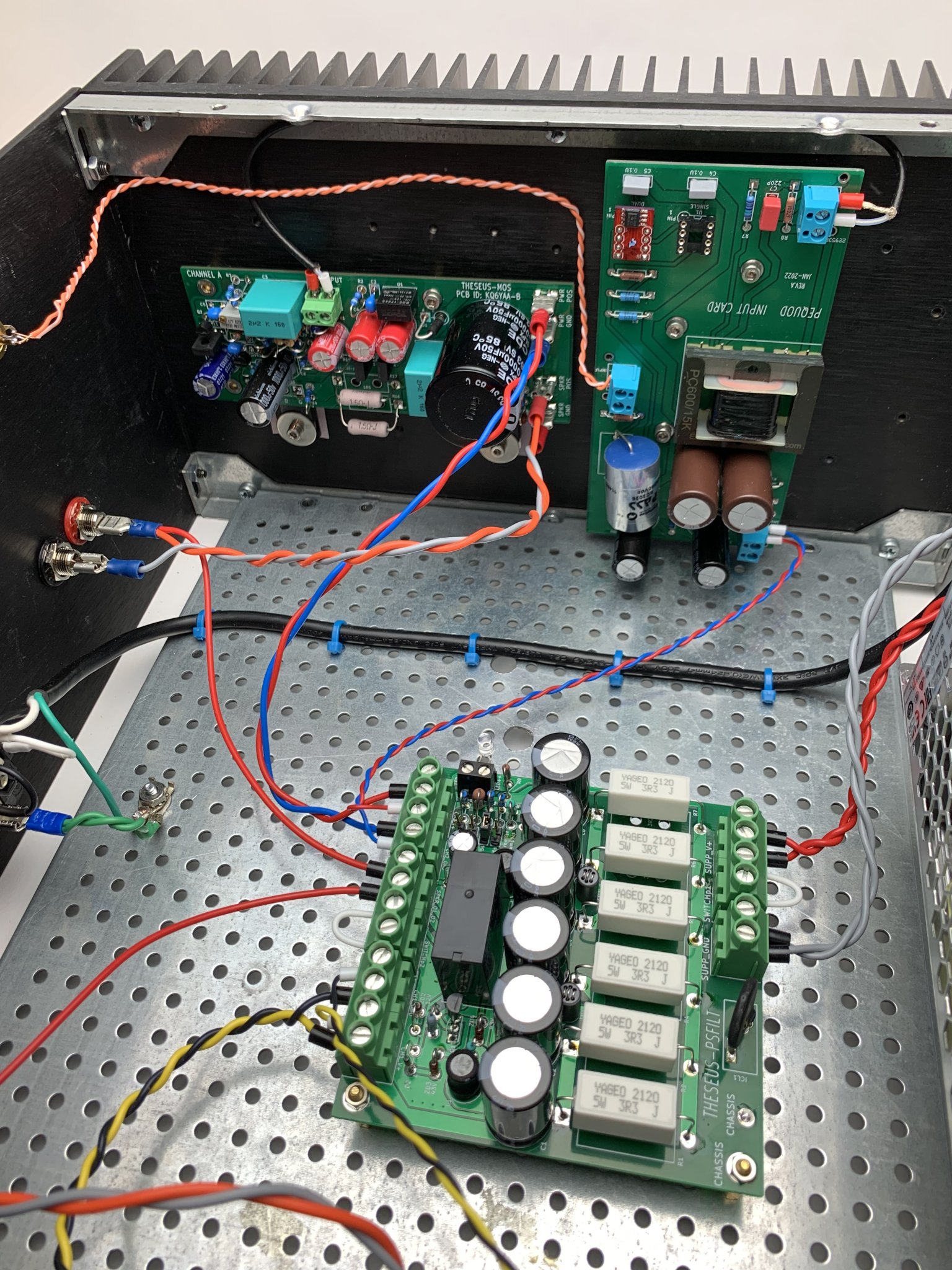

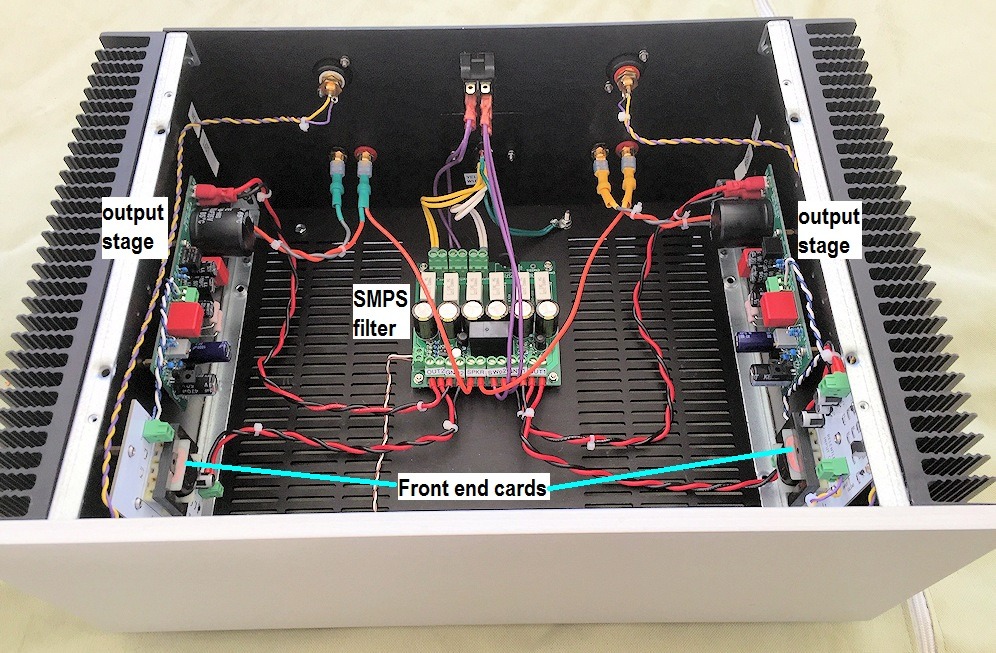

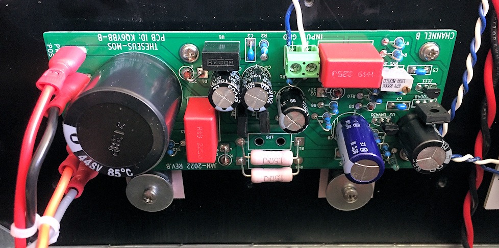

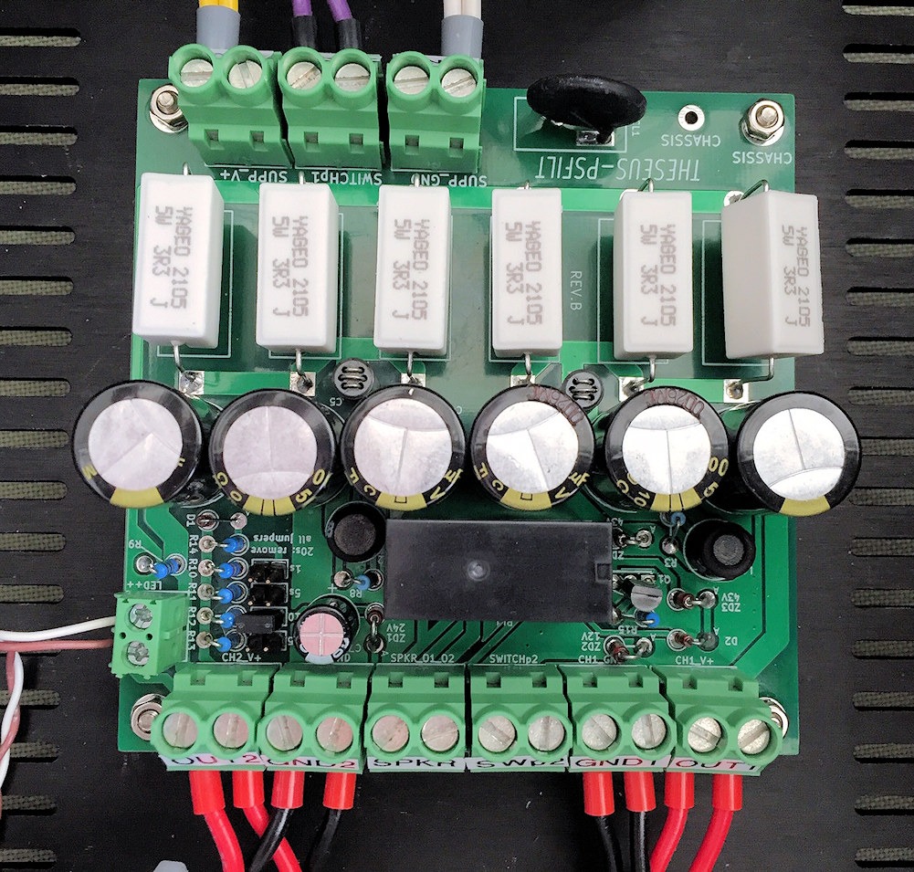

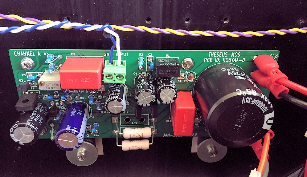

And here's the first configuration I got to play with - Theseus-MOS output, Pequod input, an open-frame MeanWell into Theseus-PSFILT PSU module. It sounds absolutely excellent!
![yes :yes: :yes:](https://files.diyaudio.com/forums/images/smilies/yes.gif)
EDIT:
At least one!!Need to order another chassis.![]()
There are lots of smaller profile chassis that could work with this assuming it has suitable heatsink area. You could power with a brick or with a metal-frame PSU inside the chassis. The possibilities are endless.
Hi Mark,
Wow, what a gift to this community. Thank you. The possibilities really have my head spinning.

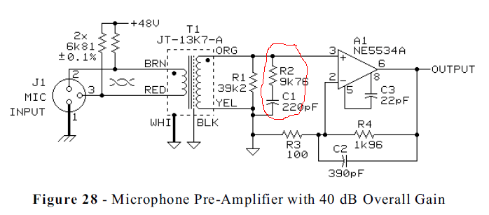

I have a question about the circuitry surrounding the Edcor transformer. (This is a parenthetical as I recently implemented a pair of 1:2 Edcor's between my preamp and amp as an experiment). It looks like in nearly every case there is a pair of parallel capacitors on the primary (to block DC?) and what looks like a snubber circuit on the secondary. Is this what those are? Could you point me to a reference to help me better understand the design and application of DC blocking and snubbers on line-level transformers? I have a Quasimodo board on the way so if that's what was used here, that would be helpful to know.
The capacitors on the primary are, as you surmise, to block DC from the transformer. Remember that these amplifiers (the Vfet variations, if you will) are single-rail, and in order to make AC on the output (because music is AC) you need to have the ability for the amplifier circuit to raise and lower the voltage in DC to make the signal.
To this end, the amplifier has to live somewhere at about 1/2 the DC rail voltage at idle, so it can modulate the PSU both up and down (the peaks and valleys of the waves) and make AC. So the amplifier will be making around 18VDC at the output with zero signal. The coupling cap(s) block this DC from the output.
As for the snubber on the secondary, (something Nelson figured out with the Edcor used in this project) that’s mostly to help properly load the primary, and to tame a resonance in the transformer itself. This will vary amongst transformer design. Mark may be able to better explain than I.

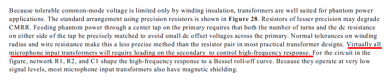

The Zobel network across the transformer secondary, damps out a resonant peak in the transformer's frequency response. Nelson Pass said so (here) and I'll see if I can find where Bill Whitlock says the same thing about Jensen transformers.
There it is, in Bill's chapter "Audio Transformers" of the book Handbook For Sound Engineers, edited by Glen M. Ballou

Thanks 6L6! I'm guessing both the input and output amplification stages inject DC into the AC audio signal, hence the need to avoid transformer core saturation from the input stage DC here.To this end, the amplifier has to live somewhere at about 1/2 the DC rail voltage at idle, so it can modulate the PSU both up and down (the peaks and valleys of the waves) and make AC. So the amplifier will be making around 18VDC at the output with zero signal. The coupling cap(s) block this DC from the output.
Thanks Mark! I didn't know that was also called a Zobel network. Bob Cordell's "Designing Audio Power Amplifiers", of which I have a copy, seems to discuss them in multiple places. That will get me started.The Zobel network across the transformer secondary, damps out a resonant peak in the transformer's frequency response. Nelson Pass said so (here) and I'll see if I can find where Bill Whitlock says the same thing about Jensen transformers.

I had done a quick 'reflected impedance' calculation for the 10k resistor alone and I got a value of 6.25Mohm on the primary, which wasn't making sense to me.
All of the above by Mark and 6L6 is correct.
The thing to look at is the value of the AC coupling caps (C11 and C12). 1000 uF is much larger than required to achieve full bandwidth into the output stage. It is certainly Ok to use that value, but a single 220 uF Elna Silmic + 0.47 uF Polypropylene film is worth listening to.
Or even a 100 uF Nichicon ES series + 1.0 uF Polycarbonate if you can get one. Lots of options are fun.
I‘ve tried these combos and prefer them to more generic bipolar caps.
