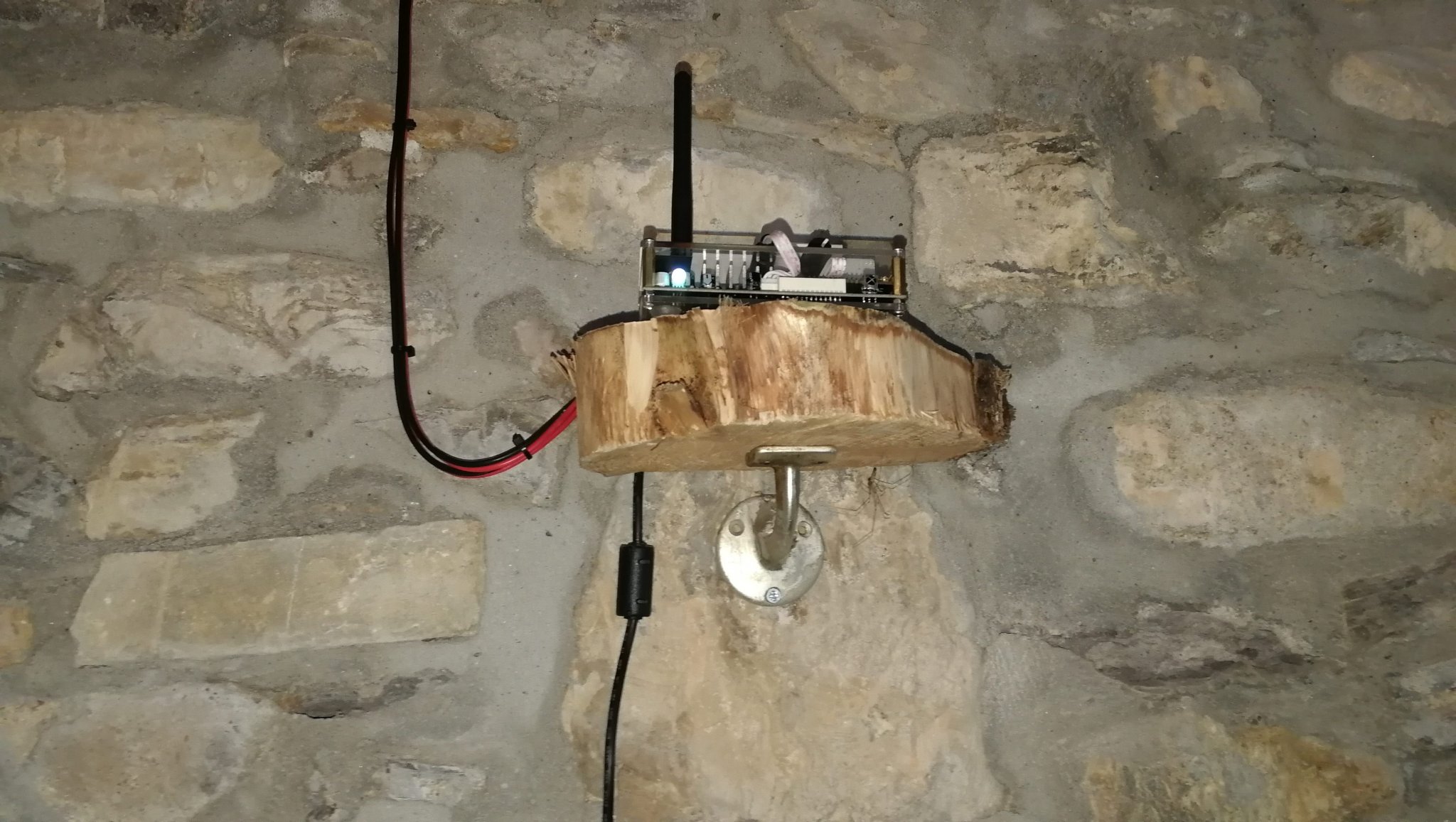

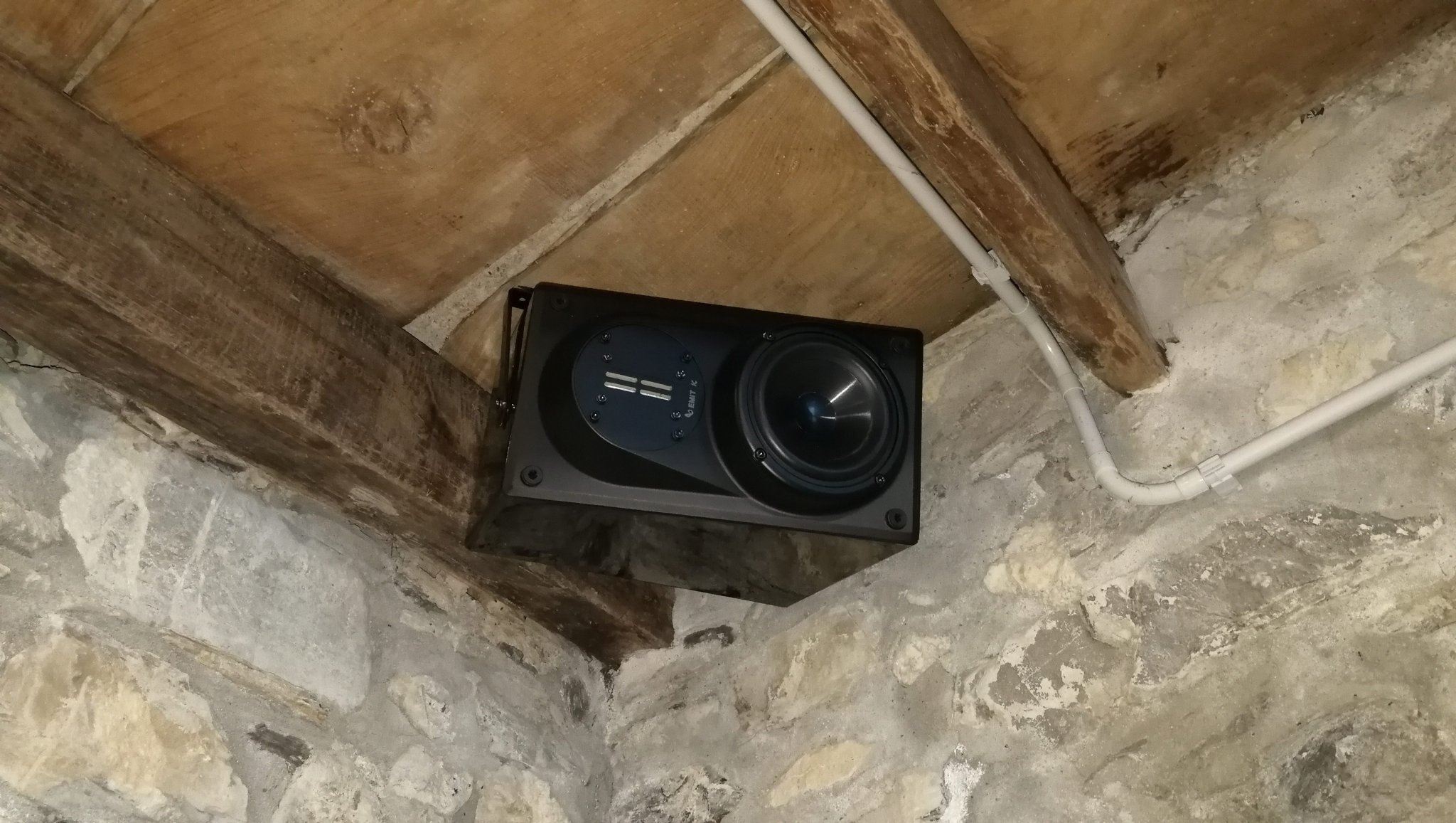

Kitchen
A simple but nice sounding setup. The Up2Stream Amp (V3 I guess) is driving a pair of Infinity Modulus speakers mounted in the upper corners of the room. The setup of the amplifier itself is stock, I did not changed anything with the APC-Workbench software. The Up2Stream board is enclosed in the a Arylic case. Before this board was at a different place. That is why it has a volume knop and a 3.5 mm input in a hight nobody can reach.

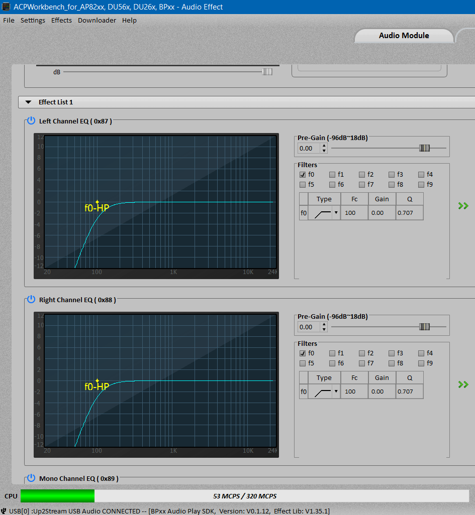

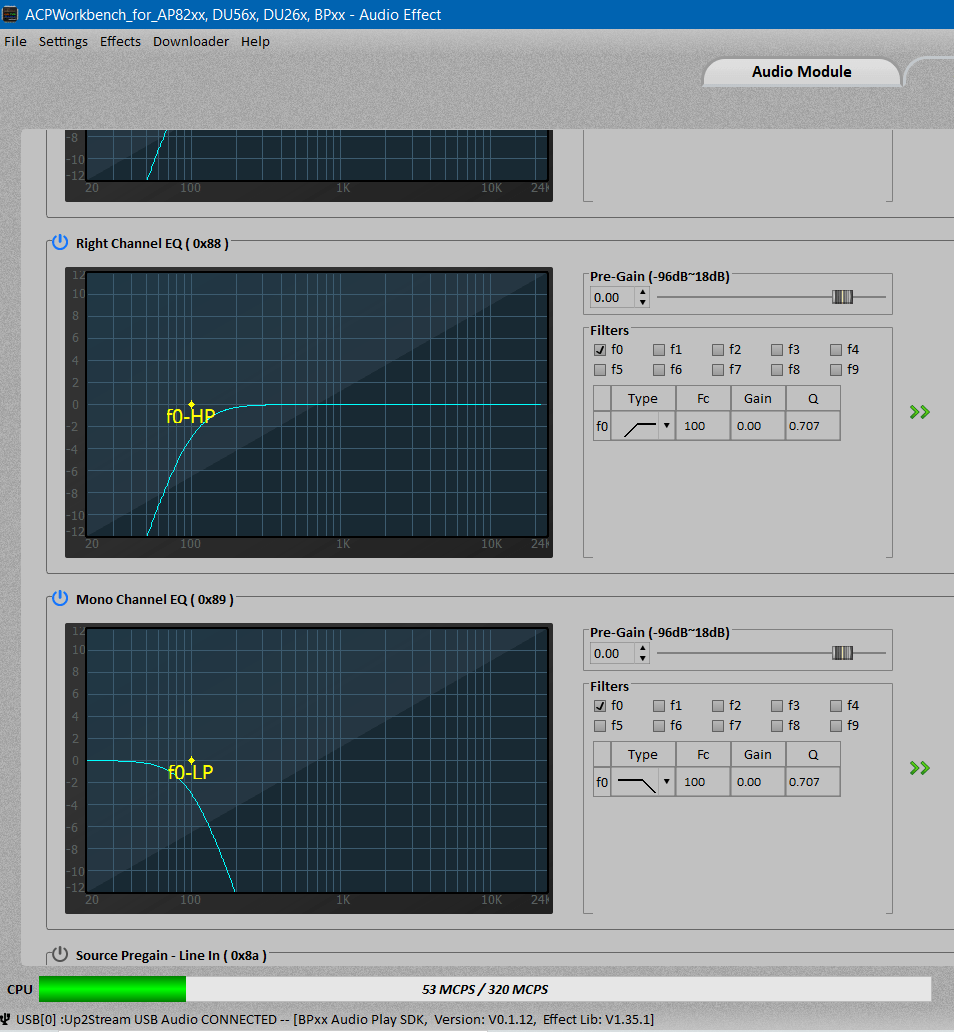

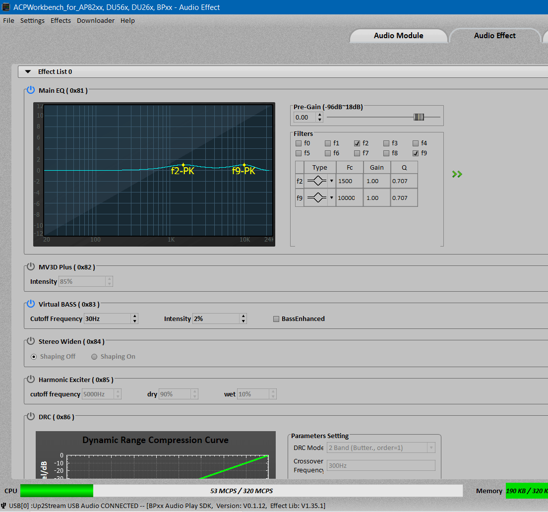

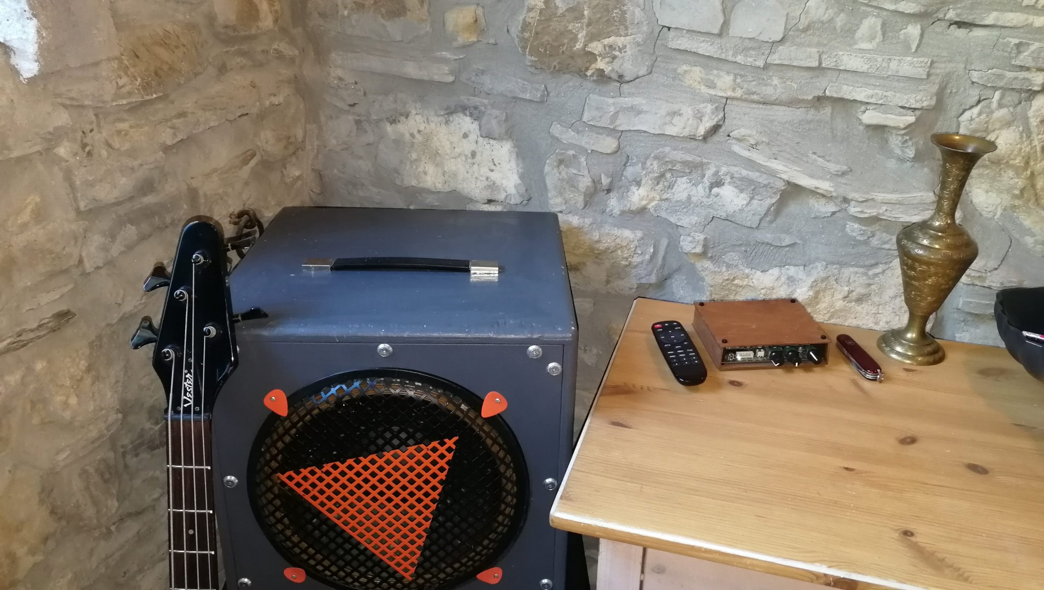

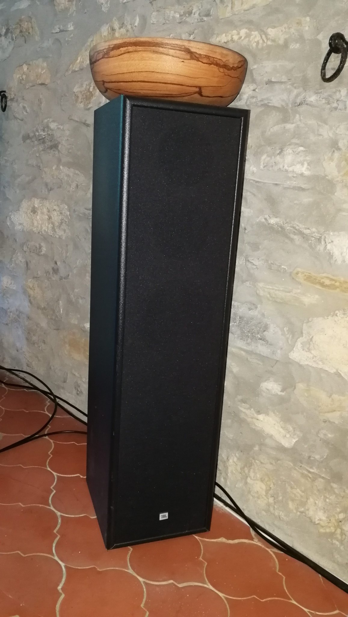

Living room
The Arylic Up2Stream Amp 2.1 is enclosed by a low end wooden case with plastic studs I did. A friend of mine sold a pair of JBL TLX 320 floor standing speakers for a good price to me. The are not high end but ok sounding to me. In this 2.1 setup they go up 100 Hz. Some EQ-ing I did to make them better to my ears. The bass comes from a closed subwoofer with a 12 inch hard suspended bass driver (Monacor SP-12/200PA). The subwoofer does 100 Hz and below. All in all the sound of the system is huge, clear, loud enough and goes deep. If I like to practice bass guitar I plug the subwoofer over to may bass amp and jam along the JBL's without the bass support.
