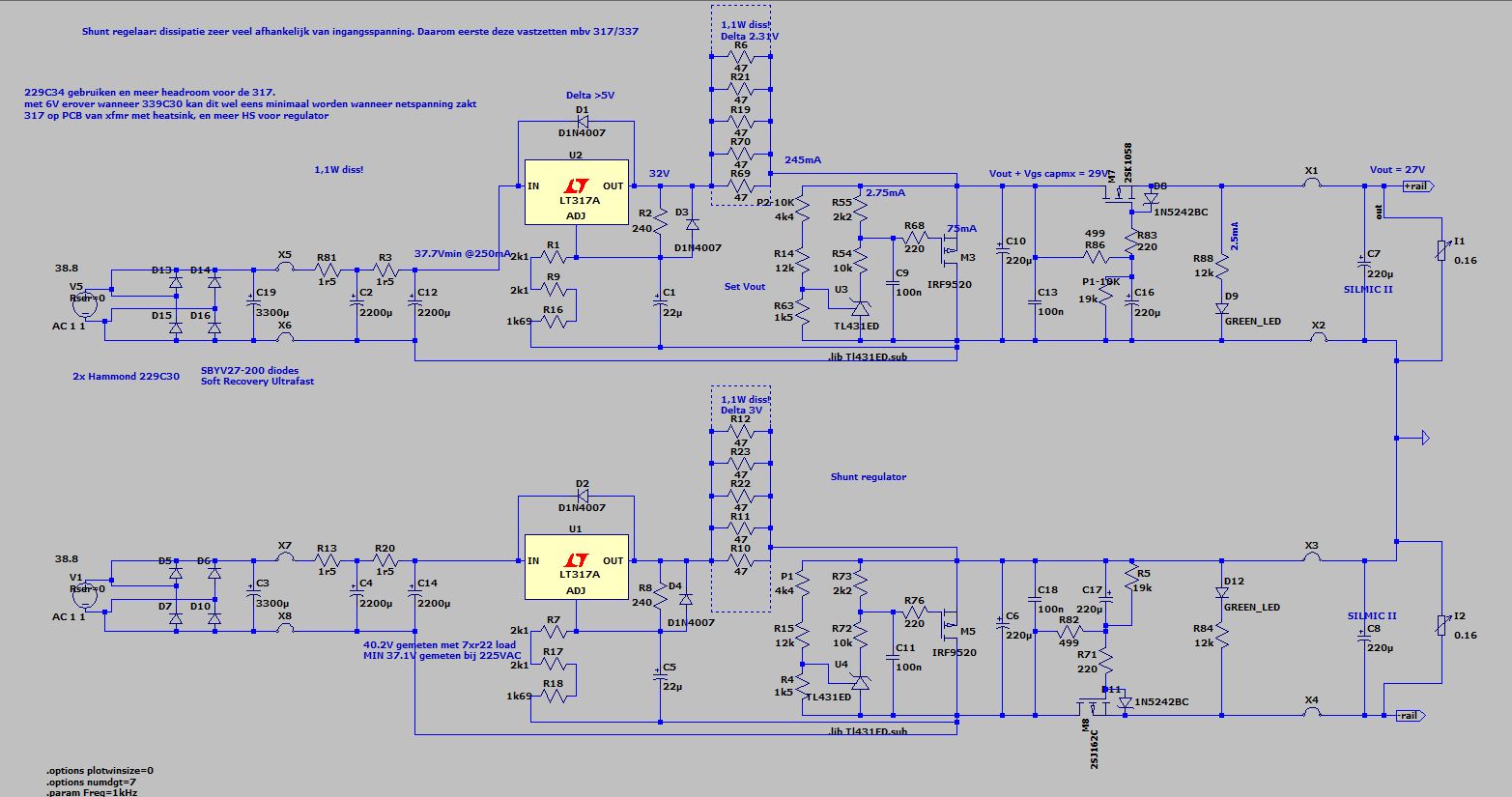

I'm currently using shunt regulators (in combination with serie regulators) as PSU for my preamp. As the dissipation is too high for me to feel comfortable I was wondering to maybe leave this out. According to LTspice, it has no added value in suppresion below 1Khz.
Shunt current is 75ma, load current is 160mA (with max ripple of 2mA).
As I have 4 of these shunt regulators, it saves me more than 8W on dissipation.
What is a good rule of thump of the factor between shunt and load current, to have decent added value of the shunt regulator?

Easy. Leave it out. Shunt regs can be fine for low current applications but become extremely inefficient and provide no benefit over a straight linear solution at more than a few tens of mA or so.
Recommendation from the Salas's UltraBiB shunt regulator build guide is that shunt should drain minimum 50 -100 mA over peak output current.

I just dissabled the function of the shunt (opening the 4k4 resistor, see schematic), result: soundwise I don't seam to notice difference. Noise wise: with my ear to the woofer, I hear a hiss which was not there when the shunt regulator was active.Easy. Leave it out. Shunt regs can be fine for low current applications but become extremely inefficient and provide no benefit over a straight linear solution at more than a few tens of mA or so.

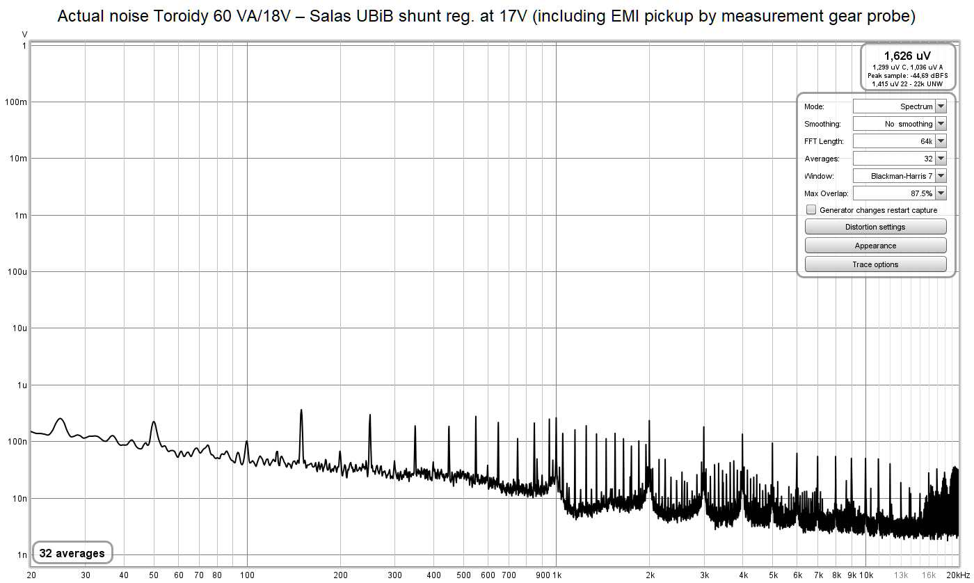

Few unfortunate component choices undermined final result. I don’t know if transformers are salvageable, but for a replacement I can recommend Toroidy audio grade. They are absolutely noiseless and have excellent performance. I notice that you have put great care to suppress any HF junk noise coming from the mains (transformers choice + 3 stage voltage regulators). Toridy audio grade have electrostatic screen between primary and secondary windings that shunts HF noise to the ground. Two 60 VA transformers with dual 30 V secondaries would be fine. As an example, here is PS noise measurement from my preamplifier which has Toroidy 60 VA transformers and Salas’ UBiB shunt regulators. All HF noise is at nV levels and visible peaks are from laptop internal switching PS circuits and from the USB. Checking up to 96 kHz, there is nothing above 100 nV level.
