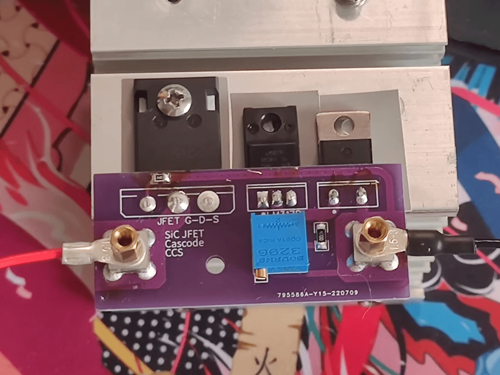

Looking through a lot of relatively new circuit designs of valve amplifiers, the Constant Current Source takes almost all the leading position. Except those used in Filament CCS, almost all other designs are Cascode ones.
For example like this, the M3 and J1-J4 formed a Cascode CCS.
If we set it at 10mA and using DN2540 at M3, the FET at J1-J4 position could only get a Vds even below 1.5Volts, which can't drive the FETs into saturation area.
If the lower side FET can't go into saturation area, how could it deliver a constant current?
These new SiC JFETs entirely eliminated such problem. The Vgsoff of these transistors is typically -9Volts, which means you'll have over 8Volts for the lower side.
I could say these SiC JFETs fully "liberate" the lower side conponents, providing a better working condition(Over 8.7Volts for 25mA) comparing with traditional Depletion MOSFETs such as DN2540(lower than 1Volts for 25mA) and IXCP10M90S(About 2.4Volts for 25mA). Even LM317 could be used here for a higher current accuracy.
I've bought some samples of the 650V 80mΩ version, and give it to my friend replacing DN2540 in the Mu Follower design. Now his only remainging question is what to use at the lower side😀.
The problems of the SiC JFETs are also clear.
The capacitance is the biggest one. The Rdson=80mΩ version has a Crss of 88pF, while the Crss of Rdson=400mΩ version is 18pF. It's much higher comparing with DN2540.
Maybe packaging the UJ3N1701K2 is the ultimate solution 😵

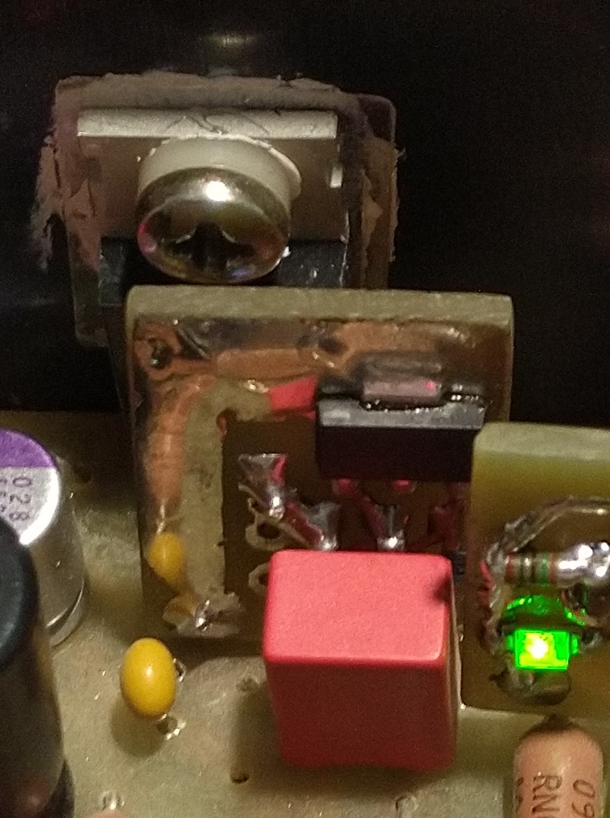

KoitoYuu ,you can make a good current source with two depletion mosfets, but if you choose them according to Vgs(th) or insert a bias multiplier that will raise the Vds of the lower mosfet.
No need for jfets, SiC or the LM317 which has high noise.

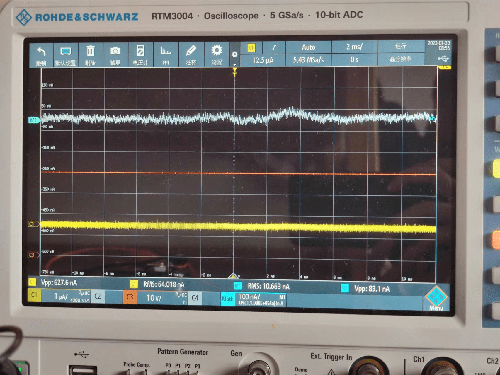

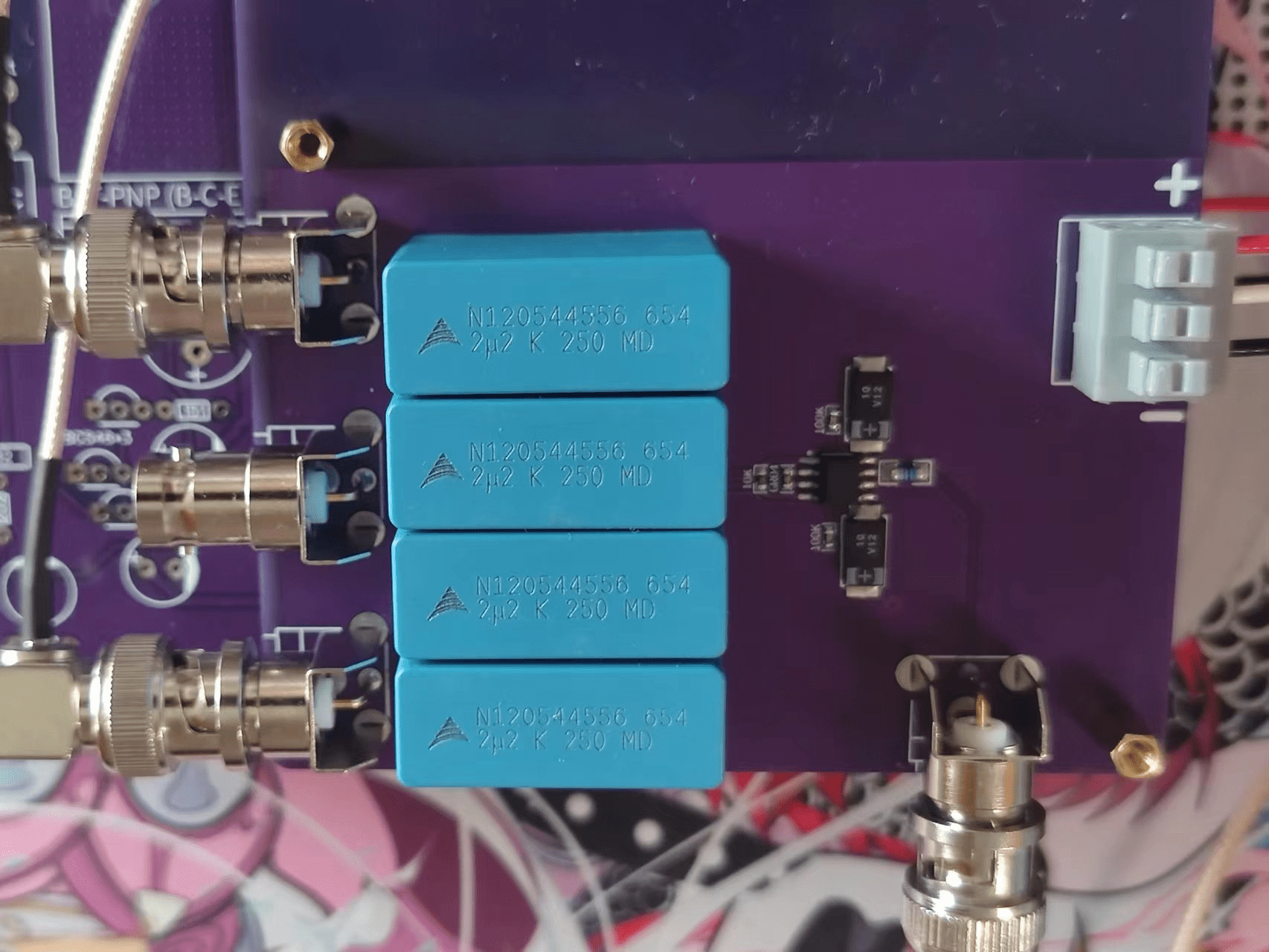

I've just tested the LM317 version that I'll use in 300B SE AMP for Constant Current Self Bias.
The current noise of the module is below 100nArms (about 2MHz bandwidth), and even lower than 15nArms if adding 100KHz LP. It'll generate little noise on the cathode capacitor.
Testing conditions: 4ohms shunt resistor, INA849 with 6S1P lithium battery supply and 1000V/V amplification factor. These components formed a 4000V/A current sensing probe.
I have no idea about the noise when using JFETs here, but I think 100nArms is fully acceptable even in a DHT preamplifier.
The bias multiplier does not need a negative voltage, only two additional resistors and a film capacitor .Bias Multiplyer? You mean using external supplies raising the Vgs like a battery? But that means adding a lot of components here. Just like the Universal Mu Follower I posted. All components on the left side were added just for using the lower side enhancement MOSFET like a Depletion FET. And also such designs will let the gate have a much longer path to ground, together with a higher and more unstable impedance.

LM317 has almost 50 times more noise than DN2540, which may not be heard in the cathode, but is unusable in the anode , some other place where low noise is required or high voltage drop , so we can hardly say that LM317 is a universal solution. Two DN2540 in a cascade with a bias multiplier are certainly a better solution than a cascade with LM317. Even one DN2540 is better than a cascade with LM317 .The first time I used the LM317 in cascade in the anode (40x gain) was also the last time because the noise was audible, more than 10 years have passed since then and I have not soldered a single LM317 since then.

And by the way, I'm suspecting about the data listed in WaltJung's measuring, since I only measured a current noise of below 15nArms with bandwidth limit from 10Hz to 100KHz, while he said there's more than 1nA/√Hz from 10Hz to 10KHz. Maybe LM317s are much better today? Or, due to the Vgsth of the upper MOSFET, he operated LM317s too close to minimum voltage drop? I'm using the LM317P from ST, whose design is friendly for insulation.

I looked a bit at what depletion mosfets are available at Mouser and I'm sure that a current source can be made for 1A as well. Maybe even without a bias multiplier if the mosfets are chosen well.
An example is this CCS (without bias multiplier) for 300mA that I made two weeks ago for a regulator in my DAC . The next goal is over 500mA for a new update in the DAC.
