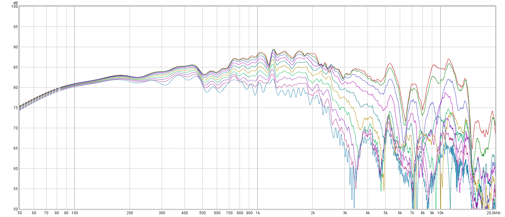

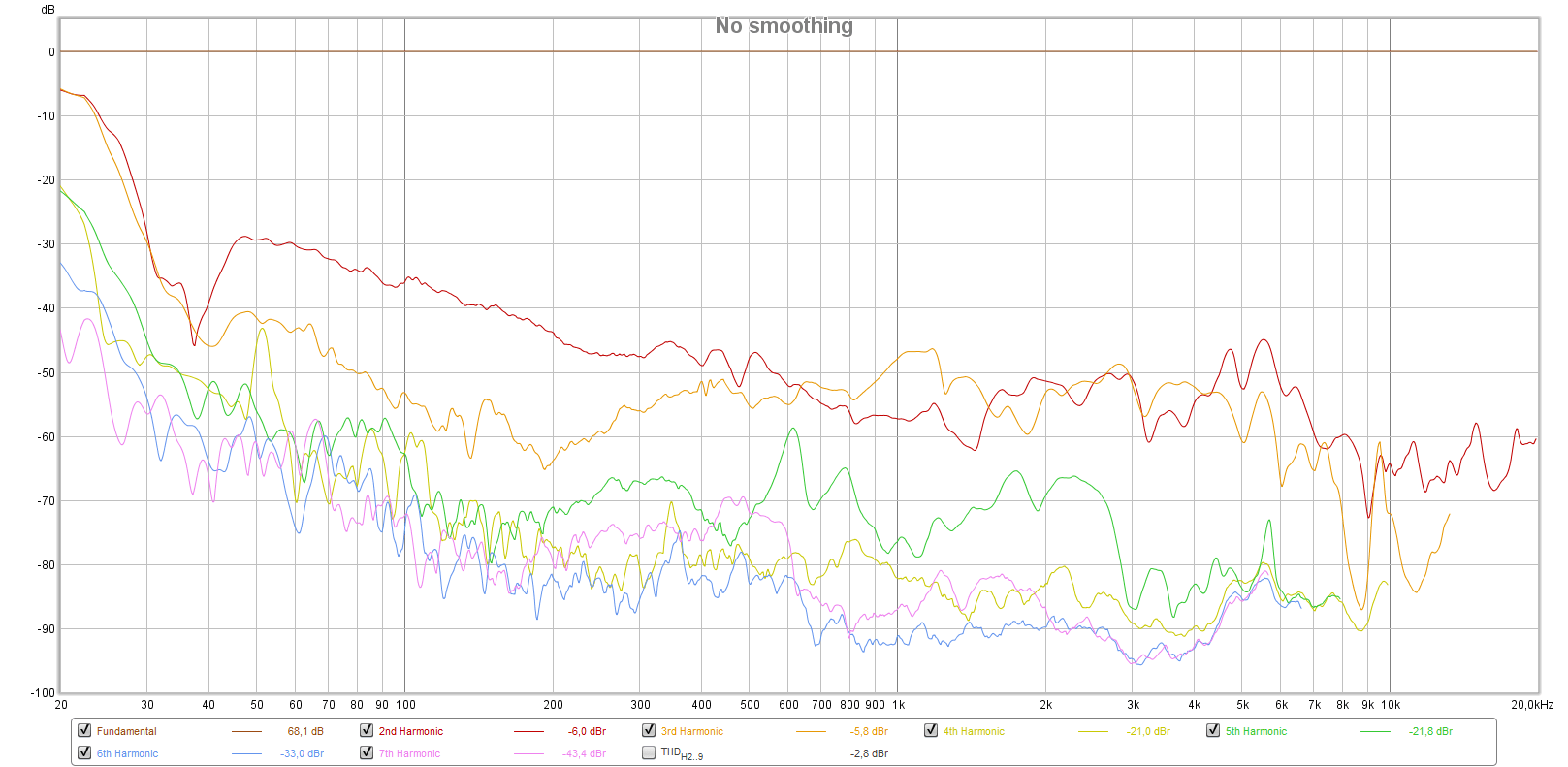

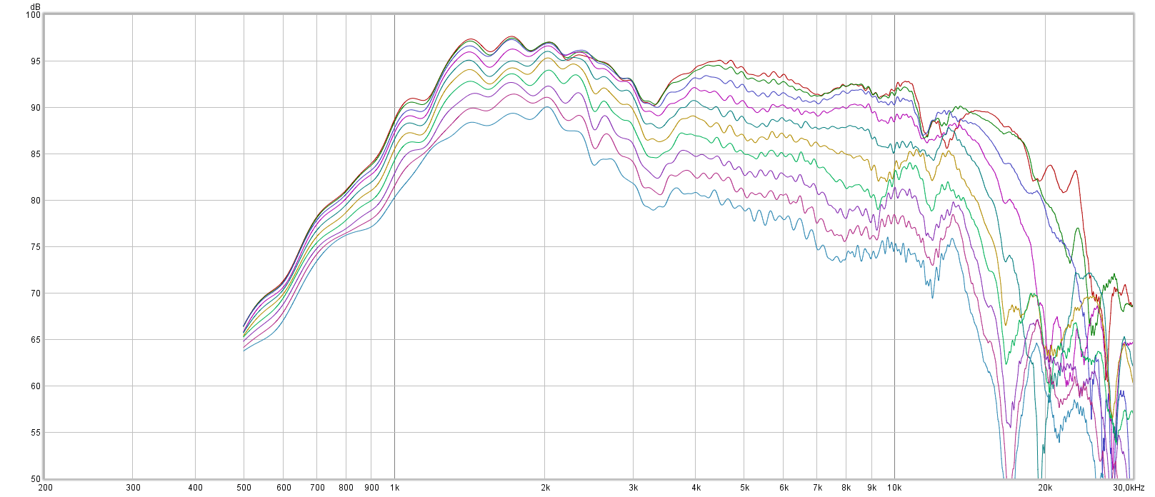

Measurements were done in small enclosures with R28 front baffle edges, mic distance 1m for FR and 30cm for distortion, gating 10ms, SPL calibrated, measurement voltage 2.82V, microphone Earthworks M30.
5" coax assessment:
I am also glad they use paper cones with some kind of coating, which means less severe breakups and generally better sound then alu cones (I am not a fan of KEF sound at all, though I admit Meta versions might be step in the right direction to better sound)
Crossover design for both was not easy due to 3kHz tweeter response dips. Standard two way 6" + WG is much easier. Acoustic LR4 at 2000-2500Hz is mandatory due to a) tweeter: rising distortion <2kHz, b) better directivity match, c) uneven response of midwoofer >2.5kHz.

- 3kHz dip in tweeter response is trouble and not nice to look at. It makes crossover design quite challenging. Off axis responses are consistent so the issue is correctable with active crossovers.
- distortion performance is good for basic drivers and does not suggest any big issues
- tweeter top end response is not perfect, though is much better then what we usually see from other coaxes
- we had side by side comparison with KEF LS50, LS50 measurements showed elevated 3-kHz area if I recall well. Sica sounded better in all aspects.
- 3kHz dip again. Off axis responses are consistent so the issue is correctable with active crossovers.

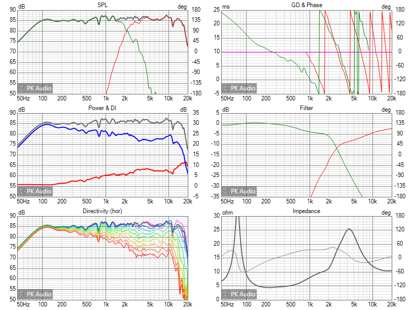

- I attached also Vituix 6pack for completed 2way passive loudspeaker, this version sounds very good, has reasonable low end extension and overall listening impression and feedback was there was something really right and good in the sound
- small wrinkle at 800Hz is front port interference

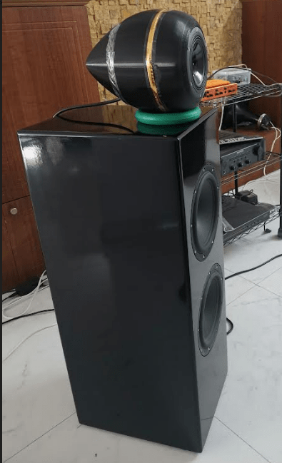

I have been playing around with the 5inch coax in a tear drop shaped experimental enclosure along with Satori WO24P woofers in 3way. Those adventures and related measurements are given around this page:
https://www.diyaudio.com/community/threads/a-3-way-design-study.376620/post-7115048
My recent ongoing 3way project with thile 5inch coax in an open cardioid enclosure is also given at the end of the above thread

I noticed I did not attach correct sixpack for 6" coax 2way T2, so here it is, Sensitivity matches the individual measurement of the midwoofer. This is final version, proven by longterm listening.

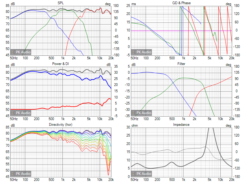

I also attached T3 sixpack, this is standmount 3way with 5" coax and 6" Sica woofer 6.5H 1.5C
