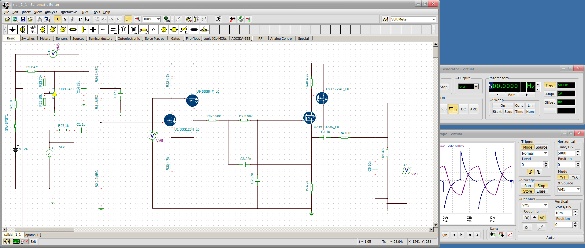

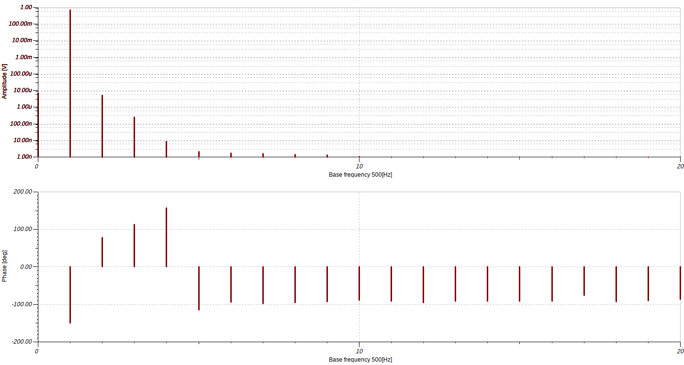

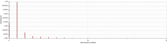

In this thread I'm documenting my development of an active filter for a 2-way design.
Purpose:
High-pass & low-pass filters at around 500Hz, for a 10" woofer + 3.5" wide-range.
The filters will be 2nd order (Sallen Key, unity gain), and that can modified by adding more stages.
By modifying component values it should be pretty easy to reconfigure for different cut-off frequencies and different Q, and the same basic layout can be used for high-pass, low-pass and notch versions.
Additionally, I wanted to challenge myself by using discrete buffers instead of op-amps. An earlier attempt was only marginally successful: single BC850x based buffers were usable at low volume but had too much IMD. In the latest version, I've been able to significantly reduce THD, and IMD should also be much lower as well. It is also far less dependent on volume. As long as component values for filtering are within reason, it doesn't even have to be push-pull, which simplifies things a lot.

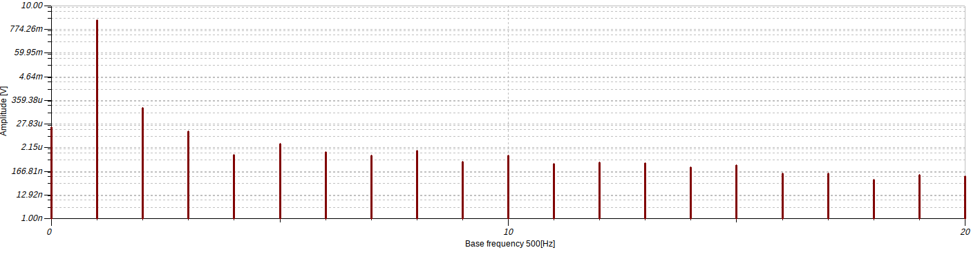

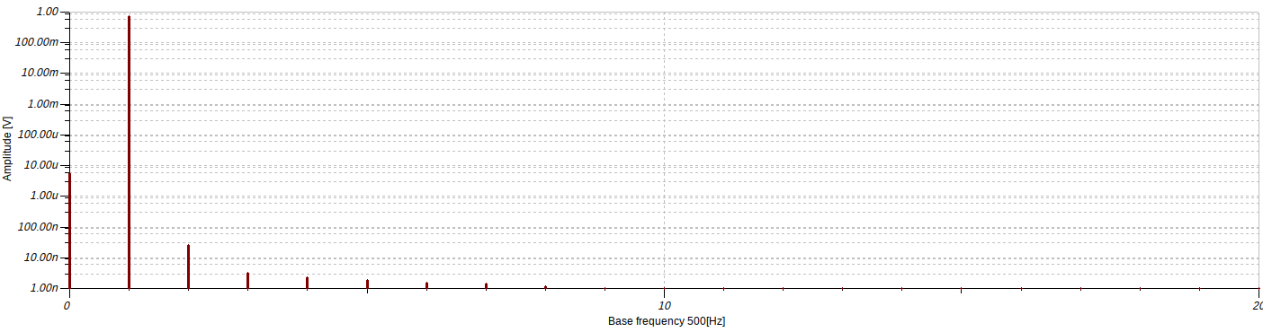

Even at ~0.0005%THD, I still haven't been able to match a NE5534 version that I simulated for comparison. However, noise performance is about 6dB better.
By using N and P MOSFETs configured as Sziklai pairs, simulated THD measures around 0.000x% @ 1V at a few different frequencies from 100Hz to 2kHz that I've tested, for both HP and LP versions.
The circuit is not optimised yet, and doesn't include any pre-amp section or volume control. The previous prototype used a dual-gang pot for volume, but ultimately I'd prefer a switched resistor topology. The order of the stages: gain, filtering, volume, is TBD.
I'll have to measure the speakers again to see if they need anything different like a Linkwitz Transform, shelving filters or notches.

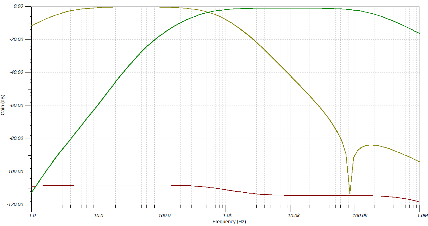

Filter Q:
I'm keeping the slopes gradual at the moment, avoiding excessive overshoot and ringing. I suppose that even if it's hard to see on a linear scale, logarithmic ears may be sensitive to it.
Overlap and gain and phase at XO point:
TBD.
I've manually played around with the exact slopes to get something "looks" right on a virtual oscilloscope, but I'm not sure what the combined response will look like in the real world just yet. The speakers are in separate boxes so the geometry is not fixed. This is another reason why I'm careful to avoid ringing: there is no guarantee that it will cancel out, so each speaker has to have smooth output, independent of any 'corrections' from the other speaker.

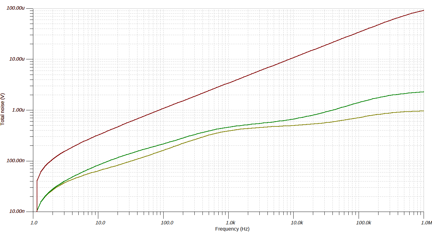

Total output noise is about 500nV @ 20kHz for the low pass version, and 800nV @ 20kHz for the high pass. However, that is likely to get swamped by power supply noise for the version shown.

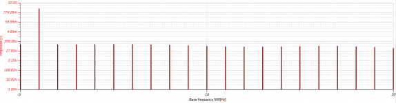

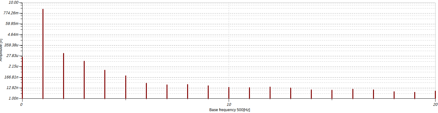

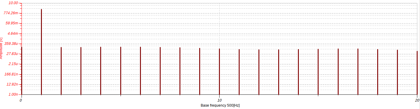

I may have spoken too soon about the source follower not 'matching' an NE5534 -- the op-amp is miles better at a 1V input signal. But at 3V the distortion products have skyrocketed, producing a flat harmonic series around 150uV.
It almost looks like some kind of clipping. There seems to be a certain threshold where a small change in signal amplitude produces a disproportionately huge jump in higher harmonics.
3V might be a bit high for my needs, except maybe for extreme peaks, but I'm keeping in mind for the volume control. (Should I attenuate ahead of the filters, for lower distortion but higher noise, or the other way around? Or may have two volume controls...? )

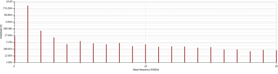

I've started looking at a J113 cascode. The perfectly matched devices in the simulation have strong cancellation of even harmonics. Detuning the resistor values brings them back. At 3V it's in 2nd place.

Why not use current sources for biasing? The resistors you use now (R22, R40, R5, R30) will reduce loop gain, among other things.
500nV in 20kHz bandwidth corresponds to about 3.5nV/rtHz in noise density which is pretty impressive for a MOSFET. Did you measure the 500nV or sim it?
Given R27, the 1k input resistor, contributes a minimum of 4nV/√Hz, and there are other larger values in the filter part of the circuit this clearly this is completely bogus! Perhaps 500nV/√Hz though? Ie 70µV rms500nV in 20kHz bandwidth corresponds to about 3.5nV/rtHz in noise density which is pretty impressive for a MOSFET. Did you measure the 500nV or sim it?
The fn of the low pass filter is 935.56 Hz, so 500 nV would correspond to roughly 16.35 nV/√Hz if all noise sources were in front of the filter stage (neglecting the difference between noise bandwidth and fn). The last voltage follower is not, though, so the noise level is still surprisingly low.
16.35 nV/√Hz corresponds to 16127 ohm at 300.15 K, which is close to the sum of the resistances of the input resistor and the filter resistors. I would expect a noise level of this order if the voltage followers were completely noiseless.
