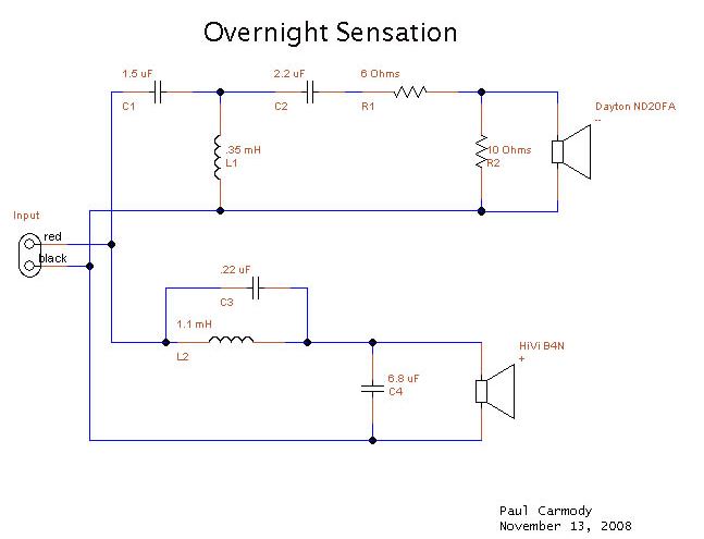

I'd like to bring back this thread, since I have a new design, and its my first crossover so I want to make sure I have this down.
2 way, 2nd order linkwitz-riley
sub
4" HIVI Bn4
8Ω 85 dB 2.83V(1W)/1M
tweet
HIVI TN25
5Ω 89 dB 1W/1M
Okay, my concerns.
I have an online lpad calculator I am familiar and comfortable using, HOWEVER, what is the actual sensitivity difference in the drivers. Since the tweeter is 5 Ω if i just hooked them up to the same power (voltage) wouldn't the tweeter technically be louder since it's a lower impedance and thus a higher current? so what I'm saying is, yes if they both have 1w of power or however those 2 numbers were measured, then I'm sure their output is 85 and 89 dB but since they're at the same source they're actually receiving different power.. how do I account for this, should i add a 3Ω resistor in series to the tweeter so it has the same seen impedance as the woofer.

Actually the opposite happens. When people substitute an original 8 Ohm tweeter by a 4 Ohm the output (SPL) goes down.

Zlyzen, it's about 6dB difference in sensitivity at heart. So many mixed measurements there that I really don't want to think about it. But the 4.6 ohm TN25 tweeter must be about 91dB converted to 2.83V/1m. 😀
HiVi TN25 Fabric Dome Tweeter 297-408
Paul Carmody's "Overnight Sensations" is set up for freestanding here by the look of it.
https://sites.google.com/site/undefinition/diy-overnightsensations
Slightly different tweeter, I know, but correct ballpark. It's not strictly an L-pad used here, but then there is the effect of the woofer bafflestep coil on reducing sensitivity too. Converting the tweeter filter to second order shouldn't affect things too much either with crossover phase staying roughly aligned with luck, but L and C values will be different.

As system7 noticed, the tweeter is measured at 1W, 1m. The woofer was measured at 2.83V because that is the 'standard' test voltage... it happens to be the voltage that produces 1W into an 8 ohm resistor.
Amplifiers are normally voltage sources. Get both of these drivers converted to voltage and you're OK to compare. As Steve says, it is likely to be 91dB/2.83V/1m. Don't go adding resistors just over this.
